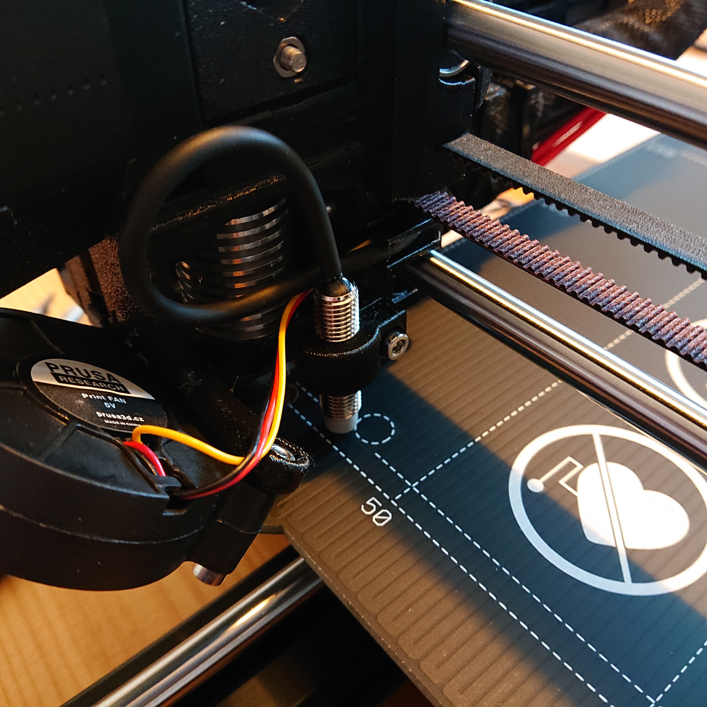

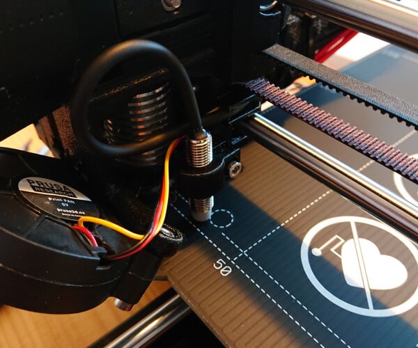

I have the same problem. Just assembled my printer, everything seems to work fine, except:
Calibration failed! Check the axes and run again.
The Pinda sensor is on the right height I think, but the X, Y, position seems off when the calibration fails, see picture.XYZ calibration failure

jacobdegrooth
(@jacobdegrooth)
RE: Calibration failed! Check the axes and run again. Z-Axis failure
Picture of the failure position.XY Position of the failure XY Position of the failure

I loaded a previous firmware and then I could print.
