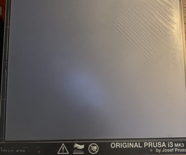

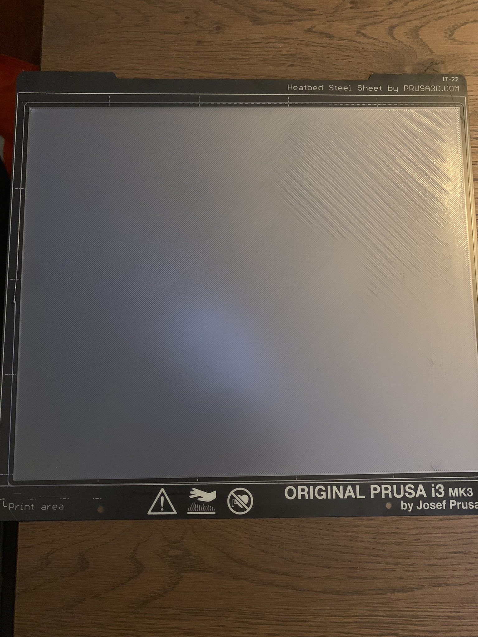

lschelvis
(@lschelvis)
RE: Again, first layer
After a few months printing very good, I wanted to print something that was bigger then what I normally print. First I ran again a small check strip to see whether my Z offset was still allright. Afterwards I printed a single layer over the whole board.
This was the result:
Is there something I can do to make a perfect first layer?
Posted : 29/08/2023 4:29 am
This is more advanced and takes a while to complete but it should help: https://help.prusa3d.com/article/bed-level-correction_2267
Posted : 29/08/2023 10:46 am
lschelvis
(@lschelvis)
Thanks, I will take a look at this!
