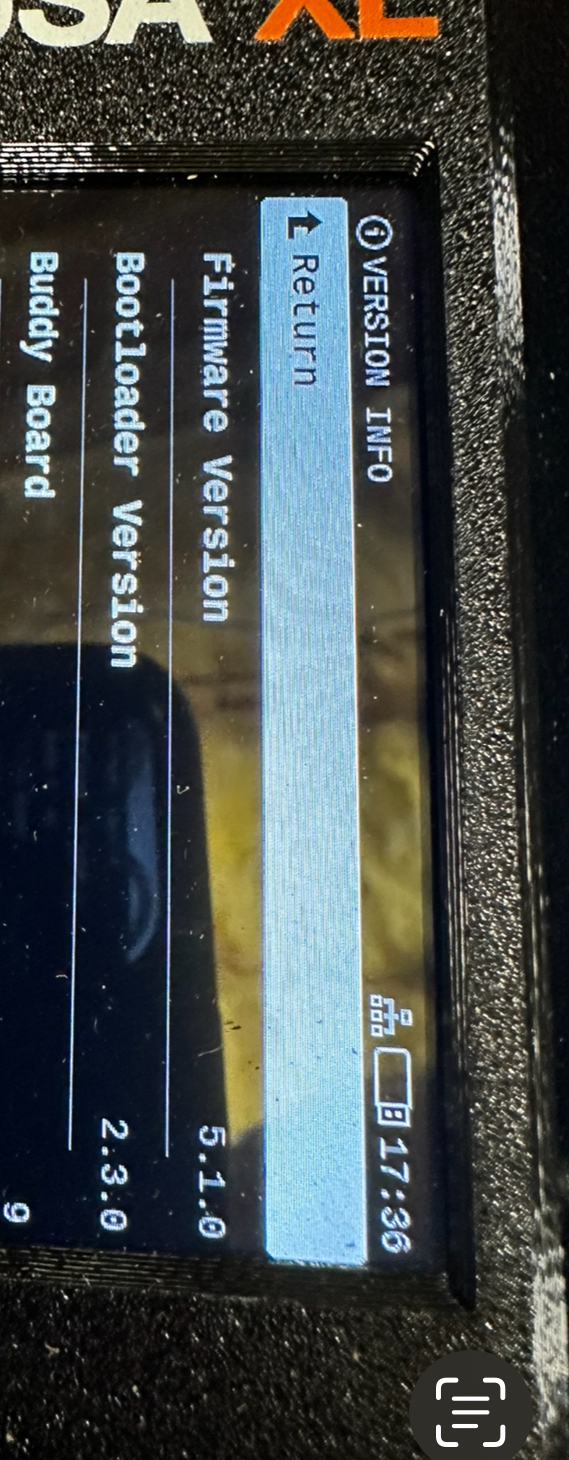

Hi all,
I have the latest 5.1.o fw installed and slicer 2.7.0 but when i go to upload and print i get the warning and it fails?
any ideas to fix?
Best Answer by BritX:
Figured this one out finally.. it doesn't like long file names and fails with the BG format error.
shorten your file name when uploading via slicer and http....

RE: Latest FW and latest Slicer but get error due to G-code exporting
You sure you're on 5.1.0 (not 5.0.1)? This is the error you get when the fw is not able to support the bgcode format.

Ha you made me think is it my eyes.. checked
Bump..any help on this?
roll back FW?
Posted : 13/12/2023 8:26 pm
BritX
(@britx)
