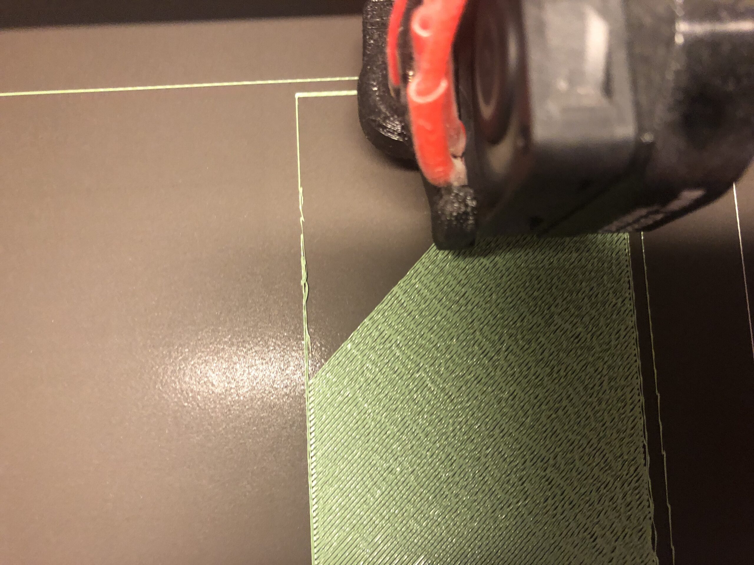

Hi
Does anyone have any hints or ideas of what I can do to achieve a solid first layer on my satin sheet.
The first layer of my PETG does not create a solid layer.
I'm using the satin sheet.
I have set the Z adjustment to -2, it seems to be the lowest it will go.
I can't use rafts, since it takes too long to remove them afterwards.
Best Answer by fuchsr:
If your lines are not together, the most likely explanation is that your nozzle is too high. If your already at -2 you'll have to move your PINDA sensor a bit higher.
The Super PINDA should have about 1.5 mm distance between nozzle and sensor, so that you’re around -1 when your Live Z is correct. That gives you enough wiggle room up and down.

don't forget to reset live Z to 0.00mm after raising your pinda, otherwise you risk scratching your build plate when you restart your printer.

Thank you both for you help.
The first layer looks good now 🙂
