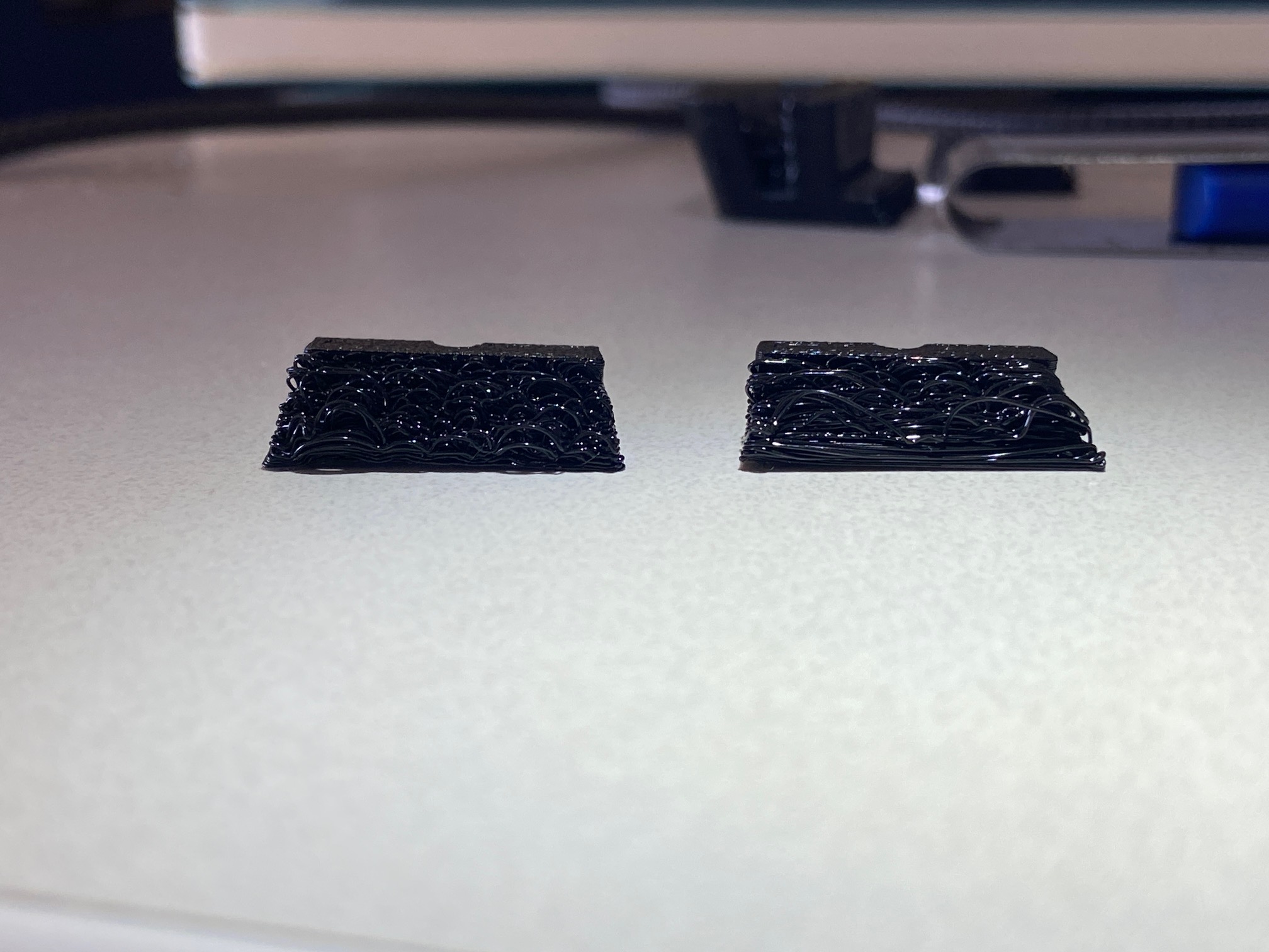

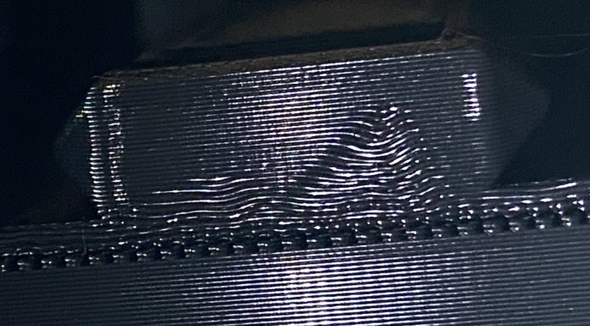

After several years af great printing with my MINI using eSun PLA+, overhangs and bridges have started printing absolutely terrible.
I have not installed any hardware modifications. All parts are stock from the 2021 MINI kit. Tried printing with .20 QUALITY .20 SPEED .15 SPEED on the stock "Esun PLA" slicer settings.
I hadn't changed any settings from the successful prints, it is using the same gcode even. As soon as the filament leaves the nozzle it droops down and turns into spaghetti. This makes supports impossible to remove cleanly, as the first layer above the supports will droop down and fuse into the supports.
Bumping the bridging speed up to 60 mm/s and decreasing flow ratio to .2 was able to bridge a 20mm gap successfully, but overhangs were still failing for the same reasons. So the bridging speed tweaks were not able to fix the root problem.
I worked with support on this for many many hours, we tried
* New filament
* Changing and tuning all manner of bridging parameters, overhang speed, fan speed / cooling,
* Upgrading printer firmware and slicer
* Measuring PTFE tube
* Removing hotend and reapplying new thermal paste
* Verifying hotend and bed temperatures (same as when I was making successful prints)
Failed bridging (default settings)
Failed overhang (default settings)
2 months ago with same exact default settings, successful overhang with no supports used
Underside of failed overhangs

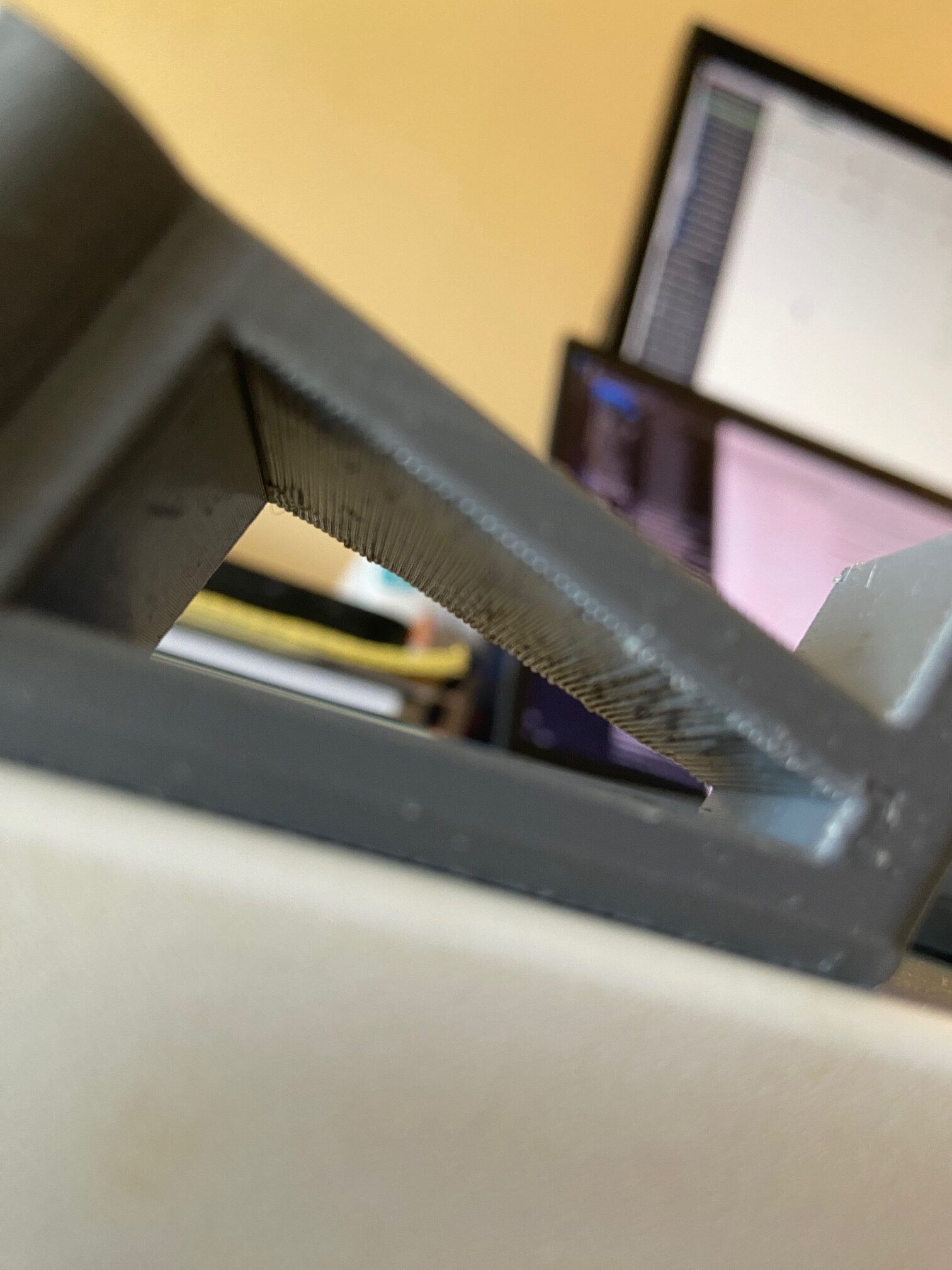

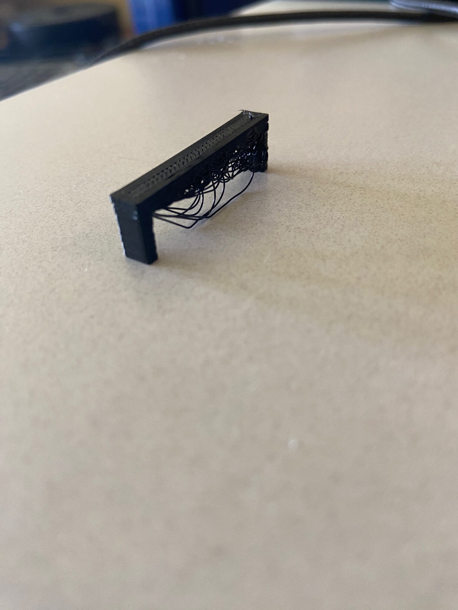

More failure modes,
Some straight walls on edge of print are drooping into itself. This is above about a cm of support material.
More consistently poor bridging, suspended on both ends, length about 1cm.
I believe the hotend temperature is accurate. As part of diagnostics with support I reseated the thermistor and repasted the heatblock. Furthermore, I reduced the print temperature in steps of 5C and noted that the steps and effects on filament extrusion were consistent to when it was printing properly.

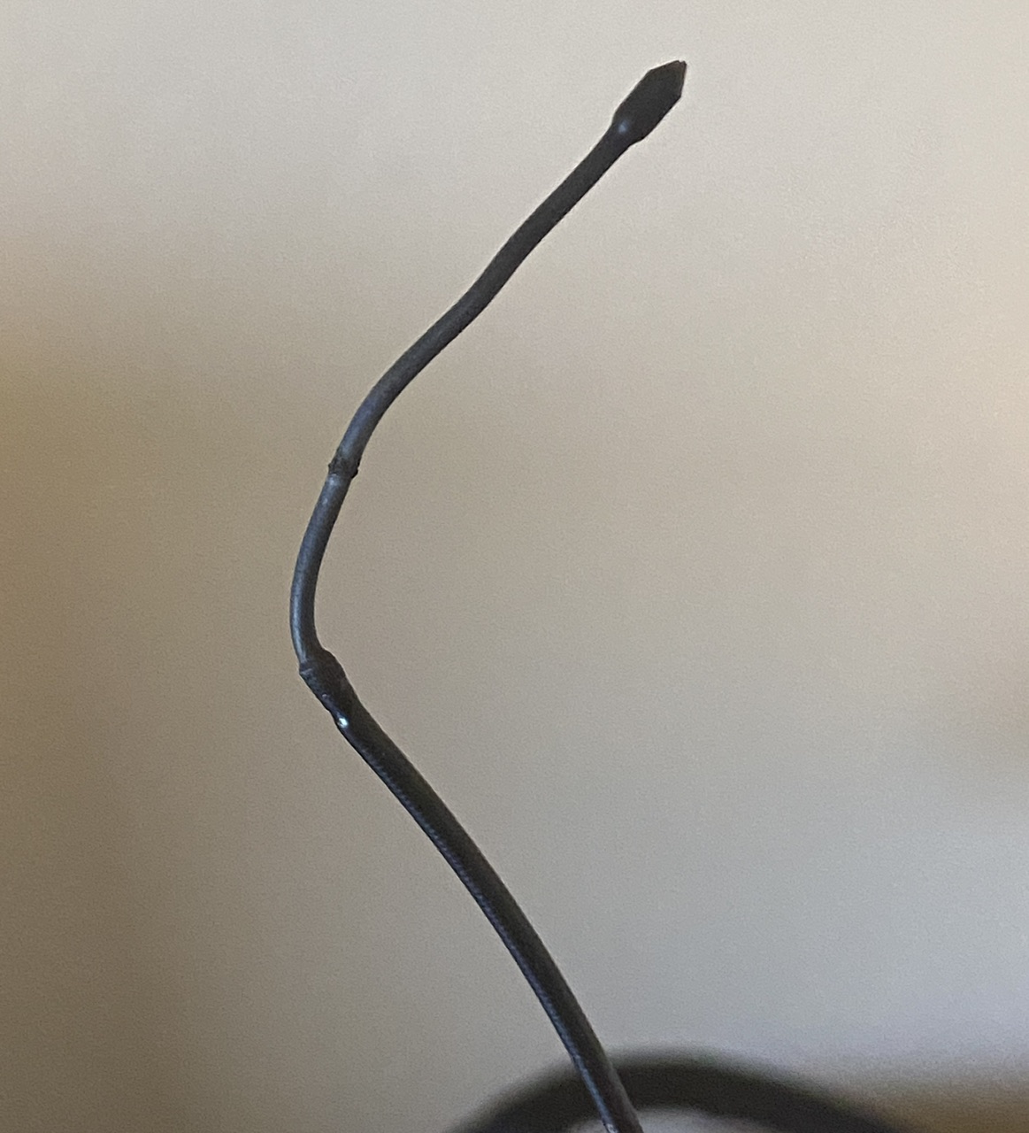

Did you replace the hot end PTFE tube? I just buy a pack and replace if I even think there is an issue. Even a tiny burr can allow filament to leak and cause a clog. What does a cold pull look like?
Regards,
Mark
Posted : 06/07/2024 2:15 pm
excel
(@excel)
I did not replace the tube, but I did inspect it, it was in good condition and smooth on the inside. And I did reseat the hotend according to the manual, which should be providing the proper force and spacing on the tube.
Here is a cold pull.
