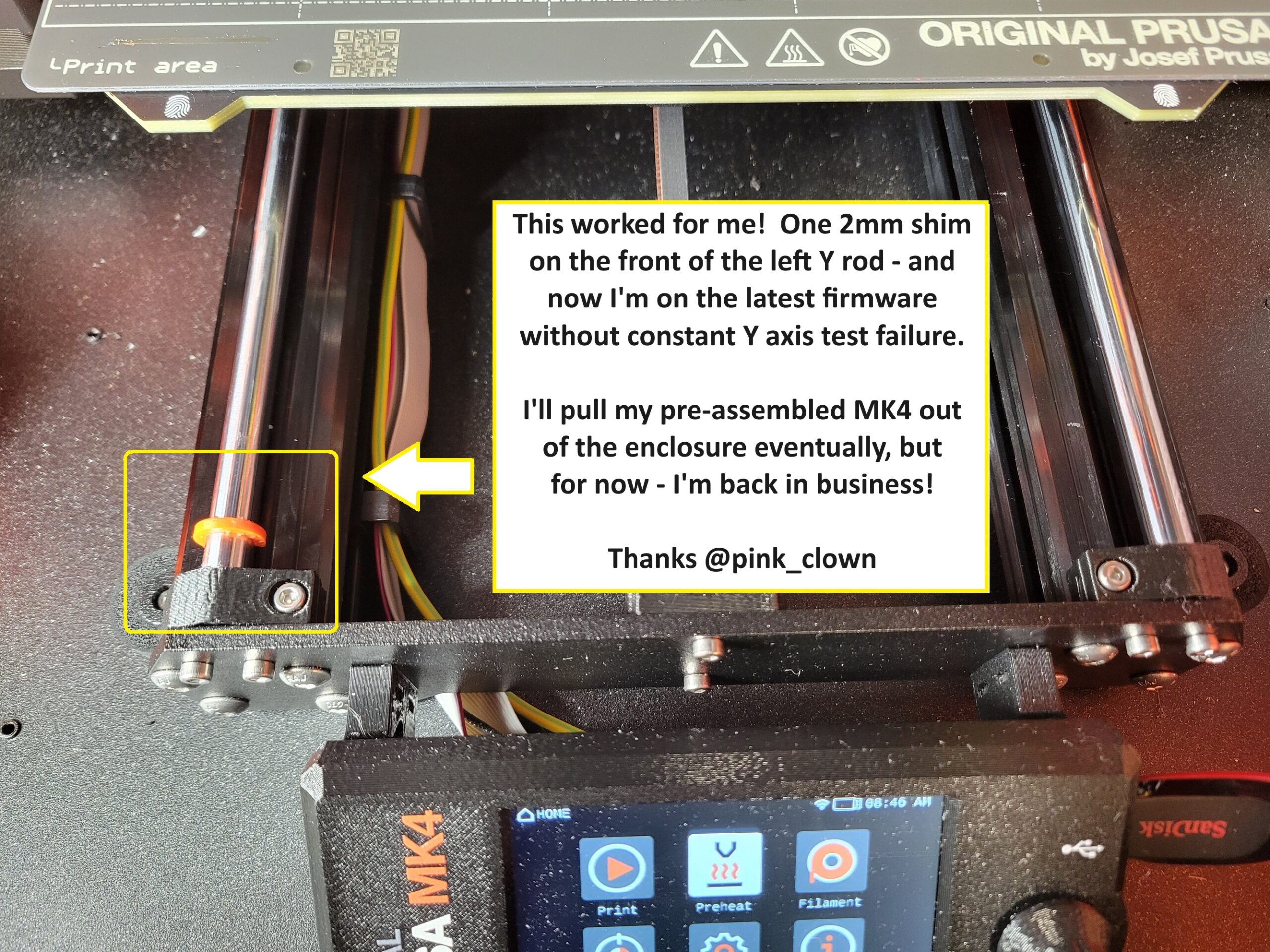

You can solve it also dialing with the left side bearings - to move them a bit more far from each other. But the spacers are more simple.

This worked for me!  One 2mm shim on the front of the left Y rod, and I'm on the latest firmware without constant y-axis test failures!  Thanks @pink_clown!

The same solution is to loosen the front left bearing slightly and move it the thickness of that ring forward towards the front plate, tighten and throw that ring out.

I am happy it helped you.  When you do some math it is as follows:
1. The distance between the front and end frames is 311 mm
2. To get the Y travel distance of 210 mm the distance between the far ends of the bearings should be 101 mm plus/minus the tolerance.
3. Keep in mind, the beginning of the print area front line depends on the position of the rear bearings.
4. You can get it by disassembling the bed and moving the bearings or or insert the distancer. It is up to you.
