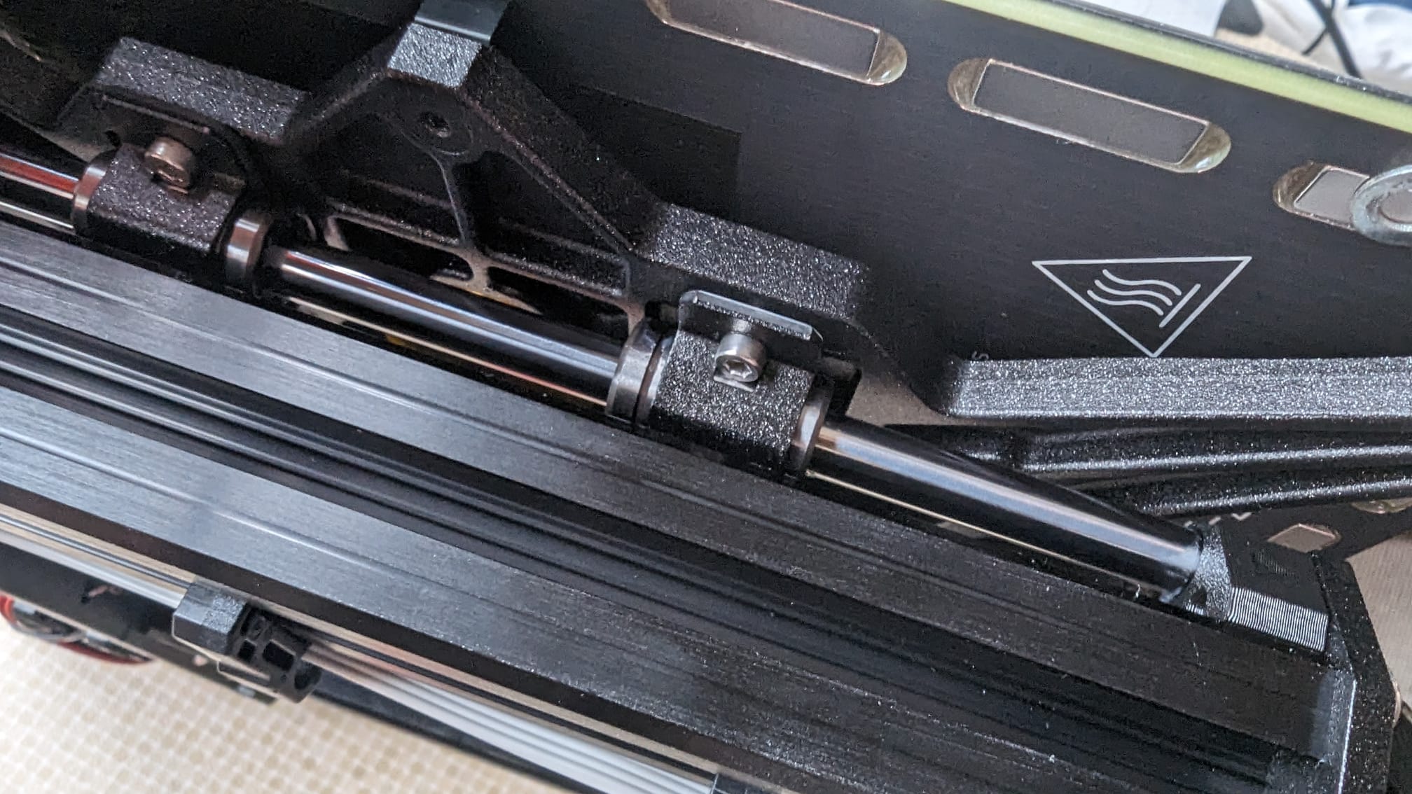

alpritt
(@alpritt)
RE: y and z self test failure after update to 5.1.0
Well, I tried making the adjustment and it didn't help unfortunately. This picture is the before state with the bearing off-center. So I'm reverting again to the old firmware.
Respondido : 27/11/2023 1:57 pm

LilyPink
(@lilypink)
As suggested previously,  don't adjust anything,  your machine hasn't moved mechanically,  just put a 2-3mm block (end of tweezers) inbetween the endplate and the bearing you all want to move out of place, do this during calibration, it will hit this and not go over its 'software limit'...  then it'll pass... and it doesn't go past here during normal use in gcode anyway so won't cause any issues until they fix the bug.  thanks.  😉
Respondido : 27/11/2023 8:44 pm

alpritt
(@alpritt)
I was all set up with a shim to try your trick LilyPink, reloaded the new firmware once again, decided to just do a normal test first because I wanted to film the failed test in slow motion so I could see if the bearing hits or not. And it passed! So I haven't tried your workaround, as I feel I should leave it alone for now!
Not tried printing anything yet with this firmware.
A comment on github had me checking out the assembly instructions again https://help.prusa3d.com/guide/7-y-carriage-heatbed-assembly_438310#458177 and step 19 actually says to have the bearings more to the centre of the bed (out of center from the pockets), so maybe mine didn't slip and I just followed the instructions accurately. But there are some recent comments on there from others having the same trouble. If I am understanding the workaround correctly, it suggests to me if anything the bearings should be further in the opposite direction to the instructions. I also wish the tests could give a bit more feedback as to what it didn't like.
