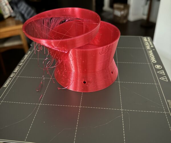

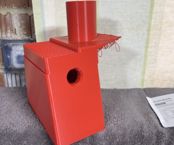

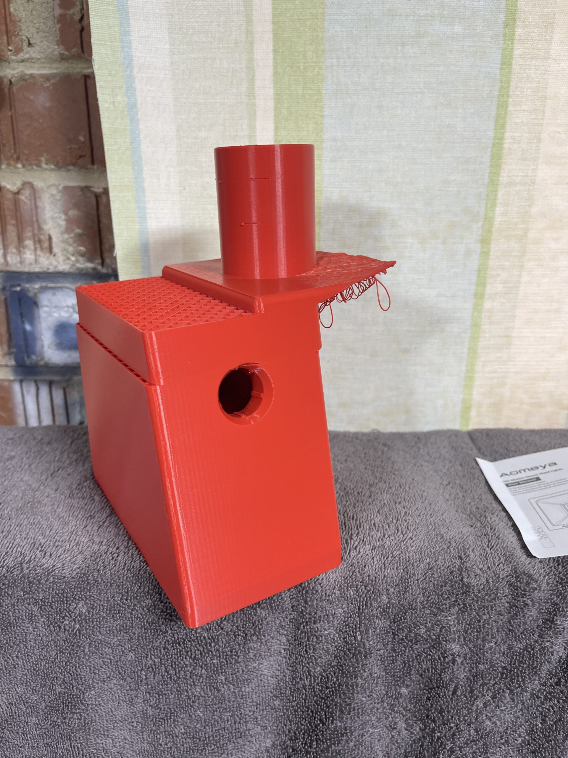

I'm having a Y-axis shift issues. I have checked the belt tension at least 10 times using the pluck the belt method, have ensured the grub screws are tight on the Y-axis motor, also ensured there is nothing interfering with the belt or the pulley on the opposite side from the motor.
The shifting hasn't happened on prints less the 30mm tall but consistently happens on taller prints. The height where the shift occurs is not consistent and the amount of shift also varies. The photo below is of one of the larger shifts.
I'm running 5.1.0 firmware and slicing with Prusa Slicer 2.7.0 and using bgcode. Any ideas what might be causing this?

The firmware version doesn’t seem to be the problem. Printer was downgraded to 5.0 and it happened again but this time it failed while I was watching the print. It was printing fine when suddenly the print bed slammed backwards causing the y-axis drive to jump the belt. It has to be something in the gcode. The default gcode flavor is Merlin2. Is that correct?
