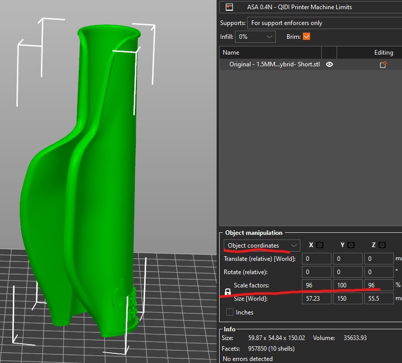

I set and lock the "Object" Scale.

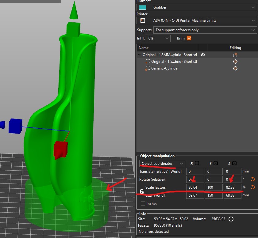

Upon adding a modifier the scale of the Object changes.
I have done everything I can think of and looked for a way to be able to see the scale of the object as set and locked.

The "Lock" icon on the scale settings does not mean that the scale values are locked against future changes, but that they are "locked together" -- i.e. they will always change in proportion, preserving the aspect ratio of the object.
Nevertheless, the scale of an object should not change when you add a modifier to it. As @foxrun3d suggested, it might be helpful if you could upload the zipped .3mf file.

I have discovered that it has something to do with rotation. X,Y axis changes do not effect the scale.
Any model that I rotate, the scale of the object is shown to change when a modifier is added.
I just confirmed that the modifiers MUST be added before rotation. ,,,  BUT, I swear I tried this multiple times before with no success!!!
Try it guys.
Load any model. *
Rotate the model.
Set a scale. *(The scale can be set before rotation with same results.)
Add modifier.
See scale change.
Then Try...
Load Model
Set a Scale
Add modifier (no change in scale)
Rotate model (no change in scale)

This has been a problem forever with PS.  Many github issues already around it.
