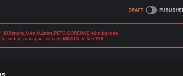

Printables.com: Bug M870 Gcode

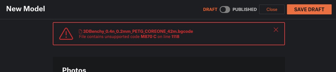

Try to upload any  gcode file exported from Prusaslicer that has the Vent Open Close setup. File contains unsupported gcode M870

I do have 6.40 although the error is coming from the printables.com website whern uploading a file produced by the current version of prusaclicer  using the web interface i.e. browse add file . So I don't think the firmware version matters.

I can only guess but that might be on purpose. If so, the error message tells exactly the situation: M870 is "unsupported" for users that aren't running the latest firmware.
Not saying it's good or bad (and speculation on top), but it would make sense to prevent uploading files that aren't generally backwards compatible.

Ah Ok. I misread your post. I agree with @mnentwig that it's probably for compatibility with older printers or printers not on the 6.4.0 firmware. If you are injecting those into the g-code from Start G-code and End G-code, you'll probably need to remove before uploading. I would use the standard printer profile and reslice with it before uploading.

Looks like a bug. I tried adding tags etc. Seems like it's parsing the g-code and the parser hasn't been updated to include the new Marlin extensions. My custom profile has extra code to open and close the vent. Using the stock profiles work fine, i.e. I'm able to upload after slicing. Unfortunately I don't think printables.com has a public github repo so not sure how to report this given no one from Prusa hangs out here.
