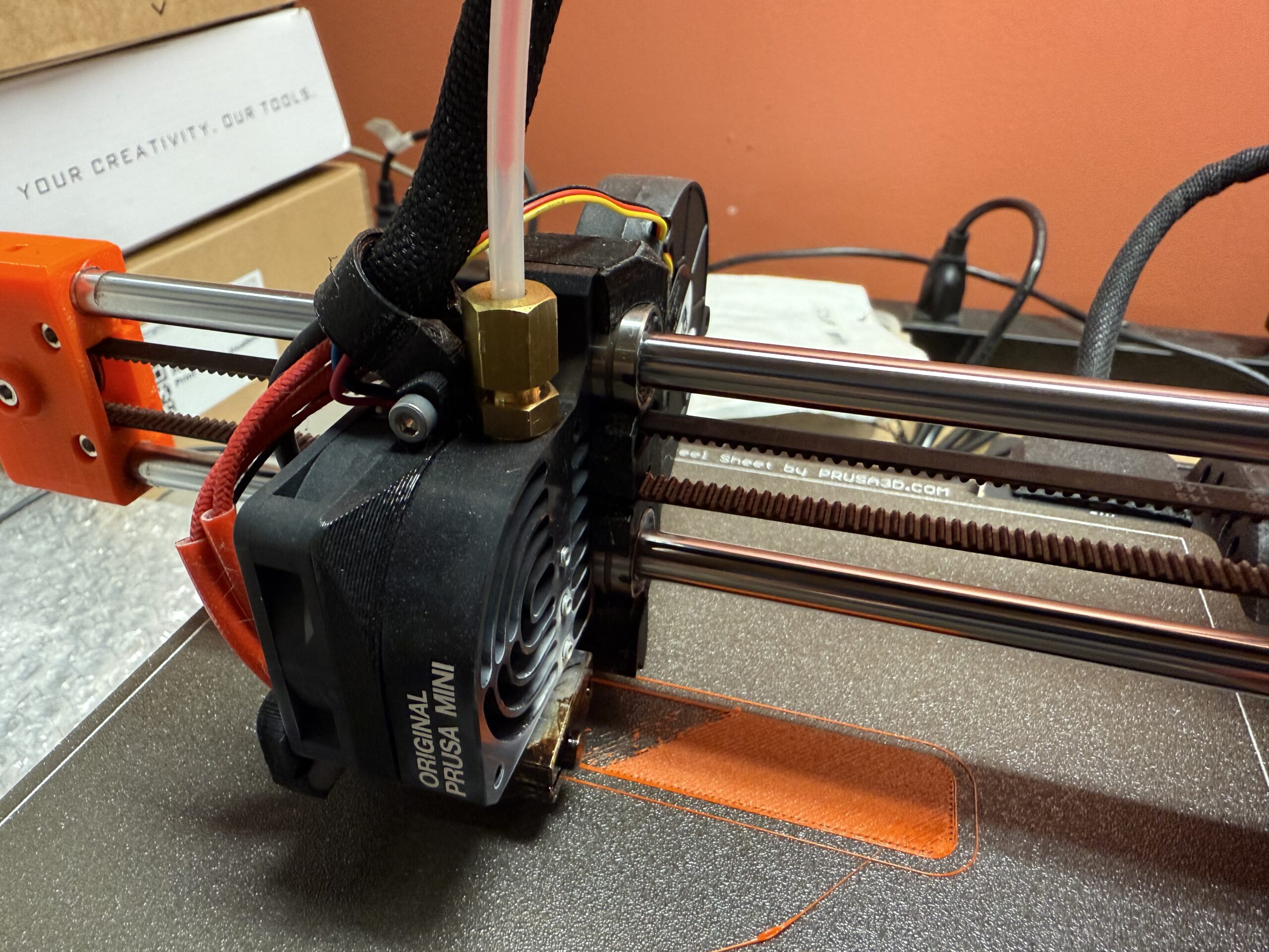

So I've been trying to print a temperature tower. But today my printer is getting halfway through the first layer and retracts the filament over 1 cm but continues to try to print. This is a new problem for me, has never happened previously. I was making (bad) prints just fine yesterday.
I have purged the filament 3 times now, not realizing retraction was happening. I've also tried printing multiple different towers using both PrusaSlicer and downloaded gcode. I seem to get the same results each time. Roughly 50% through layer 1, it retracts the filament but keeps going.Print bed showing a failed print and a retracted filament
