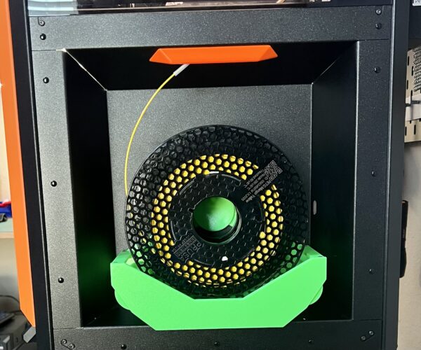

I just don't like the original or the plus spool holders. The filament doesn't seem to feed smoothly, and with a full spool the retraction of initial load will occasionally unspool just enough filament to cause it jump out of the spool. If I don't notice it, when I start printing the filament ends up wrapped around spool holder. This happened to me on the first fresh spool I loaded after installing the new plus spool holder. I am new, and basically only print in PLA and PETG (have done some ASA, TPU, and PCCF), so I don't need anything to fancy, and this will never be a business. Plus I only have about 15-16 cm between the side of the Core One and the wall to I don't have space for anything that sticks out.
Searching Printables shows many mods, but which ones have the forum users actually use, and do they actually work better than the stock for smooth feeding and staying on the spool?

It has been a couple of weeks, but I haven't been idle. I have a spool holder mod for the Core One that suits my needs. What I don't know is if it will work long term. That is something only time will tell, but the principle is sound.
TL;DR - I have a spool holder mod that works with rollers rather an a bar, and while it has it limitations in width, etc., I think it is going to work for me.
When I first started I was convinced I need to adapt Jerrari's Auto-Rewind Spool Holder for RepRack. I rebuilt a side panel to extend up and mount in the spool holder, rebuilt the center support to be angled and match the Core One side panel. It took a bit, but I finally got everything re-designed, printed the parts from original I needed, and the redesigned parts and put it all together and mounted it. The spool set well, the filament feed great. but eventually the coils got too tight and the rollers didn't roll, and spool just slid across the rollers, which was followed closely by under extrusion as the nextuder couldn't feed the filament fast enough.
It while watching this that I realize that I don't need the rewind. My probably has always been a near full filament spool jumping the sides. I could just use the spool holder without the coils. Which was when I remembered seeing fuchsr's (Non-Auto-Rewind) Spool Holder for RepRack. So I made a few changes and now the rollers are mounted in place with 608 bearings and don't have coils. It also has a small 1 to 2 degree tilt towards the Core One to discourage the spool from walking off.
Attached is a picture of the mounted holder. Now I just have to wait and see if there are any specular failures in my future.

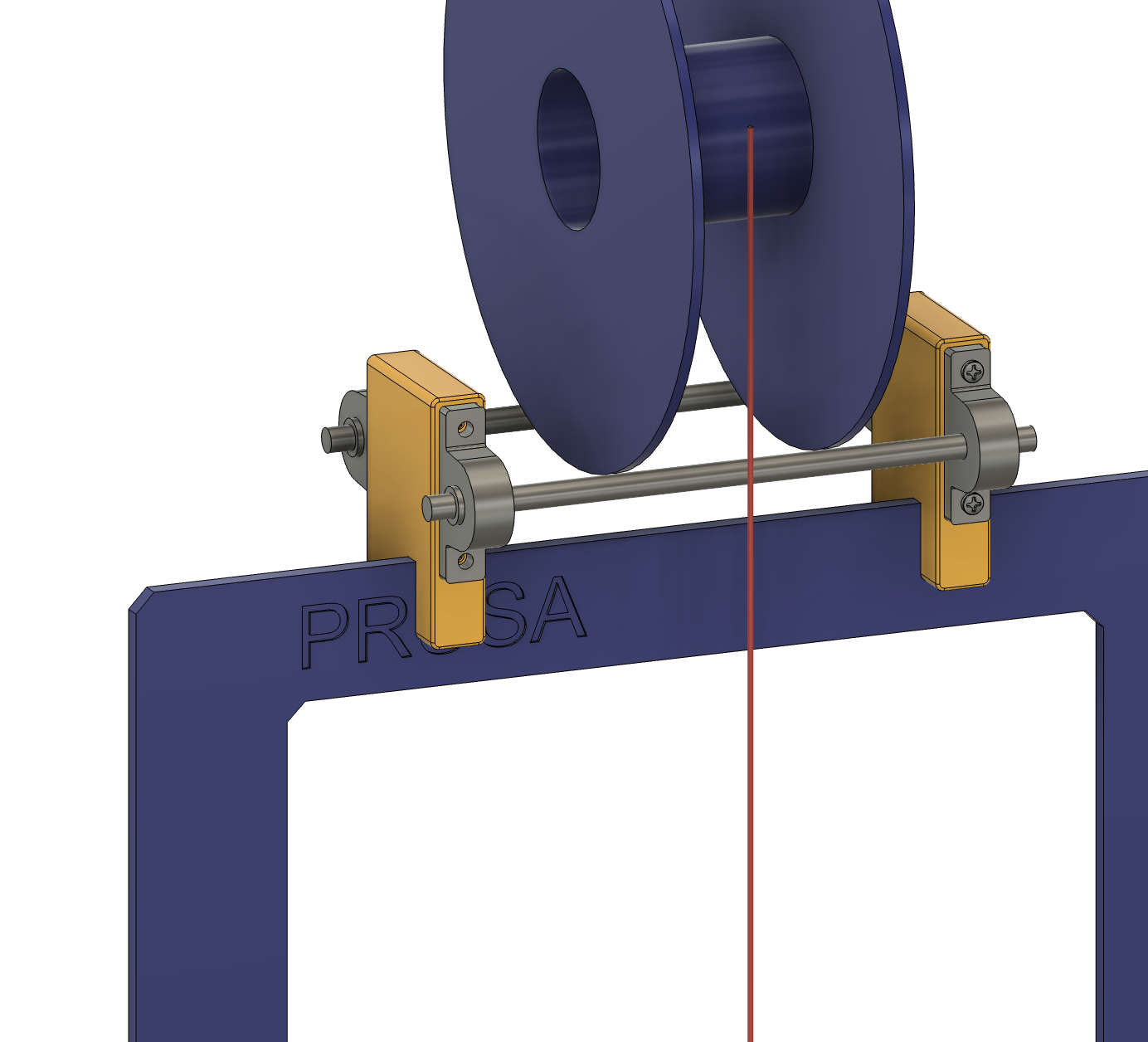

I've just designed this.  Waiting for a roll of "Prusa Orange" filament to show up then I will print it. Just two blocks with slots.  Pillow blocks and rods purchased on Amazon.
