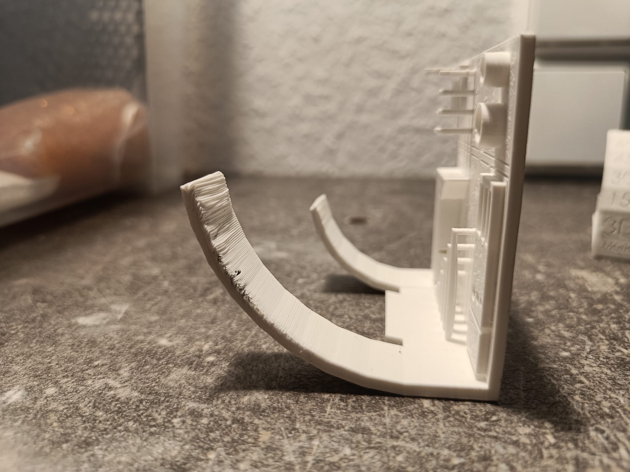

I could not believe what difference made the upgrade to “Detachable Cooling Duct Assembly” and “Prusa Mini Revo Micro Upgrade” printed in ASA. Before it I could not print anything higher than 45 degree without support structure. Now I could print up to 70 degree using Revo recommended settings for the filament: “Max volumetric speed”=10, “Min print speed”=20, “Slow down if layer print time is below”=5, “Retraction length”=1.8 and for the Print settings, Speed “Dynamic overhang speed”=5,5,7,9 without over or under extrusion.
So if anyone states that the Fan Duct upgrades are not worth it for Prusa Mini with Revo, just see the difference between this and my previous posts:

Can confirm. After rebuild with this one https://www.printables.com/de/model/192627-prusa-mini-cfd-optimized-fan-duct
Overhangs and bridging is much better. Before its struggles with 60-70 degress. Now even 80 degress work. Not perfect but work.
before
after
Posted : 16/08/2023 8:56 pm
