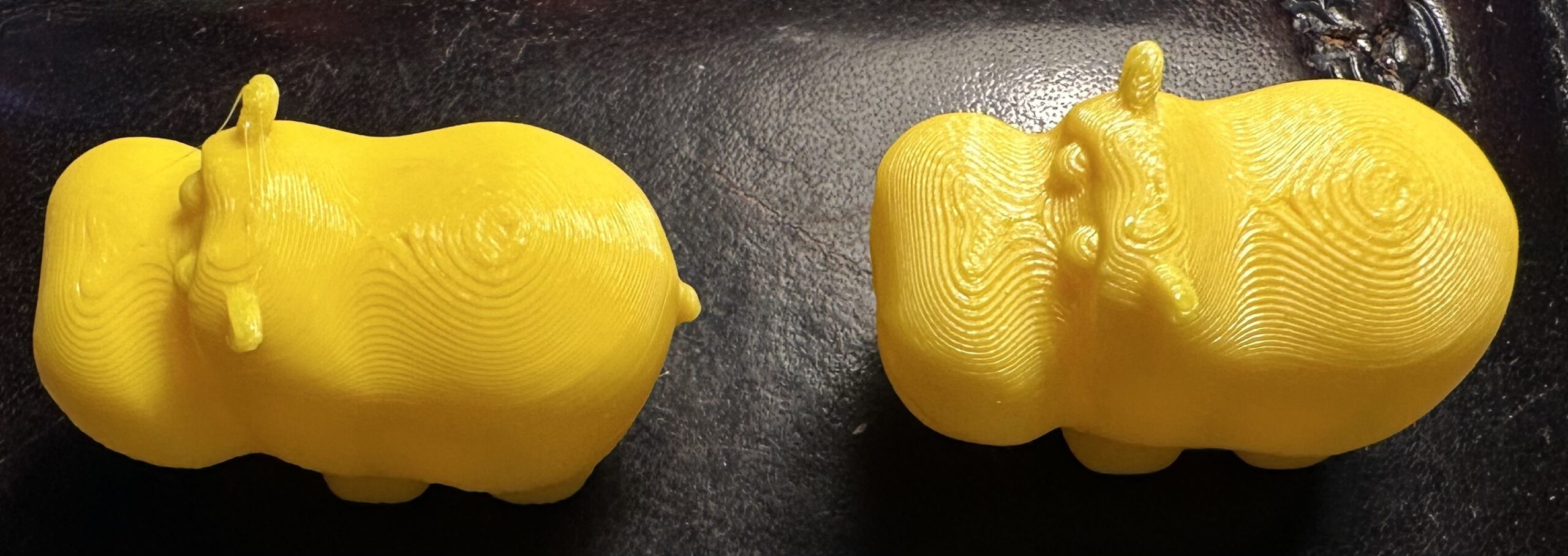

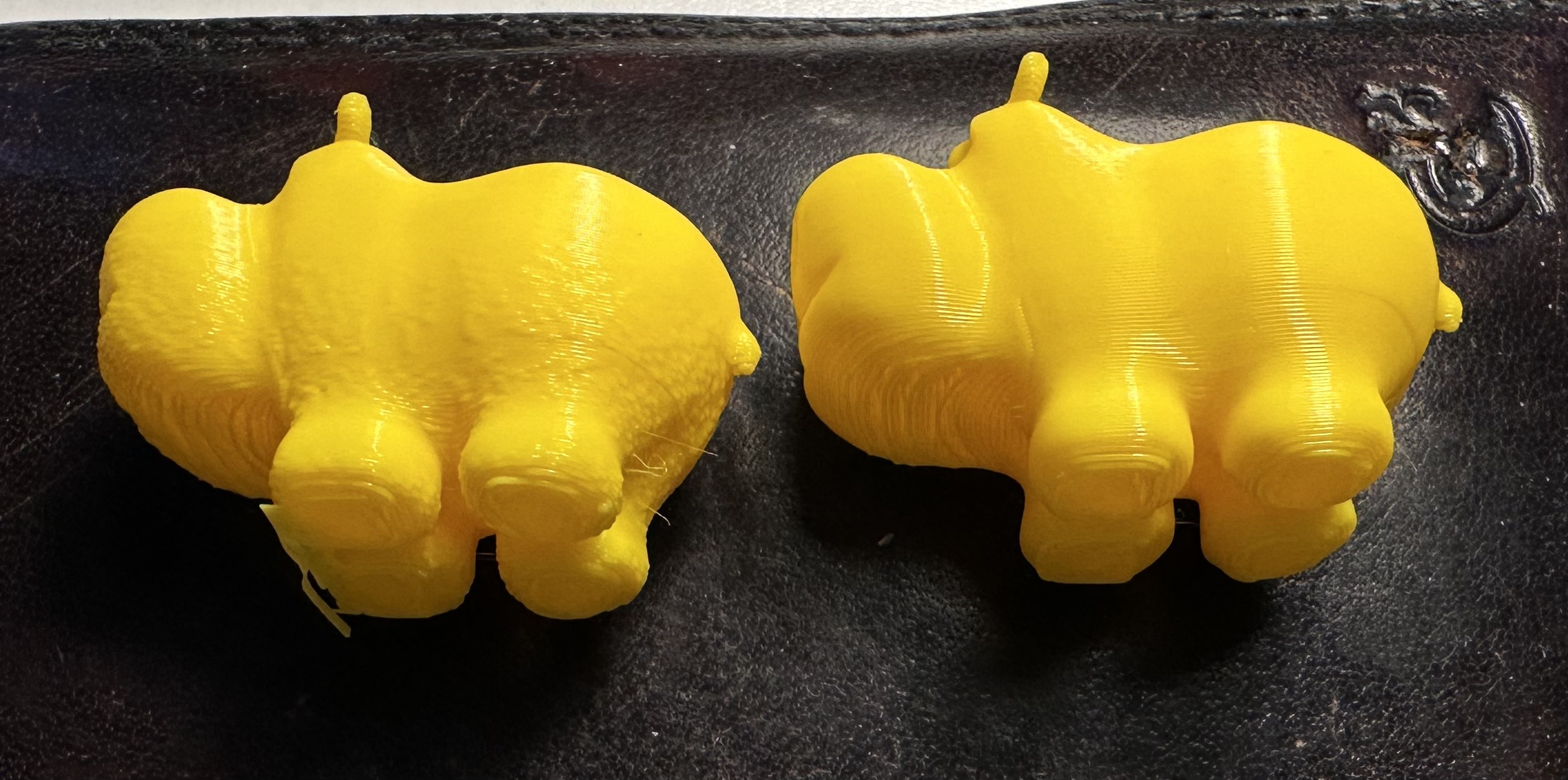

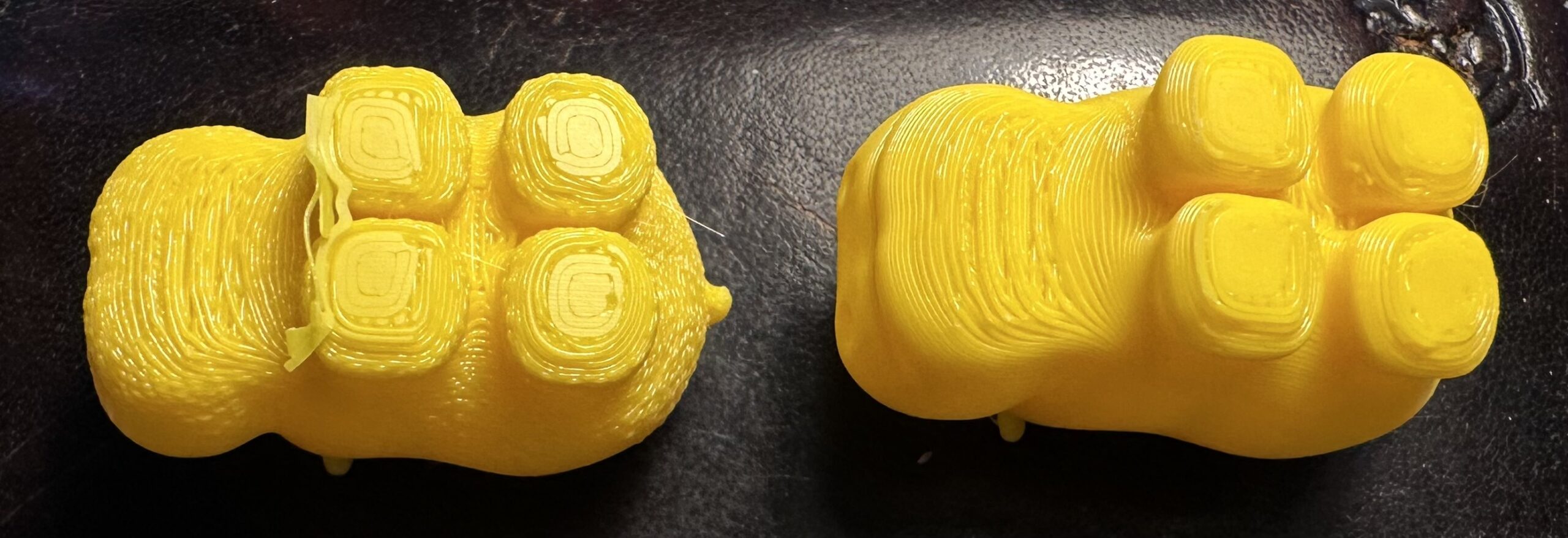

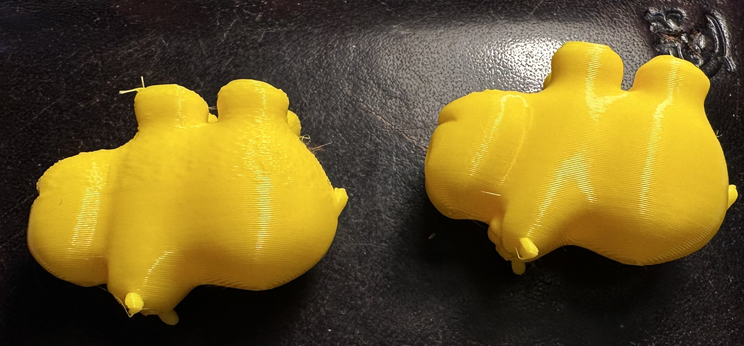

Hi, I installed a stable input shaper firmware 5.0.0 this week and tried to print a 27 min. Benchy gcode using OctoPrint. Octoprint is running on RPI4 and updated to the latest version.
The result was unsatisfiing, approx half of the hull printed with artefacts (blobs). I tryed slice Benchy STL with IS enabled (genetare 40 min gcode) and print. The result was the same. Then I contacted Prusa support, they sent me a sample gcode (22 min Hipo). Result was the same, print time was 33 minutes instead of 22! Meanwhile I tried save Hipo gcode to the USB flash disk and print again... and the result was perfect. Printed without any issues in 22 minutes. I tried print a 27 min. Benchy from USB flash disk and the result was fanatastic.
Hovewer I printed other model sliced for MK4 IS using OctoPrint without any issues.Realy strange behaviour. The Prusa support advanced the issue to their dev team.
Maybe the issue is some plugin that I using? Could anyone test this scenario and write a comment here?
Opublikowany : 22/09/2023 9:09 am

I resolved the issue. It was caused by plugin "DisplayLayerProgress". I uninstalled plugin and problem disappeared.
