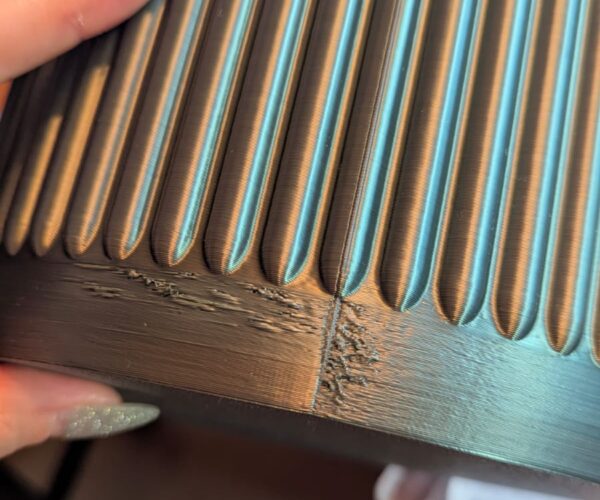

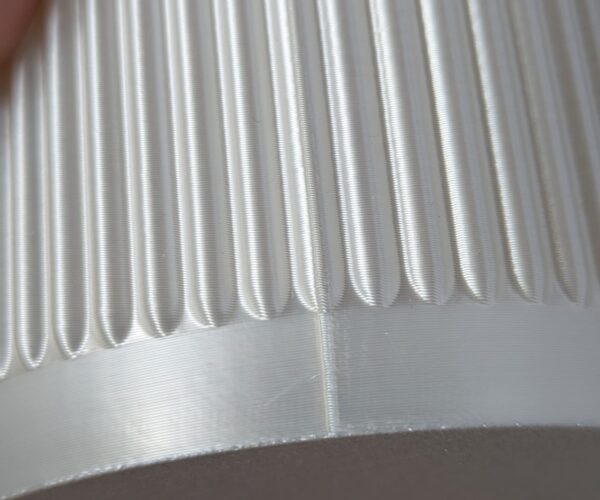

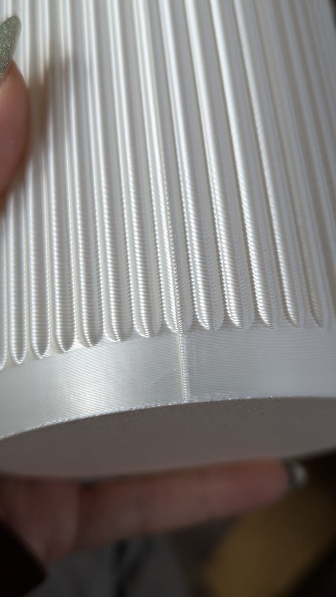

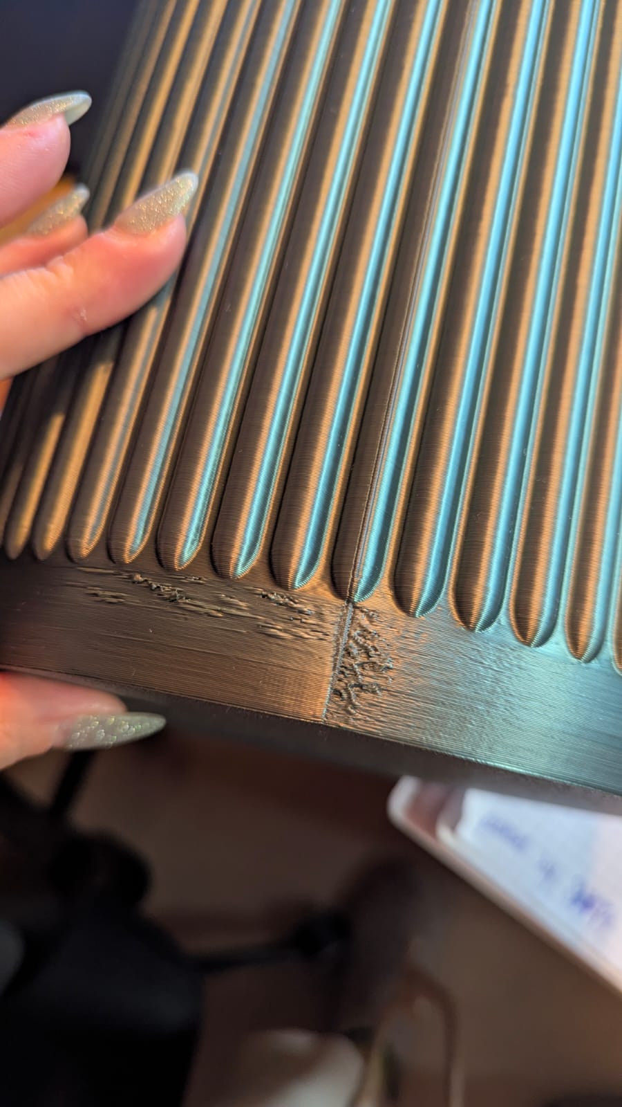

Problems with Seam since Slicer 2.9.0
Hello everyone, I'm new here. I have been printing for 2 years and have been using the Prusa Slicer ever since. So far always without problems. Since the new update of the slicer, I have problems with my seams- I generally don't have a problem with the seam being visible on the back of the part. But recently it doesn't look good at all. Do you have any tips?
Picture 1: sliced before the update to 2.9.0 - very good seam
Picture 2: sliced with the new update - catastrophic seam
Image 3: Preview of the seam after the new update
I would also be happy to upload the G-code here if you can explain how to do this.
Many thanks and best regards
