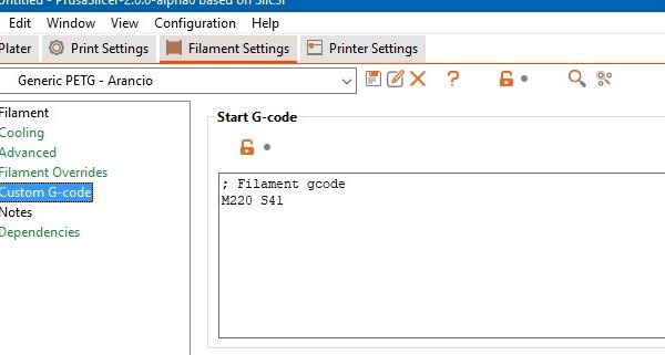

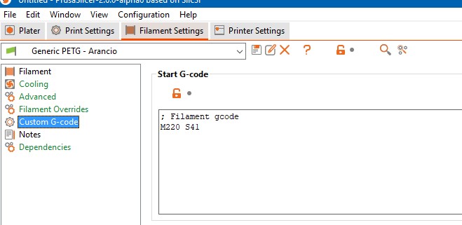

Hello,
I had the same issue today. I was trying to print using an old PETG roll that probably got some humidity, but I did not used it in the past because of its viscosity. It is really dense, so I always switched to a different filament roll. Today I decided to finish the roll,  and tried a print. I was printing on a very fast printer that reaches 400 mm/s, and I realised it was impossible to print.
In order to print I had to lower the global speed at 41% (164 mm/s) and raise the filament temp at the limit of the label (220°).
So here is how to set it in PrusaSlicer:
Now I have changed the PrusaSlicer profile in order to have all this automatic next time, so:
  • I set the Filament Settings other Layers temperature to 220°
  • I went on the Filament Settings and in the Custom G-Code section and I added:
    M220 S41
where the 41 is the speed percentage I use d (41%).
In this way the printer speed will be lowered each time I will use this filament without the need to use the knob or the LCD panel.
