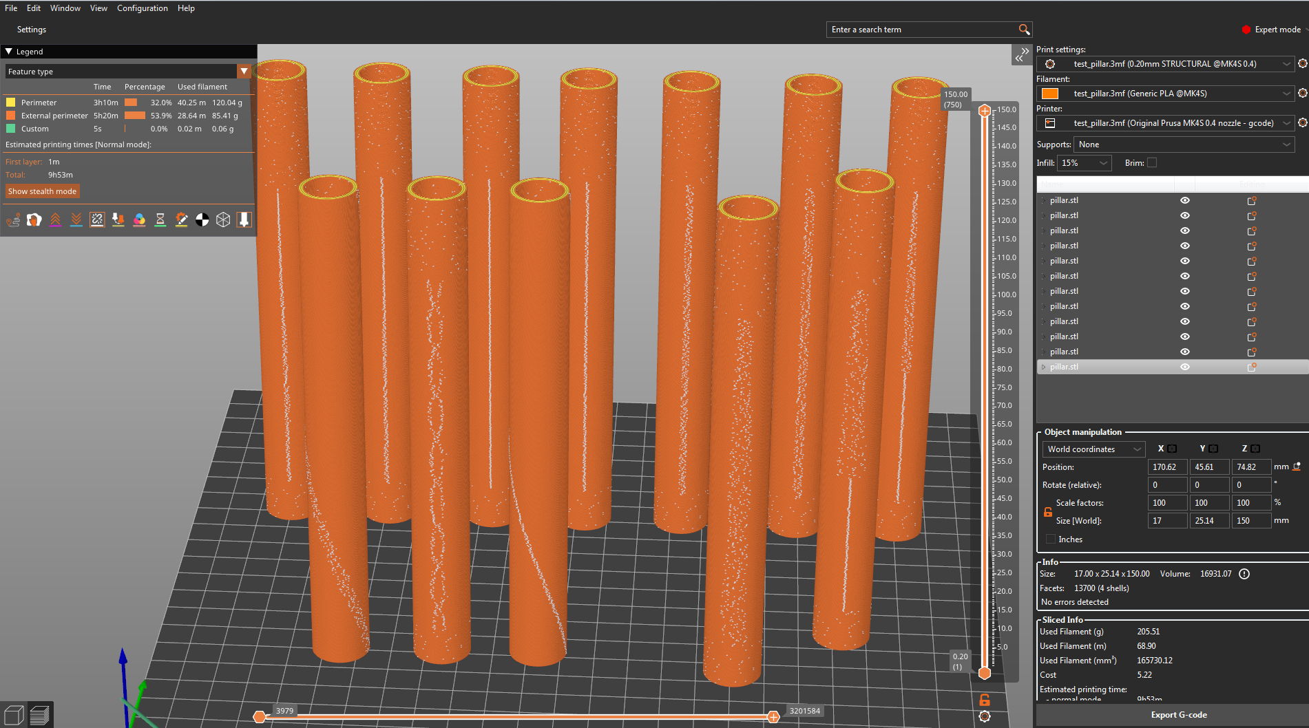

Is this a bug or a known limitation; The enforcer, cylinder in this case, only functions if the cylinder is scaled to apply to complete layers. ie I cannot force only a center pin to have scarfjoints or viceversa. I attached an example project, I tried to enforce fuzzy skin on the inner pin too and that work perfectly fine. But for scarf joints the cylinder needs to be scaled to span complete layers. Which, by coincidence, is not what I want in my current project.
no scarf joint 🙁
And here the enforcer is scaled to span the complete layers
behold, scarf joint!

The whole reason why I'd like this to work is because using scarfjoints increases the average dimensional accuracy of pins and holes, especially if they are small (2-3mm)
Using random seam placement also greatly increases the average dimensional accuracy, but this option is also not available as a modifier :'(
The surface isn't necessarily smoother, in fact it's less smooth, but fitment is better and alignment also...

I'm finding more inconsistent behavior concerning this. Setting the seam position seams to affect how "smooth" the surface needs to be for "Scarf joint only on smooth perimeters" to take affect, where having it set to "rear" gives the most expected result.
Random: Scarf joints are applied everywhere, needless of geometry, ie '..only on smooth..' is basically ignored
Nearest: The diameter of a hole needs to be significantly larger to be considered "smooth" not sure exactly but a 6mm hole is consider "unsmooth" so no there scarfjoint.
Aligned: Seeeeaams .... aa aa! to behave quite the same as 'Nearest'
Rear: Behaves very well, even a hole with a 4mm diameter gets a scarfjoint while outer perimeters with some sharp edge is ignored. I do wish all joint placement settings would behave like this.

Here's the shenanigans I've been up to with this https://www.printables.com/model/1581166-massage-shower-head-with-exchangable-nozzle
I've mostly solved it, I'm still not 100% satisfied but using a very short scarf joint (2-4mm) in conjunction with "only on smooth surfaces" yields descent enough of a result. It doesn't really add any print time either, as using "around entire perimeter" do, however it's not quite as smooth. The problem in question is making a watertight-ish seal for a dual mode showerhead withouth using o-rings or TPU.
As I've been working on this, I think that actually being able to paint where to add scarfjoints vs normal seams would make the most sense? so if anyone at prusa reads this; do that ;D ... Then again, this is probably a highly specialized rarely need feature so .... case closed ;P
