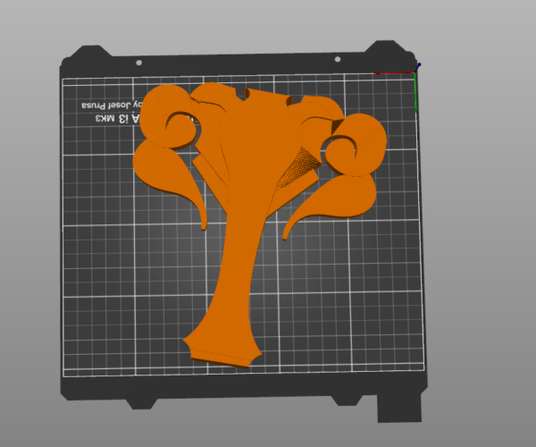

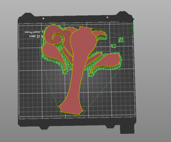

Pursa slicer removes some of my object? Any way to fix this?

In many cases  missing parts in the slicer are caused by a nozzle size too large for too fine a print. In this case, however, where the part seems to be rather large, could it be that the missing part is not flat on the print bed? Or does the slicer in the right hand part of the window show an error of the file which needs to be corrected?

Not much to go on ☹️. My money is on a broken STL file. Yes, there's a way to fix it: Fix the model.

Thank you for the replies I have uploaded a zip file. I have tried to create other STL files but they all cut out pieces of this part. It looks fine in blender so I am not sure how to fix it there if the model itself it the problem. Any advice helps. Thank you!

when I load this file, Five of the STL's have errors
the model is  too large for the mk3 Build plate
and the various elements are displaced in space...
so it's going to take a bit of sorting...

for the model I just created one side of it and then I duplicated the it and flipped it on the x axis. Would it still be a model problem even though only one side is missing parts since they are the same?

Yeah there are so many issues with those models.  I could tell from the second pic (the orange part) as there are dark areas.  That an immediate indication of issues such as flipped normals etc.
On loading in the 3mf with all the scattered parts that Joan pictured of the 7 objects only 2 of them are ok, the other 5 have thousands of errors each.  Bringing the stl files into Blender and I can already see that you don't understand the need for creating manifold models.  Theres lots of non manifold areas. Non manifold issues are the biggest thing that slicers cant deal with well.  Other errors like intersecting faces they can handle to a certain extent and you don't have to get a model perfect (although its helps) but you do have to keep the number and type down.  You also cant just plonk overlapping geometry on top of each other and join them.  Instant thousands of intersecting faces.
If you want me to take a look at the blender file I can do but from the stl's its a case that I think you have a lot of learning to do.  You cant just create a shape.  Well you can if all you want it to do is render for use in a game or similar but you can not if you want to turn into a real world object that can be printed.  The first thing I suggest is activating blenders 3d-tool add on and running that.  That will highlight issues in the models themselves and will start to show you just how much is wrong.

Here is the blend file. Where do you see errors in the slicer? I only see the object is too big for printer error which I ignore because I'm not trying to print them all at once only one at a time. I don't see any other errors on screen and not sure where to go to view them. I will go ahead and download the 3d-tool add on and start with that. I have no clue what a manifold model is so you would be correct. Thank you for the help!

In the tree list on the right if you see a warning triangle next to your object then thats the indication of errors,  then you can hover over it and it will list them.  Also towards the bottom when you have one selected it is also shown.

Thank you! After clicking on the warning triangle it auto fixed all the open edges and there are no missing parts when I slice it now. Going forward I will try to close all of my meshes and use the add on to help with other errors.
