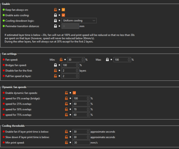

In the cooling page of the filament settings is something you may have overlooked. You need to be in Expert mode to see the settings. It is a section of settings called "Dynamic fan speeds". Here are the default settings for Prusament PC Blend for the C1 to show you how it can be done:
Interestingly, for the same filament profile if I change printer to the MK4, dynamic cooling is turned off.
This gives you control not only for extra fan on bridges, but for different amounts of overlap (kind the opposite of overhang). FWIW, I see this setting in 2.9.4, I don't recall which version they added this.

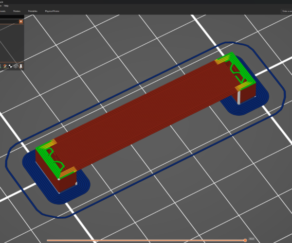

Here's an example, a bridging layer of a test part, serves zero function other than testing bridging.

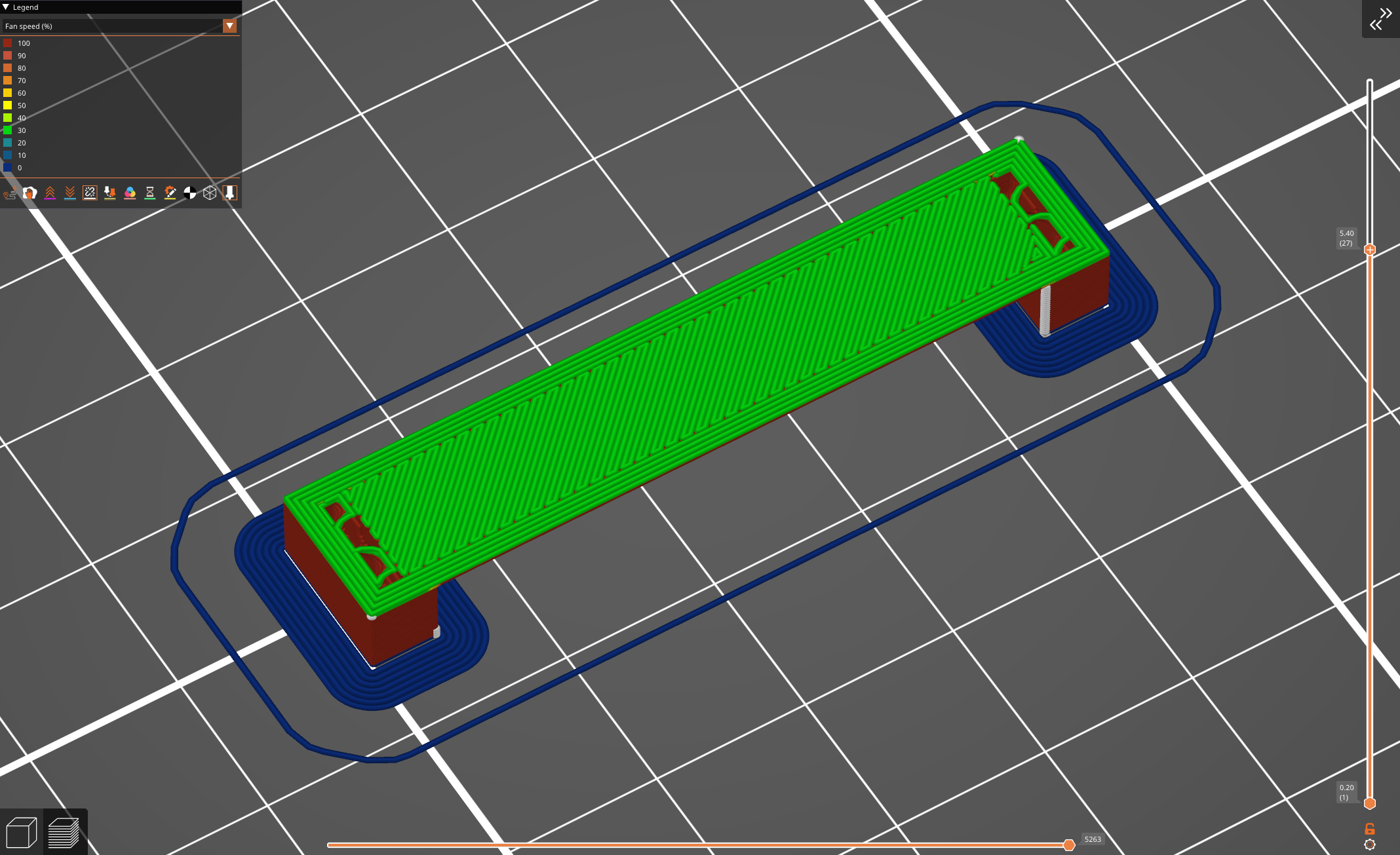

Then the following layer printed over the layer with the bridge. I have the bridged layer tuned so I have a smooth layer, and no drooping, with a ton of part cooling as well.
My issue is that the layer after bridging is causing significant sagging once printed, however by manually adjusting fan pwm during the print on the new layer I get good solid part as a result, problem solved, except that I can't have the slicer differentiate between the area over the bridge for fan speed, and the entire rest of the layer.
