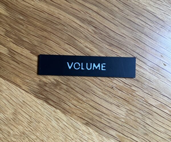

I would like to print some text on a box front cover I have designed, but I get disappointing results.
I am posting here because I think tuning some slicer parameters could improve the look of my text. Please correct me if I am wrong. Following is a sample of my tests.
I am using :
  • PrusaSlicer 2.7.1 with the directives of Joan Tabb found here: Manual multicolor  :  "another possibility, with a single model, is to use modifiers, to allocate different colours to different parts of a model, using the virtual multiple extruder option...". But I do use the Wipe Tower (I did not understand why Joan recommended to discard it). I have also reduced the speed of the first layer to 10mm/s, thinking this could improve the quality of the text, but it did not change anything.
  • Prusa MK4 with 0.4mm nozzle
  • Sunlu PLA+ filament
Can you help me please to improve the print quality of my text? Maybe isn't it possible with a 0.4mm nozzle... Here is my .3mf file:

Hi Georgie,
I Can't find your 3mf file  the link takes me to Printables  but I Can't find the file...
Could you Zip Compress it, and attach it here?
When I started using Manual MMU I was under the impression that the Purge tower was not appropriate.
Now, I believe it is useable.
are you printing the panel face down?
Are you using virtual extruder 1 for the black and virtual extruder 2 for the blue?
Are you using Arachne perimeter generator?
It looks like you may be getting a bit of stringing and a bit of elephants foot and possibly arachne is changing the shape of the characters...
If you are using Arachne, try classic perimeter generator
Try Blue in virtual extruder 1, so that it claims it's space on the build plate before the black in extruder 2
Keep the temperatures low enough to prevent stringing.
Try again
Regards Joan

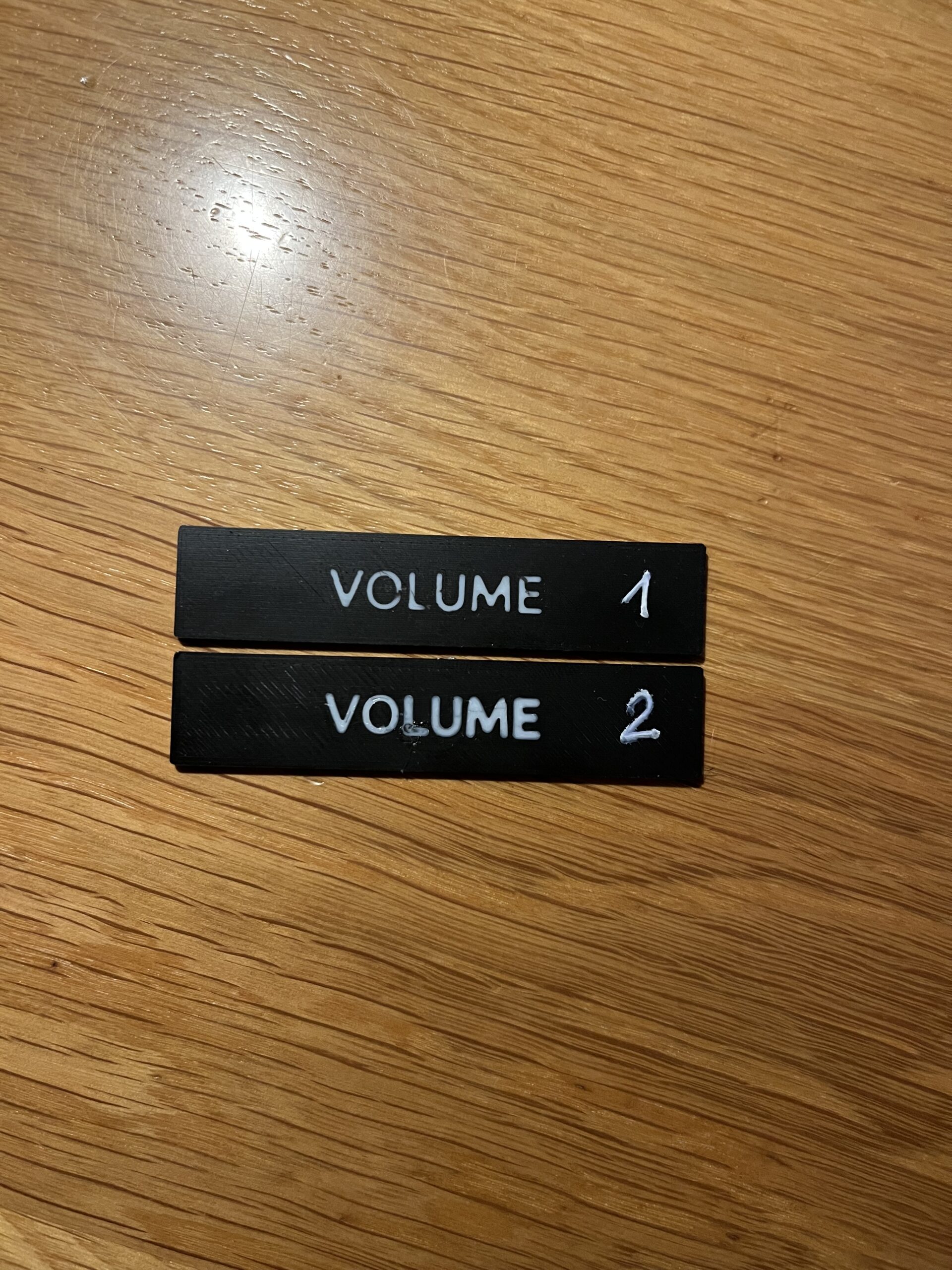

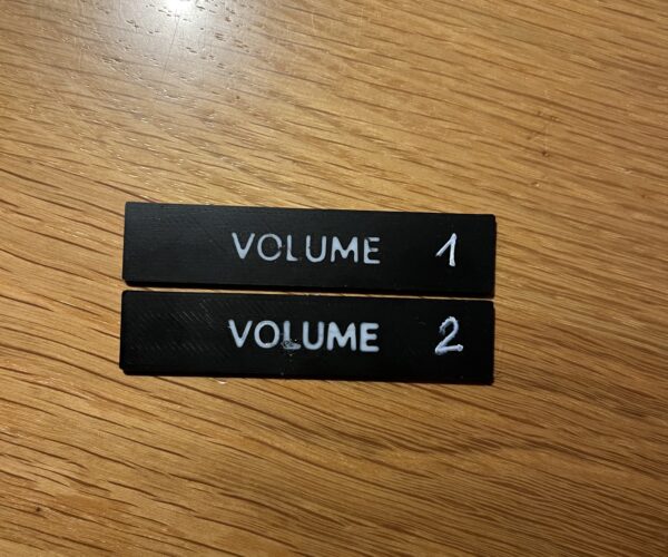

Here is what I get from your recommendations. That's better, but white letters are not so... white. Do you think increasing the depth of the text modifier could improve whiteness? I have attached the zipped project file. There was a short extrusion of black PLA after filament change, above the 'L' letter, just before the nozzle moved to the wipe tower. It's very difficult to catch this small amount of filament before it gets colder, not to mention the risk to remove text by pulling the excess of melted black filament. Should users perform such actions to get a perfect result? If yes, I wonder how one can rely on the MMU device...

Hi Georges.
different white filaments have different opacity.
Prusa Signal white, is a good strong white, many others are more sort of watery,
additional layers behind light colours can help immensely but it always leads to more colour changes, which can be a pain with Manual MMU.
Did you clean the nozzle before you started?
is it possible that you are over extruding a little?
Here is a reply I Typed recently, It may help...
Managing the waste pile and filament change is a bit of a pain, manually
https://forum.prusa3d.com/forum/original-prusa-i3-mk3s-mk3-hardware-firmware-and-software-help/large-blob-on-wipe-tower/#post-698679
The MMU3 finishes a section of say Blue Lettering. Then moves to the Purge Block,
Wipes the extruders nozzle, then re shapes the filament tip, before withdrawing it.
it then loads the next filament and wipes the mixed filament un the purge block, until it hopes the colours have changed, at which time, the printer returns to the print
this was Manual MMU, and I got a blot behind the white over the 'i'
the whole card was 0.8mm thick
Joan

When you change to the black, gently hook the expelled filament over your finger and press ok for correct filament load. Some more filament will extrude so wait till the head starts to move and follow toward the print. Hold on as late as possible before pulling the filament away to ensure you don’t leave any soft filament at the nozzle.
An extra layer of text will improve its opacity.
Minimise elephant foot compensation.

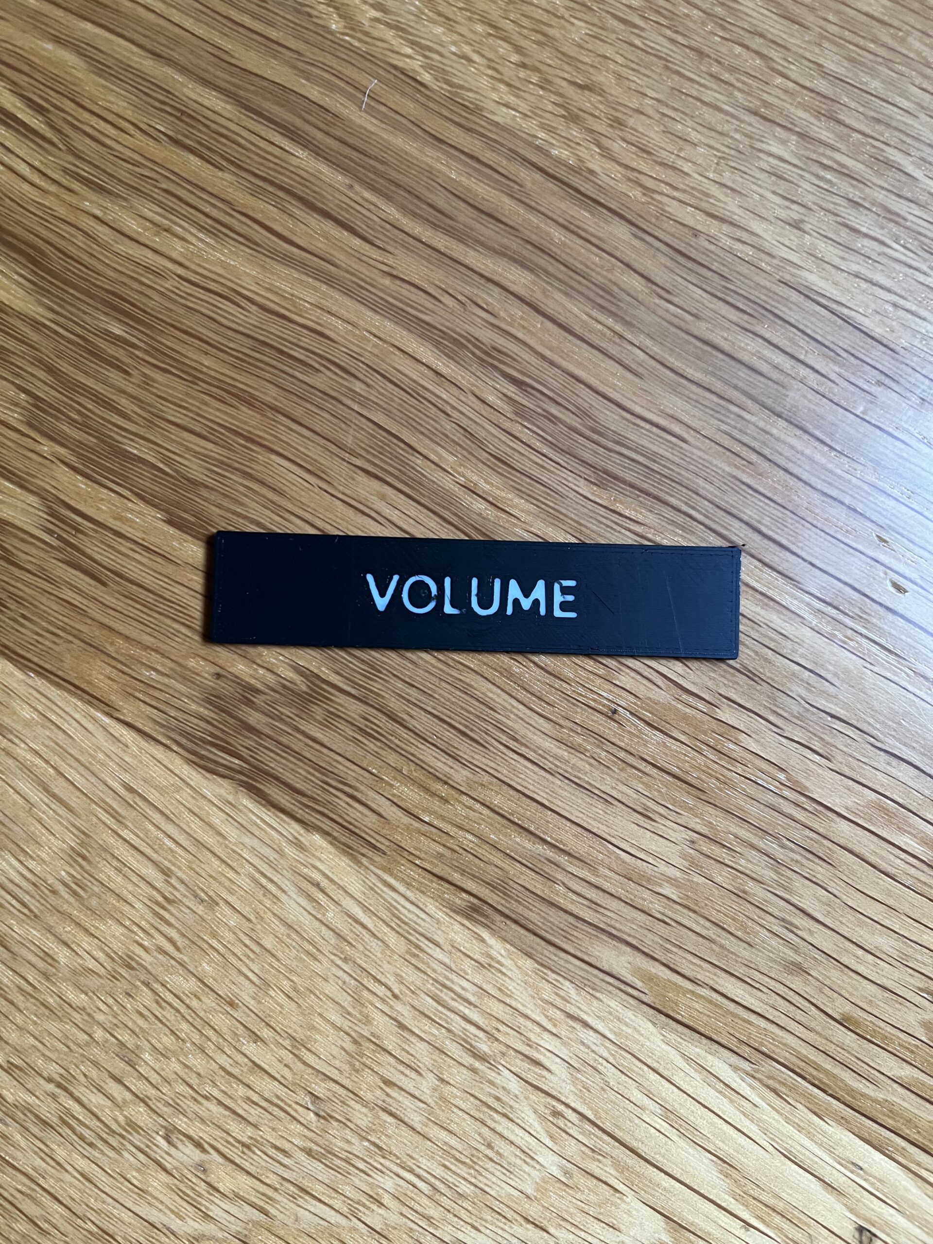

I'm going to order one PETG Signal White spool.
I will run my next test with a 0.8mm depth for the text modifier.
No, I didn't. I'm using a silicon sock to protect the hot end. I'm going to clean this sock.
Maybe... I don't know.
Large blob on wipe tower...
I have parsed the firmware source code on Github. M600 N is not supported by the MK4 firmware.
I now do the colour change one layer higher than normal, so that the touchdown position for the beauty spot, is under the print area of the new colour
Ooooh ! Nice trick ! This is implemented in PrusaSlicer 2.7.2-alpha2 !  https://github.com/prusa3d/PrusaSlicer/releases    Look at Color change (M600) improvements
I will do this for sure.
I have to study the meaning of this... 😉

Elephants foot compensation makes the first layer outline smaller than the others to allow for it spreading under heated pressure, as I understand. Anyway the text might suffer if the adjustment makes the text smaller.
