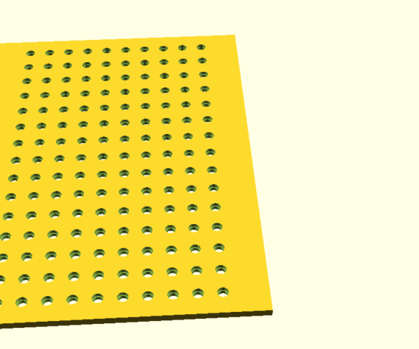

I know how to add negative space, I have 150 3mmx3mmx10mm cylinders as part, How do I change this to negative type so I can place on 125x165x3mm slab and merge them creating a LED matrix faceplate?  I thought I saw a type change somewhere but cant remember where its located, its not on normal select pull down when you select the array 10x15 of 3mm bits.  thx

This isn't really a slicer function although PrusaSlicer can do it (I rather wish it couldn't, these CADish extras cause no end of problems) - see below.
It rather depends which CAD you are using but usually you are looking for a simple difference and the job is best done parametricaly; eg. in OpenSCAD:
//  LED array faceplate
// All measurements in millimetres
// Faceplate dimensions
slabx=115;
slaby=165;
slabz=3;
// LED spacing
xspace=9;
yspace=10.5;
// LED arrangement
rows=15;
columns=10;
// Starting point for array
insetx=(slabx-xspace*(columns-1))/2; // Can be any suitable values
insety=(slaby-yspace*(rows-1))/2;  //      Here calculation is to centralise
//  LED dimensions - measure yours, they are often slightly large
LEDdia1=3.1;    // head diameter
LEDdia2=3.75; //  collar diameter
// How deep do you want the LED to seat?
LEDrimdepth=1.5;
//  How much to allow for extrusion 'squidge' around the socket
//  - will vary depending on filament, nozzle size, speed and layer height
// - test print first.
tolerance=0.5;
$fn=20;  // a little extra smoothing for the narrow cylinders, can go higher at need
difference(){
    cube([slabx,slaby,slabz]);
    translate([insetx,insety,0]){
        for (row=[0:rows-1]){
            for (column=[0:columns-1]){
                LEDsocket(column*xspace, row*yspace, LEDrimdepth);
module LEDsocket(x,y,rimd){  // assumes the face is against the build sheet
    // NOTE: the slabz value works in this instance
    //              but may not be appropriate in complex cases
    translate([x,y,rimd-slabz]){
        cylinder(d=LEDdia1+ tolerance, h=slabz);
    translate([x,y,rimd]){
        cylinder(d=LEDdia2+ tolerance, h=slabz);

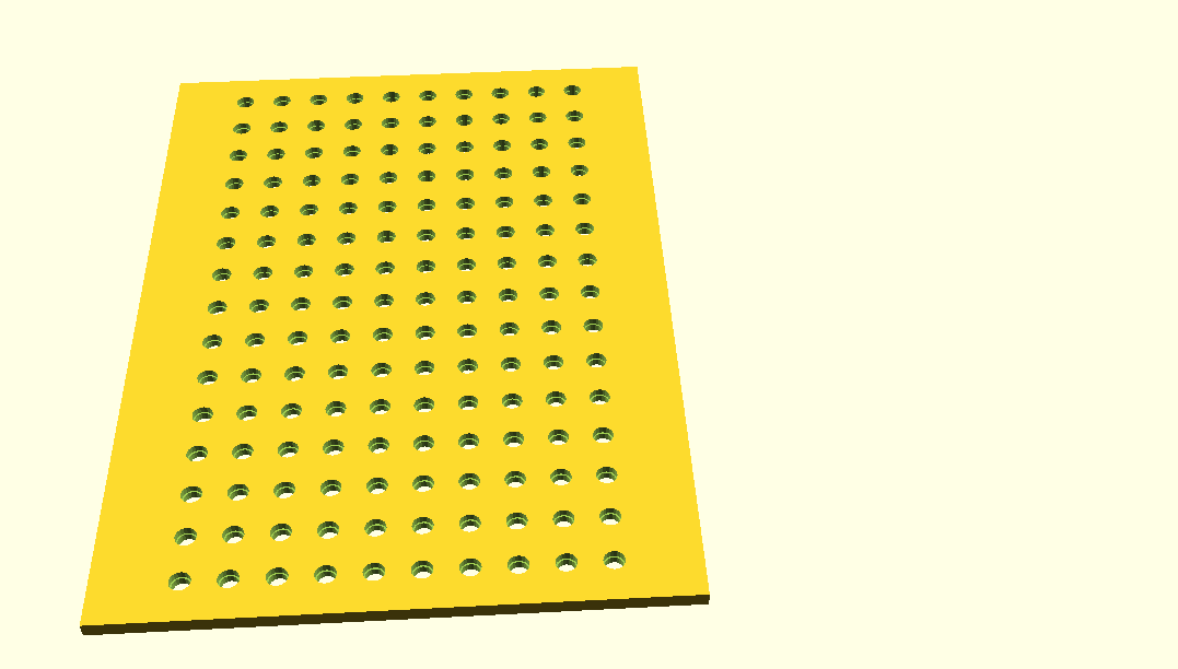

Produced this:
Everything is parametric, adjust the values to choice:  OpenSCAD is a free open source download.
To do a similar job in PrusaSlicer first import your slab then right click on it, select add negative volume and load your cylinder array and place it with the movement controls.
