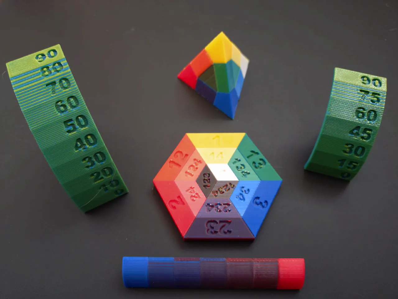

I own an XL and tried this with the (ugly) default 0.2mm profile from OrcaSlicer.
The blue isn't true blue, it's blue/white alternances, as for the grey that is black/white.
The critical part is to find a way to "easily" get and feed your filament specs, because the color blending can be way out of spot.
This attempt's results is more a less something like the "Chicken 1.0" from the authors.

I think that turned out pretty good for a trial print! Certainly nice enough to give a friend or kid as a gift. I would recommend trying one of the Biqu TD1 meters recommended by the Hueforge folks. My friend with a U1 borrowed my TD1 and found it so useful he bought his own. 🙂 The RGB values can be rather off (especially for violet) but that is easier to guess and check on screen than the transmission distance.

Am I correct to assume that this color mixing only works (well) on pretty vertical walls? The more slanted or rounded an object becomes, the wider the stripes of the primary, non-mixed colors will be, right? And horizontal surfaces must always have one of the available primary colors.
So how is this used in real-world objects? Print the main body in a primary color and add some "decorations" (with close-to-vertical surfaces) in mixed hues?
