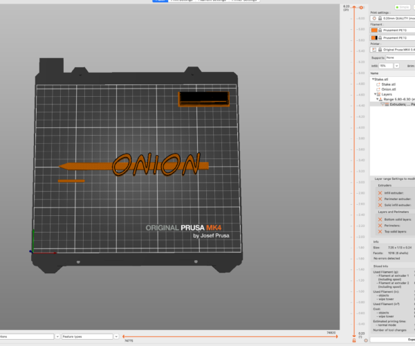

Please Read the explanation before you reject the idea...
set your printer up as a multi material printer (whether you have an MMU or not... )
set up your normal colour changes (See attached examples)
then use a height range modifier to change the external perimeter filament extruder to the perimeter colour that you want
If you actually have an MMU, use the attached .3mf file for the MMU Version, the MMU Should sort the colour change out for you
If you don't have an MMU, use the attached .3mf file for the Manual MMU Version.
it doesn't matter what colour filament you have loaded when you stary the print
the printer will heat up, start the print and ask for a colour change, remove the old colour and insert the first colour (Orange, in this example) when the extruder squirts out the waste filament, hold onto the filament but DON'T Pull it off...
when the new colour is extruding properly, press the LCD Control to confirm the colour is clear...
the printer will move the extruder back to the print, extruding a little squirt of filament as it moves. this extra filament will remain attached to the filament that you are holding, and break away from the extruder.
the printer (In this example will print the orange base) when the printer comes to the base of the text, it will request a second colour change, repeat the normal colour change procedure, (Changing to Yellow, in this example) and when the colour is clear, hold onto the wastepile again. and accept the colour change...
the printer will now print all of the Yellow sections, then it will ask for another colour change (in this example, change to Black) when the colour is clear, hold the waste, accept the change, and the printer should move off and complete the Black outline...
I hope this makes sense when you look at the examples.

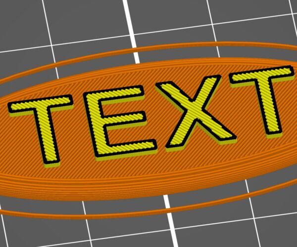

the printer will now print all of the Yellow sections, then it will ask for another colour change (in this example, change to Black) when the colour is clear, hold the waste, accept the change, and the printer should move off and complete the Black outline...I hope this makes sense when you look at the examples.

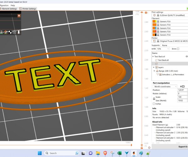

Thanks for the lengthy explanation. However, some of it is over my head as I am a novice user. I only have one extruder so I am following your manual mum version. If I wanted the base and text to all be one color and the outline to be another color (essentially 2 color changes). How can I go about that?
Essentially you define backgound, outline and fill as three different parts, how depends on the software you are using for the design. I have a maker's plate to print for a boat - only two colours this time but I'm using the boatbuilder's standard text logo, scanning it and converting the .png with OpenSCAD - most CAD applications have a similar ability.
currently the base oval is orange, and the text is yellow,
If you want it all to be orange with the Black outline, look in the right hand box, the Text Test element is currently set to the yellow filament, click on the yellow box, a couple of times, and It should offer you a selection of colours, simply select orange .

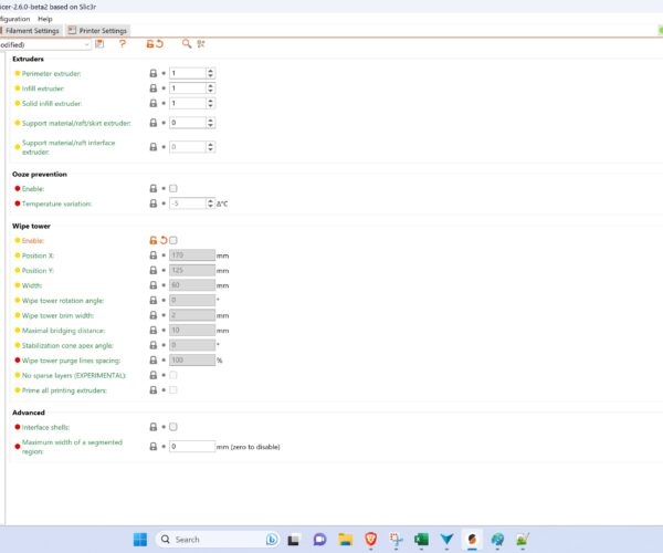

Alright, so after playing with it for a few hours I've gotten this far. However, whenever I select the 2 extruders I get this weird box on my preview in the top right corner. I've tried to delete it but it wont allow me to. How do I get rid of it?
RE: How can I do a color change of just the outer perimeter of text
the weird box, is the purge tower that you get when you use an MMU. the MMU dose not have a human handy to take the waste material off printer during filament changes, so when the printer finishes one colour on a layer, it moves to the corner and wipes it's extruder whilst it purges the old colour then it back feeds the old filament and advances the new filament, then the extruder wipes the mixed old and new filament onto the purge tower, before continuing to print.
when you use MANUAL MMU, you can turn the purge tower off. it's in print settings > multiple extruders
for manual MMU you also need to insert M600 into the print settings>custom Gcode> tool change section
this causes the slicer to insert the M600 code where colour changes are required .
