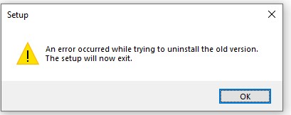

When I run the 2.7 installer on Win10 I get an error that it can't uninstall the old version and exits.
And when I try and uninstall it I get an error that the account already exists. And then rolls back.
What now?

I went into Settings > Apps, on Win11 and removed the Prusa Slicer App.
might work on win10

The 2nd error I posted is from the uninstall process. Ultimately I had to hack the registry and delete some keys.
Pretty sure I opened an issue? I see the same issue has been submitted by another person as as well, with no fix.

For the time being, 2.7.1 is running on my machine. I hacked the registry keys out, and installed the standalone version. The Full Installer still through an error. So I suppose yes, for the time being.
