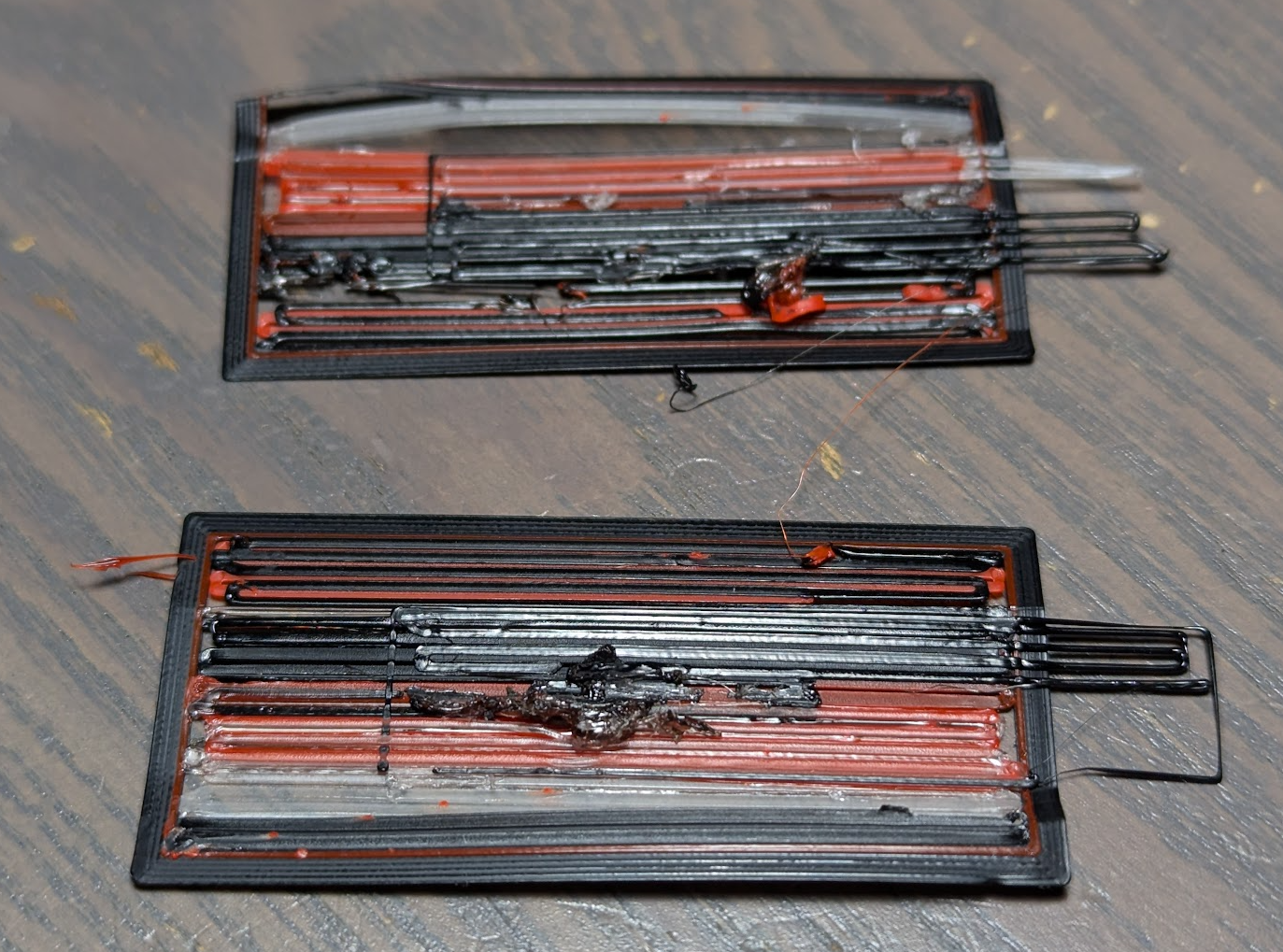

MK4s w/ MMU3 on latest firmware and PrusaSlicer versions as of today.
I have this default profile selected with no changes:
This shows 250 for 'Extra flow for purging' as the profile default (no orange indicating changes):
Mouse over that item and you see the default value should be 100%:
And when I change to 100%, you see the orange highlights:
Am I misunderstanding something here? I feel this 250% contributed to blobs which which caused x shifts causing failed prints due to collisions with this extra blob.
Thoughts?

Yes you are misunderstanding the tooltips.  They have absolutely no connection to things that are default or standard  within a profile.  They are pure text blocks, most of them left over from years and years ago.  The occasionally get updated but even then they are the same for ALL profiles as they are code dependant.  Never go by the suggested values for a lot of them as they mean very little.

However on the Prusa Slicer github this question has been raised before, for example https://github.com/prusa3d/PrusaSlicer/issues/4327 particularly rtyr's reply here https://github.com/prusa3d/PrusaSlicer/issues/4327#issuecomment-638420970   should be enough to prove my point.
As to it would be easy, well I suspect that would be A LOT of code refactoring and I can't see it being done in the next 100 years given the amount of time some of the actual relatively simple fixes have been open already.  By all means submit a fix though.  It open source afterall.

Sorry to revive a dead thread, I have been dealing with the same issue on wipe towers for over a month, dealing with Prusa support separately. I have been dealing with what I thought was a simple 3 color MM print, but it keeps having the same wipe tower issues where it starts oozing too much, then causing collisions and shifted layers.
I found this setting on my own that you referenced and dropped it from 250 to 125 and seem to have significantly less issues at the moment. I'm keeping a close eye on the print as I have already wasted about $60 worth of filament at this point trying to reprint this model with different settings to figure it out, broken parts while trying to tune it, spent countless hours on the chat with support... But thought I would share when I saw the exact same thing happening that I am experiencing.
