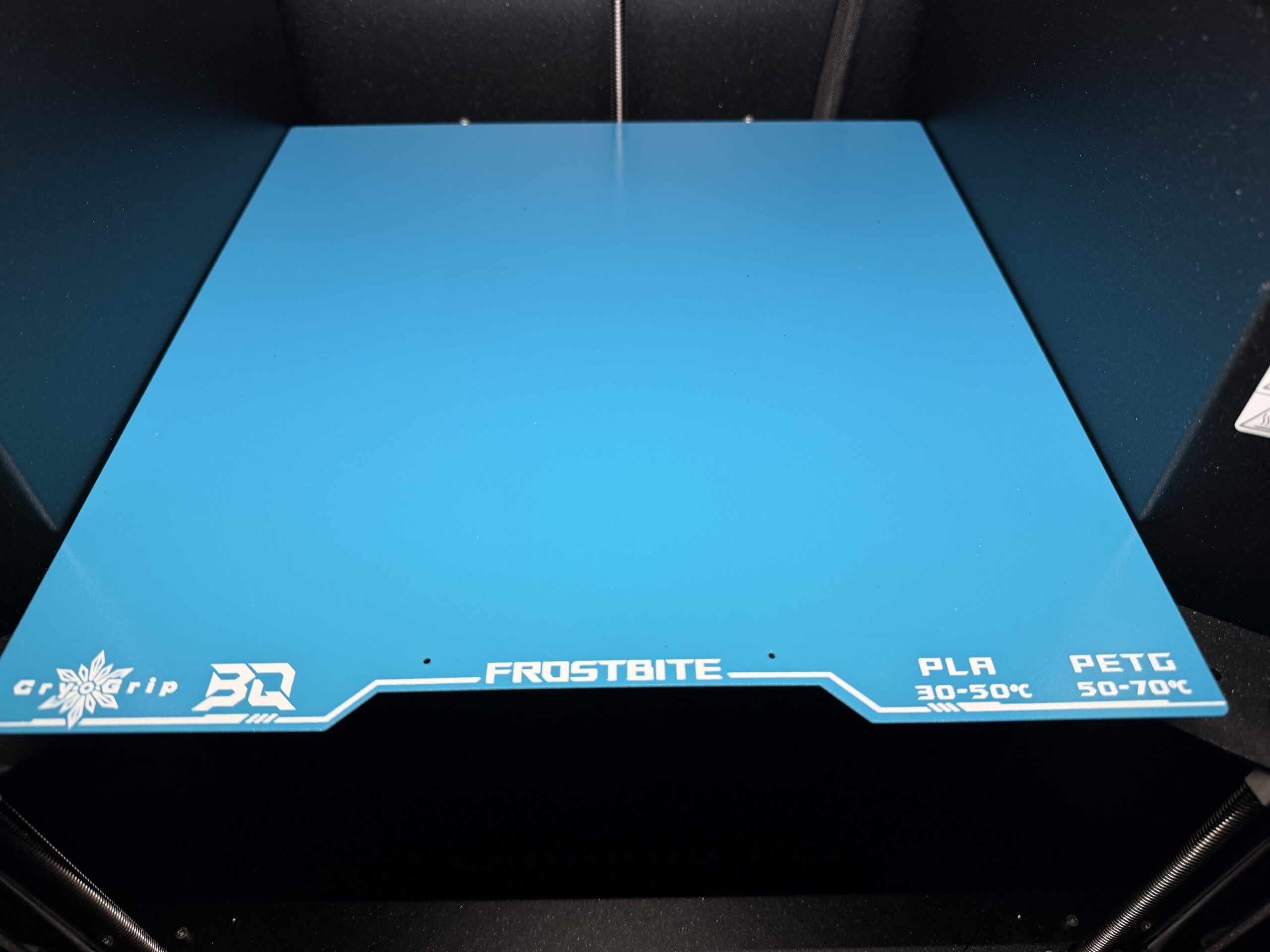

In case anyone is wondering, the "300x300" mm BIQU Cryogrip Pro Frostbite for Voron 300/QIDI Plus4 fits on the L - but barely.  You have to carefully position it slightly biased to the left so it doesn't contact the spool holder screws.  But it's another build sheet option (I really like these for PETG and PLA on my other Prusas).

Any chance of a picture showing fitment?

I  guess you would be able to remove some material on the right side where the screws are? Seems like a few minutes with a dremel?

Thanks 👍
Does the C1L just do bed probing as normal when using this one?
Posted : 04/12/2025 4:55 am
darksharpie
(@darksharpie)
RE: BIQU build sheet - 300x300 compatible
Yes.  No difference I can tell from the printer's perspective.

Since the Biqu Glacier Pro is my favorite. Everything sticks like an frog on glass on it.
I ordered one for an voron 300x300 and made the back indents myself.
Detecting steel sheet is just on the edge of one of the honeycomb holes in the front, but i think you can alter it in the g-code.
Fits like a glove.
I have to mention i have the side spool holder removed since i don't use it.
I put the satin sheet on top off this one (sideways in the middle) and with an very point thing scratched the blue buildplate.
Took and dremel and very carefully cut out the holes.
Applied some clear coat on the bare steel afterwards
