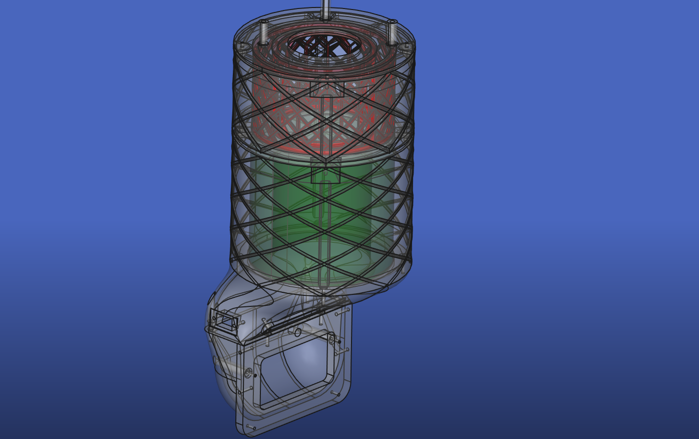

The remaining parts arrived, I finished the CAD and printed all the parts. The design is built around an "FY0611/30" filter (green in the CAD), which originally is for the "Philips Air Purifier AC0650 AC0651" models. I chose this as is seems to have plenty of area, was convenient in size, and lots of easy to source replacements are available. This covers the HEPA / particle filter section. The VOC part is done with a second stage activated carbon filter (red in the CAD). This is designed to be filled with standard loose pellets, which are really cheap compared to mats, and more effective. The Alevo3D BLHP2432-H24 is mounted at the very top, pulling air through the stack.
The assembly was pretty easy:
  • print all the parts (lower 2 parts should be PETG for heat and flex, rest can be PLA)
  • put in heat-set inserts for screws
  • pad HEPA filter with insulation foam, to create a seal (local hardware store should have plenty of options in the heating / plumbing section)
  • glue an "insect window mesh" to the printed pellet filter supports, glue both of them down to the mid3 section, add some foam padding to the top of the two meshs to seal against top plate
  • fill in pellets
  • add more foam to seal top fan intake
  • screw all the parts together and wire up Alevo3D BLHP2432-H24 to FAN3 connector on extension board
Then I did some quick tests to see if anything got hot: 100% speed on FAN3 and 100% speed on chamber fans. Let this run for a couple minutes and checked the mosfets on the board -> everything was quite cool, so this should be fine even under full tilt. The Alevo3D fan is rather on the louder side, about the same as the chamber fans on 100%. Judging by the suction (with closed chamber, air vents open, chamber fans off), it seems that it has way more power than needed. In fact the chamber fans start spinning at 800 RPM just from the suction through the filter 🤣
Next I did a quick PETG test print, setting the filtration to "Advanced filtration", and "Filter all materials", min fan speed 10% . This seems to work like the change log suggests: the chamber fans are off and the temperature regulation is done with FAN3. From this one test however I had the feeling that it was running the FAN3 quite a bit harder than it would need to, (mentally) comparing the air throughput to the chamber-fans-only setup I previously had. This would make sense as the stock "Advanced filtration" fan is probably quite a bit less powerful than the 30W Alevo3D one.
Will run more prints in the coming days, and come back with more info.
