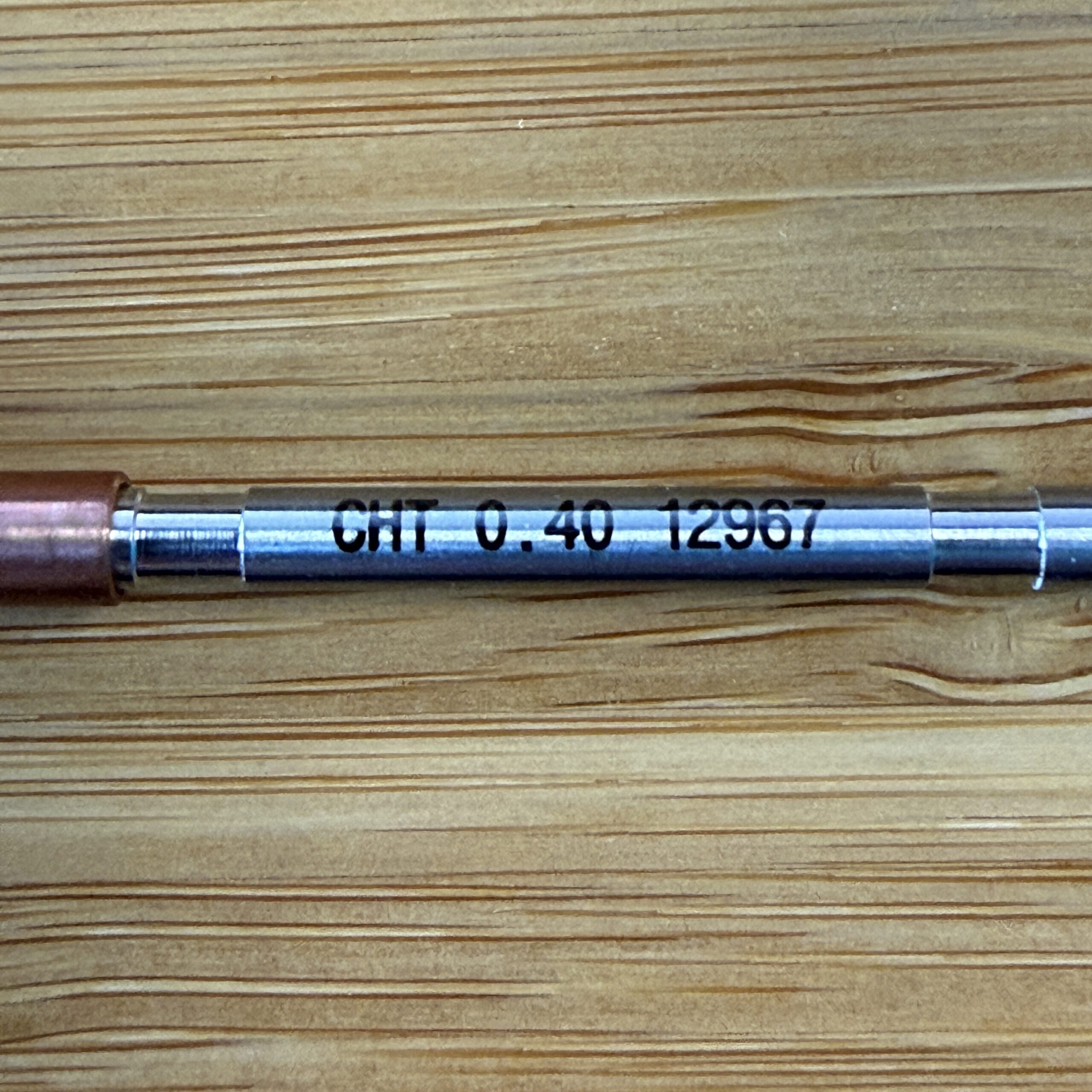

Yep! I think you uncovered it, getting mixed up with High Flow setting. To be fair, Prusa's listing for the nozzle doesn't specify flow rate, but I bet what happened is the first time I tried to install it, I wasn't sure and google searched, and it likely brought up E3D's listing which says high flow, not realizing there were both standard and high flow options. Combine that with the fact that PrusaSlicer's default nozzle profile says it's HF, it made sense to me that it would also be an HF nozzle. Thanks for connecting the dots for me!
Question is, is the stock 0.4mm Core One nozzle actually High Flow? I haven't had any issues with that nozzle.

my core one shipped with a HF 0.4 mm nozzle, so yes. But if in doubt, just take it out and look for the letters "CHT" that indicate "Core Heating Technology" by Bondtech => Prusa's "HF"
Posted : 19/10/2025 7:01 pm
Azonic3D
(@azonic3d-2)
RE: Layer shift again?? This is getting frustrating
Yep, says CHT. Thanks for the insight!
