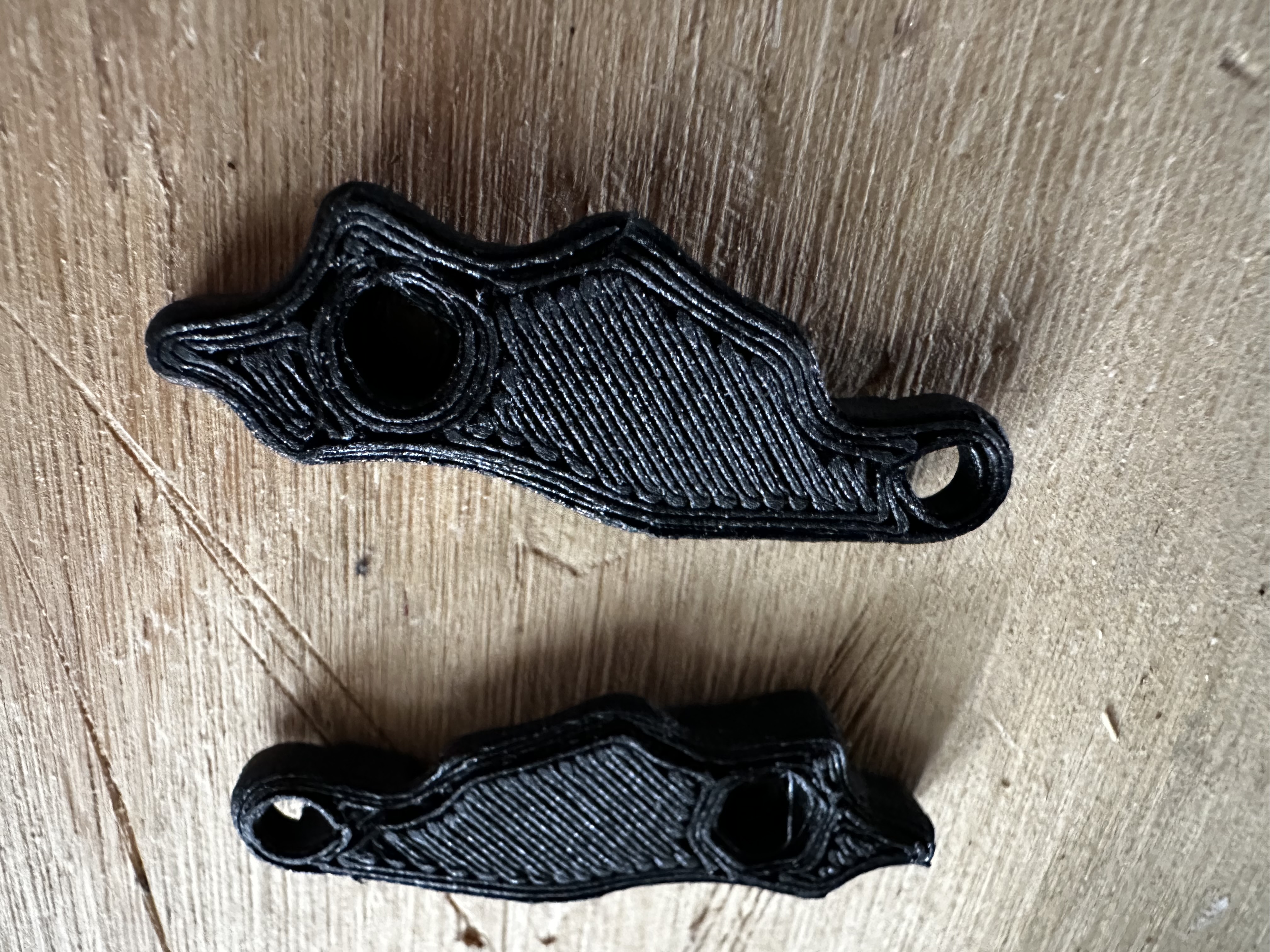

First Layer Issues
Any ideas on what would make first layers look like this?
Ive calibrated a PET-CF profile that prints fine otherwise, but the first layer on some of these C1 upgrade parts just doesnt look right.
Generally, what setting affects this the most?
Posted : 20/06/2026 10:24 pm
Make certain the nozzle is clean at the start of the probing procedure - if there is any oozing included fibres/particles can prevent accurate sensing.
Posted : 22/06/2026 5:10 am
Posted by: @ponch0v
PET-CF is very hygroscopic. Make sure the filament is thoroughly dried before printing.
