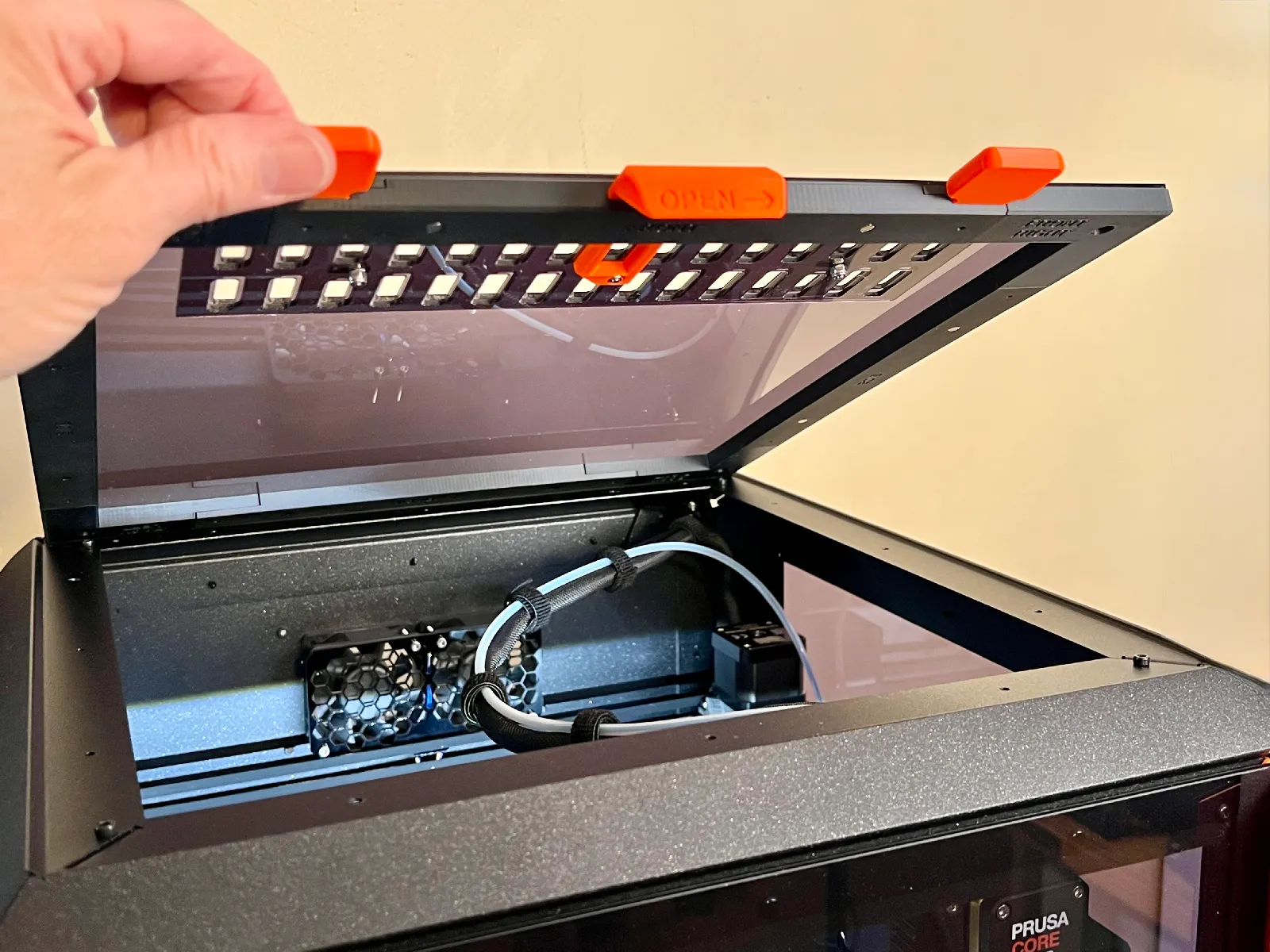

I finally managed it to insert TPU (Forward AM Ultrafuse from Prusa) and print a little bit.
I had to disconnect the PTFE from the extruder and manually feed the filament through the sensor.
For this I have first changed the top cover with this tool - I can really recommend it: https://www.printables.com/model/1226383-prusa-core-one-magnetic-top-cover-with-integrated
But when I print something more than a filament sample, after maybe 20 minutes or so the printer stops and asks for filament change. It then is not able to feed the filament through the whole extruder block. - I think that might also be because of the long way from the (Polymaker) dry box through the PTFE and into the extruder.
My next try will be to let the top cover open and somehow place the dry box that it can direclty feed to the extruder ... maybe that helps ...
