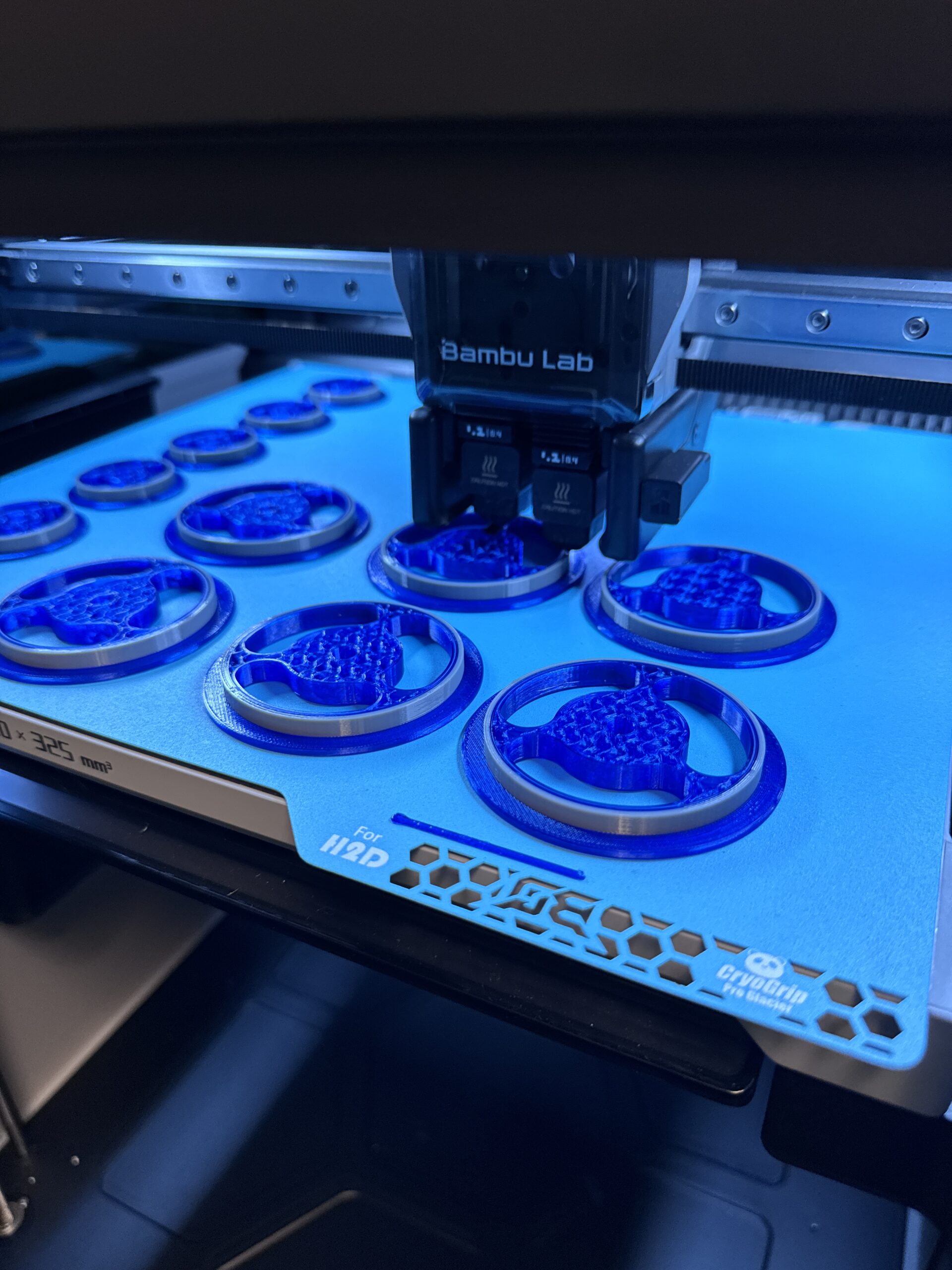

GBMaryland
(@gbmaryland)
This is an example of what I was talking about… and with INDX this will actually be possible. Whereas with my core one, before I sold it because of my complete and utter dissatisfaction with the MMU3 and the horrible support from Prusa, this type of printing was completely impossible.
(and yes, I did attempt to get the military to blow it up… And they were willing to use 100 g of high explosive… But the university was unwilling to risk their high speed camera… I was THAT annoyed with support….)
