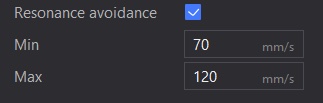

Posted by: @chris-hill
I've read that Qidi have a user-configurable slicer option to avoid the speeds that cause belt ripple resonance.  Their Plus4 seems to be well regarded with respect to VFAs.
You can set these things in Orca Slicer too. There are already some Core One profiles, but I only played around with a Nightly Build of Orca about 6 weeks ago.
Prints were worse due to non-optimised settings, but I tested the resonance avoidance settings and "don't slow down for outer walls" for a few smaller prints and the printer was definitely not hitting the resonance speeds as much as with Prusa Slicer, although slowing down layer times dynamically, not reaching the set speed before deceleration etc.
Also, the surface was nicer, since it always kept the full speed for the outside perimeters and instead slowed down more during Infill etc.
Sadly, retractions, seams, extrusion multiplier etc. would take quite some time to dial in and I didn't have that time available.
Definitely worth a deep dive! The only downsides I experienced were:
- only Prusa Link is working, not Prusa connect
- you can't see the "actual" speeds and flow rates after slicing, which I'm using to optimize surface quality quite a lot. I forgot if you could export the Orca G-Code and then see the "actual" values in Prusa's G-Code Viewer.
Posted : 19/07/2025 2:15 pm

Posted by: @raaz-2
The negatives you mentioned are why I'm hesitant to move away from PS, but PS is in desperate need of that feature IMO.
Posted : 19/07/2025 2:35 pm
