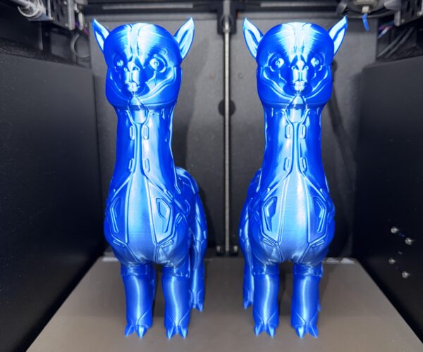

Oh, and to follow up with my post above on the VFA test tower:
- Prusa assembled Core One
- Belts tightened via new web app to the exact Prusa specifications
- Firmware 6.3.4
Honestly, I think the test tower makes it look a little worse that it appears... there is effectively no VFA on the very top few speeds.

Boris
(@boris-3)
I just tried the new Belt tuning guide, and for some reason my VFA's are much worse...
Left is with the new guide and right with the old lower frequency.
Printed at 120mm/s (the worst speed for VFA).
This post was modified 10 months ago by Boris
Posted : 18/07/2025 5:01 pm

Posted by: @gbmaryland
Printing of Robo, alpaca to test VFA with new belt and firmware…
My apologies if I've missed a post of yours - new belt?
Posted : 18/07/2025 5:05 pm
GBMaryland
(@gbmaryland)
Posted by: @chris-hill
Nope... new firmware (6.34) and new belt tensioning procedure being tested.  The Alpacas were really just a test to see if VFA was horribly noticeable in a real world print job.  The two of them were for a Prusa supplied tweaked GCODE vs a normally sliced version to see if there was a function difference. (There does not appear to be...)
Then I printed the VFA test. (Yes, I did it all backwards...)
Posted : 18/07/2025 5:15 pm
I have found the same putting stock idlers on and testing with the new tensions and firmware. I think there will always be certain combinations of directions and speeds for each tension that cause the system to resonate unless they actively damp it in the motors, which would require an accelerometer, or some mechanical damping. The dream would be active damping but I don't think there's the processing power for that on the xbuddy.
