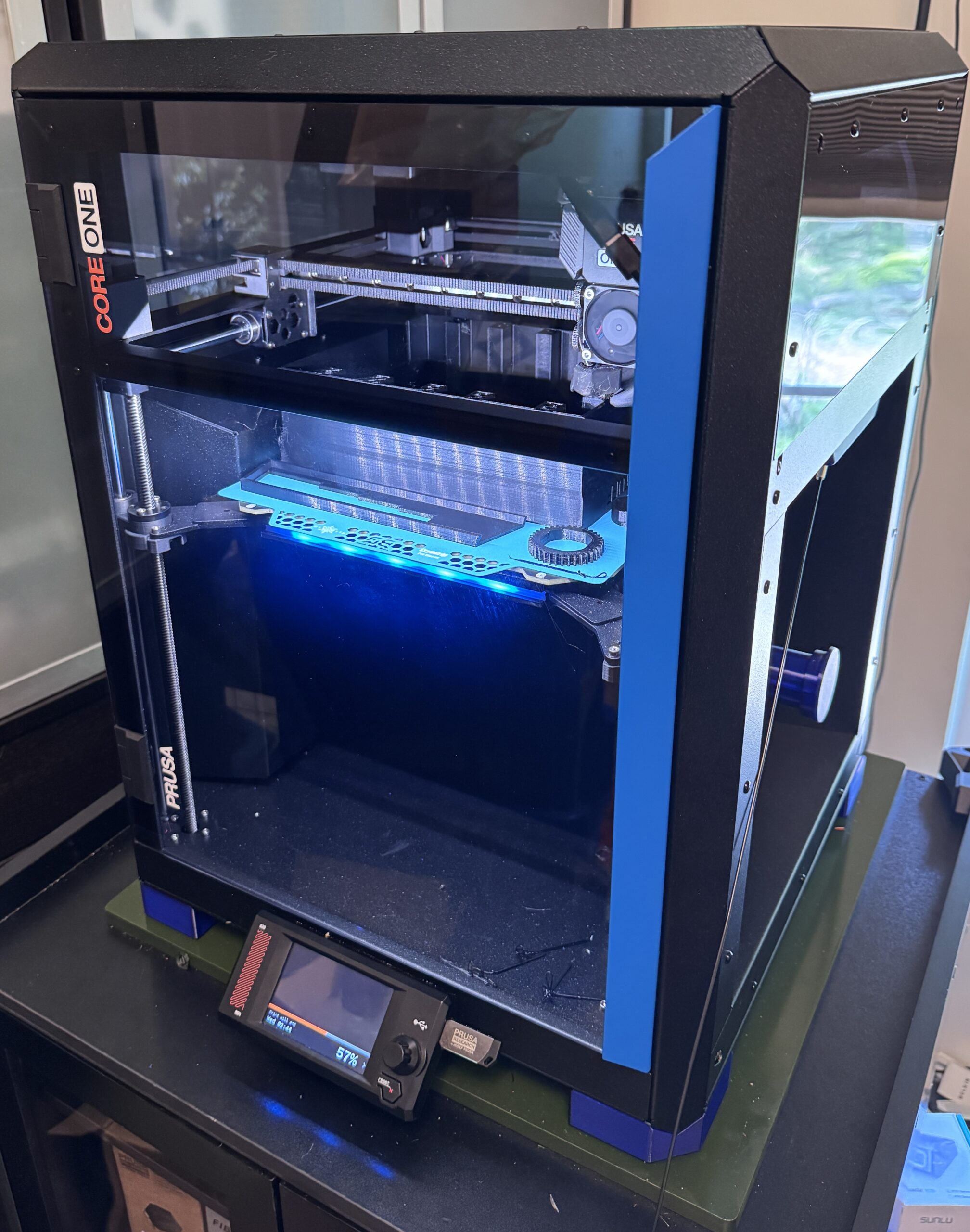

GBMaryland
(@gbmaryland)
Prusa Blue Core One Option
Posted by: @jurgen-7
What else do they have, besides a door that does not break (but instead may bend when it gets too warm) and the promise that "we are the good guys, trust us that we will not lock you in or otherwise abuse your data"? The latter was the selling point for me, but with hindsight I am not sure I still want to treat the "good guys" benefit for the general organizational incompetence they are exhibiting.
Well, they have the blue option…

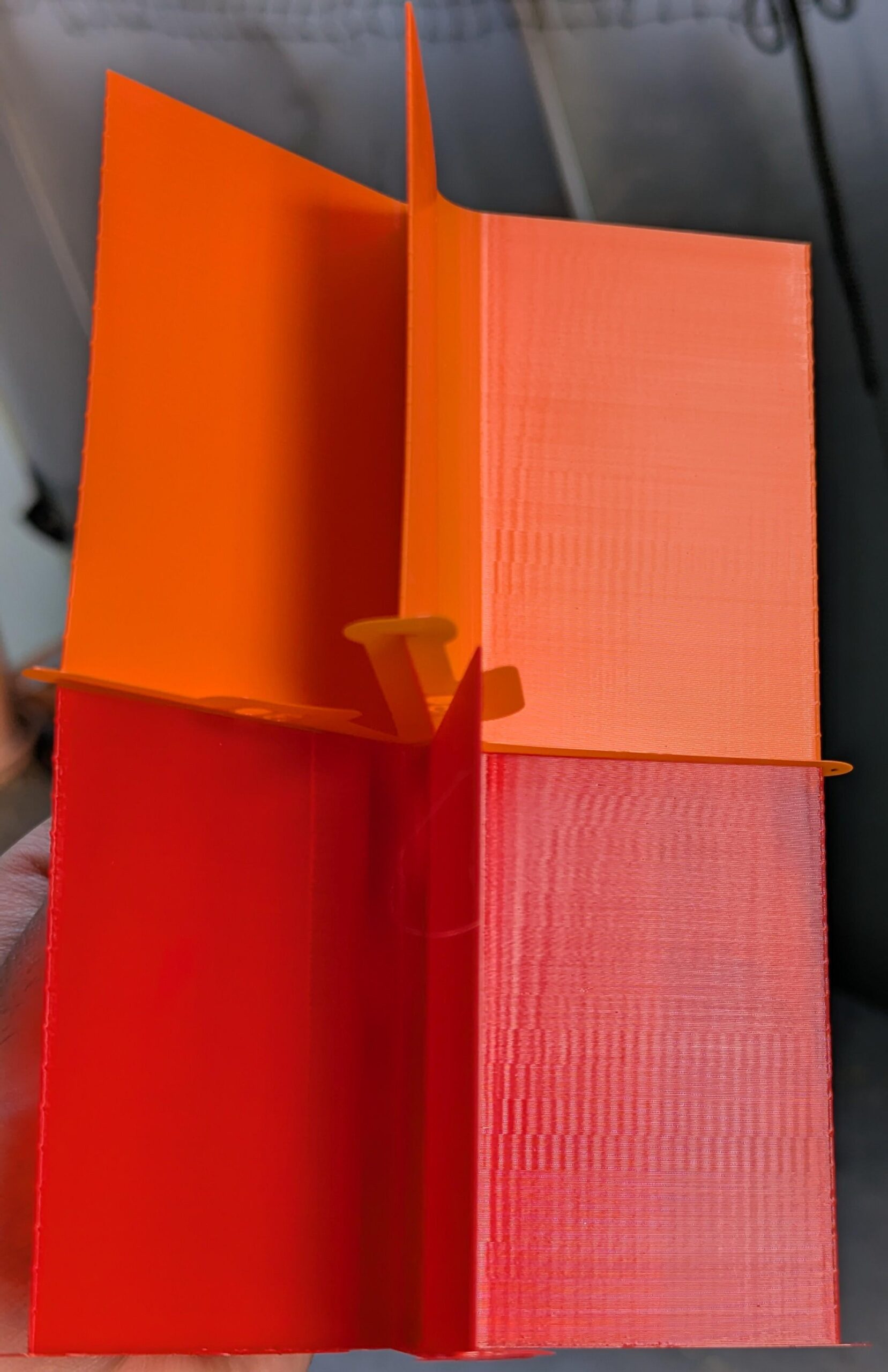

The mail arrived and I replaced both Prusa motor pulleys. The picture conditions (top = Prusa, bottom = Mellow) are a bit unfair because the orange filament is less shiny and the angle is not 100% identical, but it shows that I got basically zero improvement with the new pulleys. Visually they look almost the same, the Prusa pulleys are a bit less shiny and about 0.05g heavier. I'm not sure what to make of this. Buying tons of pulleys without a measure of what makes a pulley good isn't a solution, so I'll have to wait and hope for a solution from Prusa.

That's really sad to hear. Somehow that gives us one really positive experience and one neutral/negative experience. Would still be great to get more evidence from other printers.

That's the problem with Aliexpress type products. The QC is all over the place. You could order a set of pulleys that work great, then order another set that should be the same but were in fact made in a different factory on a different CNC machine and they will be worse than the stock pulleys.

The only time I saw this severe intensity of artefacts in the middle of this exact print, but not really at the top nor bottom, was when the motors were bad. Are yours resonating? How much? The fact the ripples don't align is also suspicious, normally they'd kinda elongate as you increase speed, but here they kinda shifted weirdly in the middle.
Either that, bad pulley lottery or your artefacts are caused by something else. Now I wonder by what.

Posted by: @nbu
Almost exactly what mine look like. I have to get above 250mm/sec to get them to kindasortamostly go away. I've printed as slow as 25mm/sec and still see them. I can use "fuzzy skin" in the slicer with 0.1 thickness and 0.3 point distance and still see them a bit.

Yes, around 80mm/s the printer gets quite loud. I tried the 6.3.3 version of phase stepping and it worked to some degree in reducing the noise, but the calibration failed multiple times or gave me wildly different results. I reverted to hopefully try again with a more refined algorithm.
I have a second set of pulleys from Mellow, so I could verify whether that makes a difference. The item description said that I was supposed to receive an allen key with the pulleys (which I didn't get), so I'm not sure if it's "original". The packaging stated Mellow as the brand.

Thats some extreme VFAs, i only have some visible for the first lower 1/3 maybe of the height, then they dissapear for the rest of that VFA-test print.
