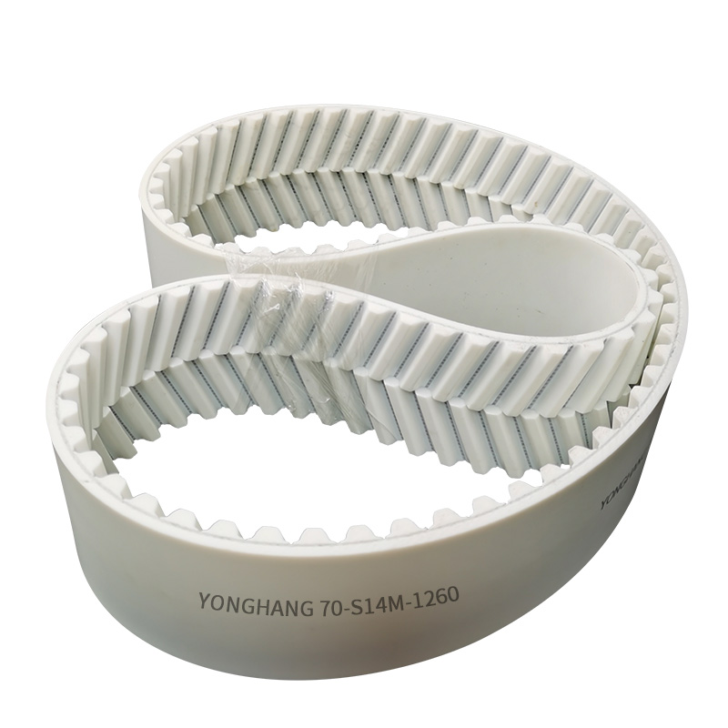

Kachidoki
(@kachidoki)
Posted by: @shushuda
Also Josef didn't state they don't see it in that Reddit post. He stated they don't see it at such a severity. Which leaves possibility they do see it and just don't care or deem it "normal for coreXY, nothing to do here".
I can understand that. I myself wrote reviews for the MK4, MK4S, XL and CORE One and clearly noticed the VFA issue on the CORE One during my first Jet Black PETG print with straight walls. Now looking back to the XL, I can now see them too but I never noticed them before. At the time of the XL test I only noticed that the print quality was either better on the XL or the MK4 depending on the object. Now I know why.
A stupid idea I got while reading all the exchanges around the pulley and belt pattern matching, would it be possible to do a simple test by flipping the belts? Even at slower speed to avoid slippage. The idea behind is to confirm or not the pattern influence. The ideal would be to have non-toothed pulley too, but seems unlikely.
To go further, trapezoidal pulleys also exists (maybe not at this size unfortunately), with multiple grooves to improve contact area (easily doubling it). They can slip under severe constrains, but with good tension and well tuned acceleration it could do the job without any trace of belt pattern.
What do you think?
Posted : 24/06/2025 11:39 am
baztm
(@baztm)
I wonder about shallow toothed or even herringbone belts and pulleys
Posted : 24/06/2025 12:41 pm
