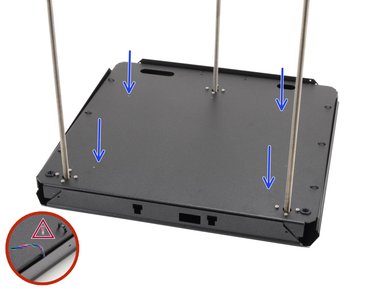

miroslav.h4
(@miroslav-h4)
Why are you printing all sorts of pads to the Z axis when the solution to this problem is simple? There is a threaded hole in the base near each lift motor. It was probably originally intended to secure the table with the print pad in transit. Screw an M3x20 bolt with a nut into each of the holes. Use the height of these screws to adjust the bed to the required position and use the nut to secure the screw. A dial gauge can even be attached to the extruder using a simple adapter and the bed position can be set perfectly accurately. Use the two screws at the front to set the bed in the XZ plane and then use the rear screw to level the bed in the YZ plane. Since you need to drive the table down to the stops and back up after each turn of the screws, create a simple text file and put two lines of commands in it. On the first line, put the command G162 Z; and on the next line, put the command G1 Z20; or any other value you are comfortable with. For example, name this file test.gcode and upload it to the printer as a print file. When you run it, the pad will go down on the stops and then rise up for measurement. And then just repeat turning the screws, running this print file, and measuring until you achieve perfect bed alignment.

Raaz
 Raaz
(@raaz-2)
RE: The bed is not leveled !!!
Posted by: @print_fandango-2
Can someone make a video of this? No idea what he is talking about
Core One Baseplate
Look at this image from the manual. The arrow in the bottom left corner of the picture is close to a little, bright, threaded hole.
The same threaded hole is close to the rear z-screw and to the other front z-screw (but the arrow hides it).
Use some M3 screws that are long enough and preferably a nylock nut, put the nut on the screw, then put the screw in the threaded hole and adjust the height.
Then fixate the screw in that position via the nylock nut, similar to the "nylock mod" for other print beds.
I'm thinking about doing this, but designing a little "bumper head" made of PETG to put on the screw heads.
