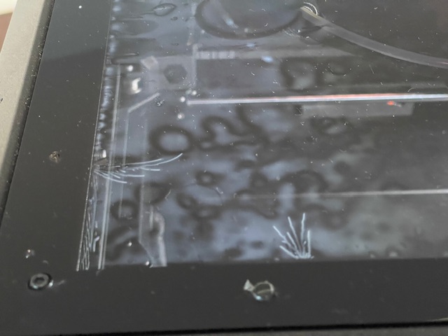

No problems since removing some powder coating from a single bolt under the x and Y motors. Ran many more prints today and it has been flawless.  Solved. But did want to share some static marks, or what I believe is from static, that were showing up on the top of my case. Static Lines
