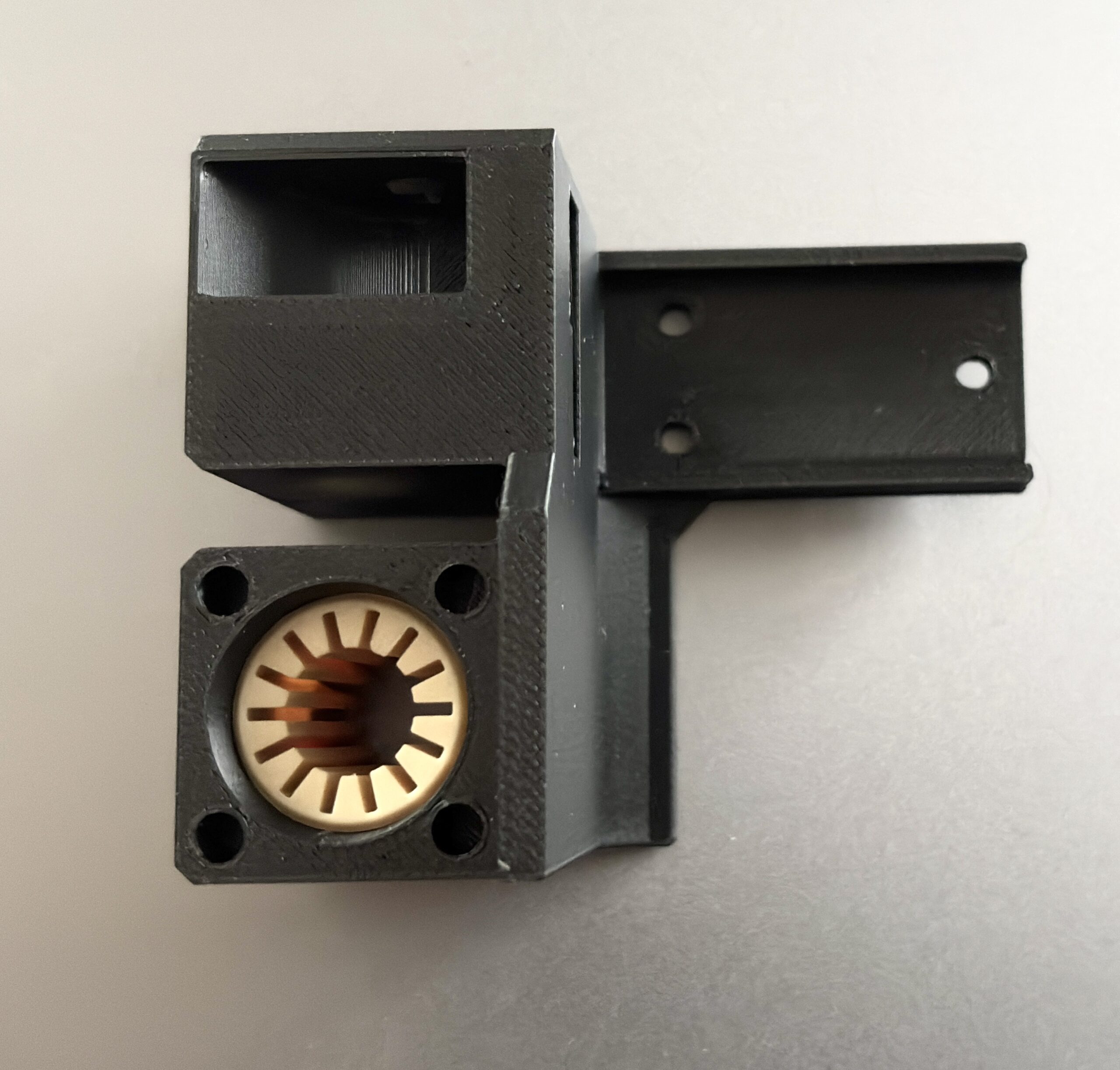

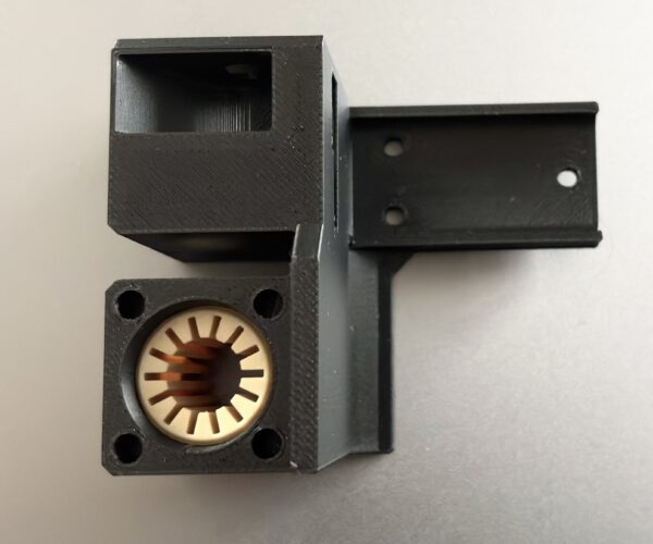

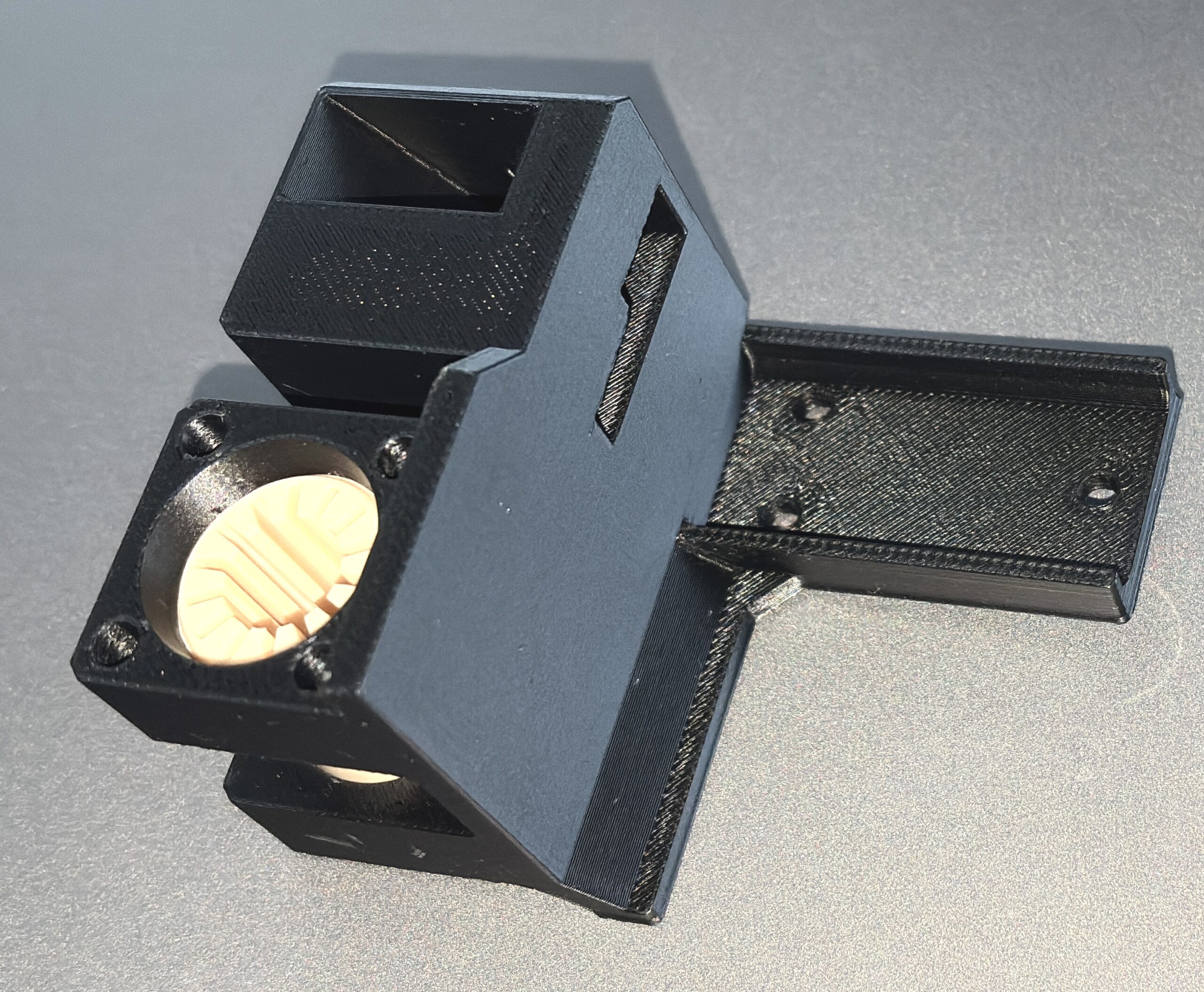

jan.d.slay
(@jan-d-slay)
RE: Gantry resonant mode and VFA artifacts
Hello everyone.
I have now read various topics in the forum and on the Internet and have installed a plain bearing in the Y-axis.
I personally find the result impressive.
https://www.printables.com/model/1602328-prusa-core-one-resonance-noise-eliminated-with-sli
Now I'm going to take a VFA test.
Posted by: @jan-d-slay
Nice! I am not bothered by noise (yet), but can't wait for your VFA results!
The Printables headline talks about "Replacing the linear bearings on the MK4S", which I found a bit confusing. Is that meant to refer back to an already proven solution in the MK4S? Still it might be better to mention the Core One explicitly right up there.
Posted : 15/02/2026 4:40 pm
Hello everyone.
Interesting! I might (attempt to) print these out of POM. If that doesn't work, I also have a roll of Igus i150 I haven't found a use for yet.
