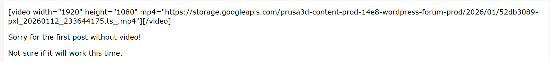

RE: Core One screams. Don't know why.
Hi JPMath,
the reason your video's are not showing, is because there is some formatting information surrounding the link address
See image below
I deleted the formatting data, and the link is now visible
Posted : 14/01/2026 4:38 pm
