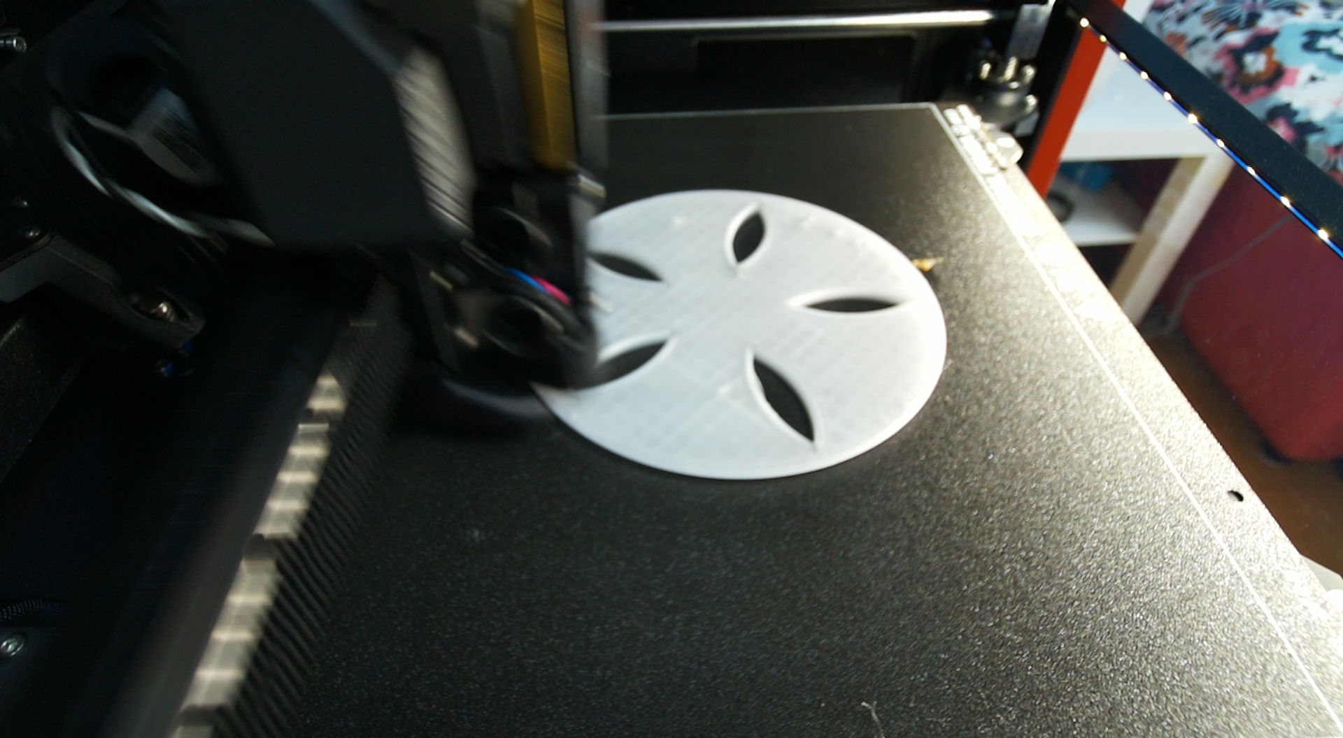

Thanks for the input, everyone. Once I got my printer I started hacking ways to get a Raspberry Pi HQ camera in there. At first I just rested it on top of the acrylic which gave me a live, yet shaded and usually obscured, view. Eventually I designed a frame to hold it with magnets on the middle of the left side (see pic). I tested this placement by moving the print head around with the camera in place. I have a long ribbon which feeds out the bottom of the side acrylic panel. I designed and printed a little shim to protect the cable from any vibrations of that panel, also held in place with magnets. I got a 3mm CS lens and got it focused to the hotend.
On the Pi, I used camera-streamer (like modern octoprint) and I modded the Pi to Prusa Connect Gist to do a curl on the /snapshot url instead of using libcamera-still to avoid "camera in use" problems. This way I can casually look at Prusa Connect or obsessively look at the /stream to watch the print head zooming around. I have the pi mounted to the back because I have the Skadis mod on the left side hallow space.

Can you share a pic of your current cable routing? Your viewing angle is probably better. I see the gantry a lot of the time, but it's enough to know a print is succeeding.
Here's mine, along with a print view.
