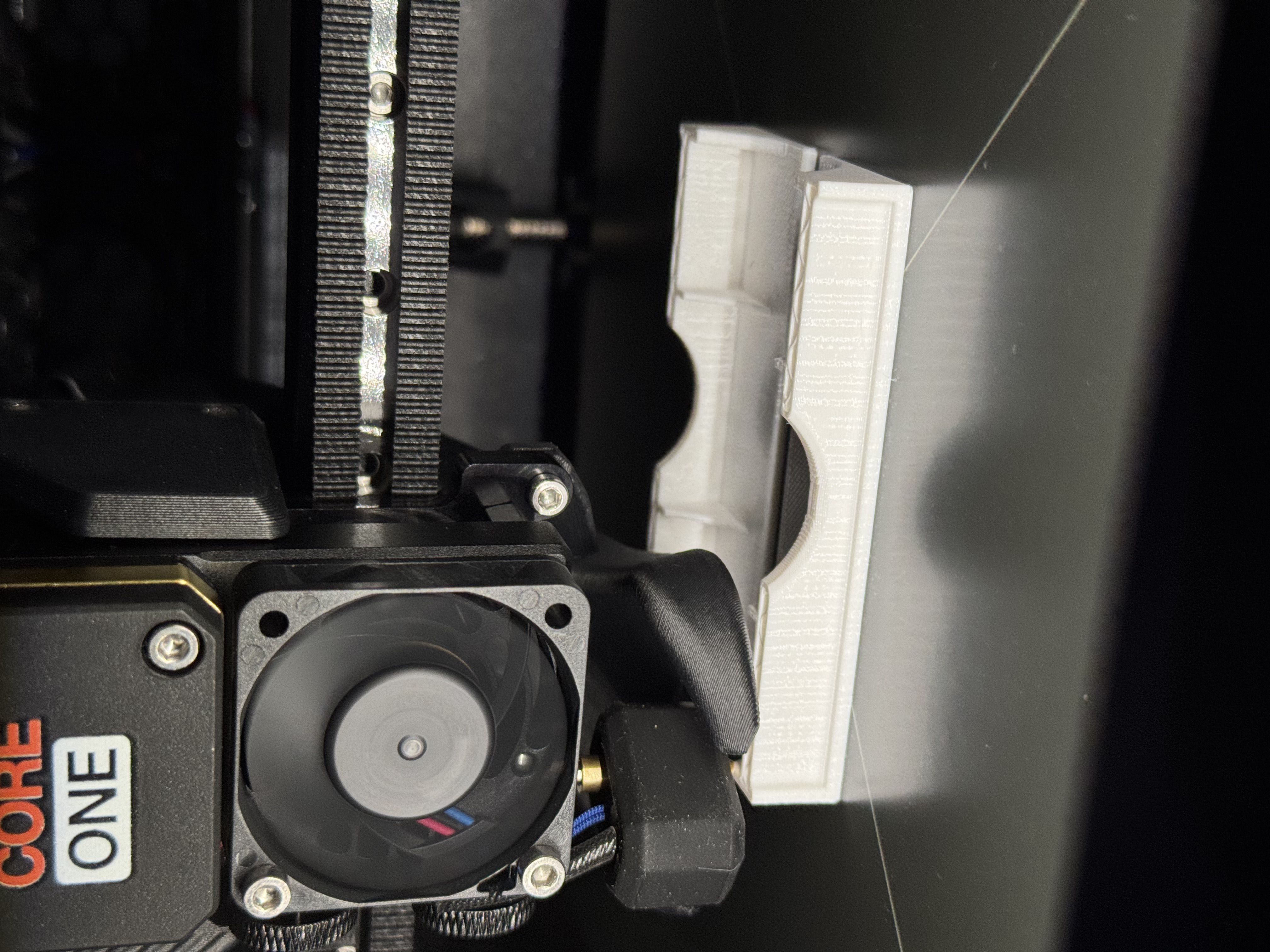

I got my Core One on Tuesday. Yesterday I noticed that it causes very strange vibrations at certain speeds, which sounds really annoying. Do any of you have the same problems?I will link 2 videos here and one from a user on Reddit. I asked him for permission to link his video here. Thanks for that.

I’m experiencing the same issue. It seems like certain frequencies are causing the metal frame to vibrate, which creates that sound. I did install the foam strips on the bottom, and I imagine it would be much worse without them. Do you think a firmware update could help address this? Maybe something similar to the noise reduction tuning on BL printers? It would be nice if Prusa could implement a fix for this.  All of my printers are in my workshop, but I planned on keeping this one in my office for prototyping. But the noise may interfere with online meetings.

My MK4S also makes that louder humming sound, almost as if it is hitting some resonance frequency once in awhile, but doesn't have the added sound of something on the frame rattling. Hopefully they have it worked out before I receive my upgrade kit.

I have the same issue / vibration on the x axis. The print quality on the x axis isn’t great either.
Could it be bad bearings or something misaligned causing binding? I have no idea
