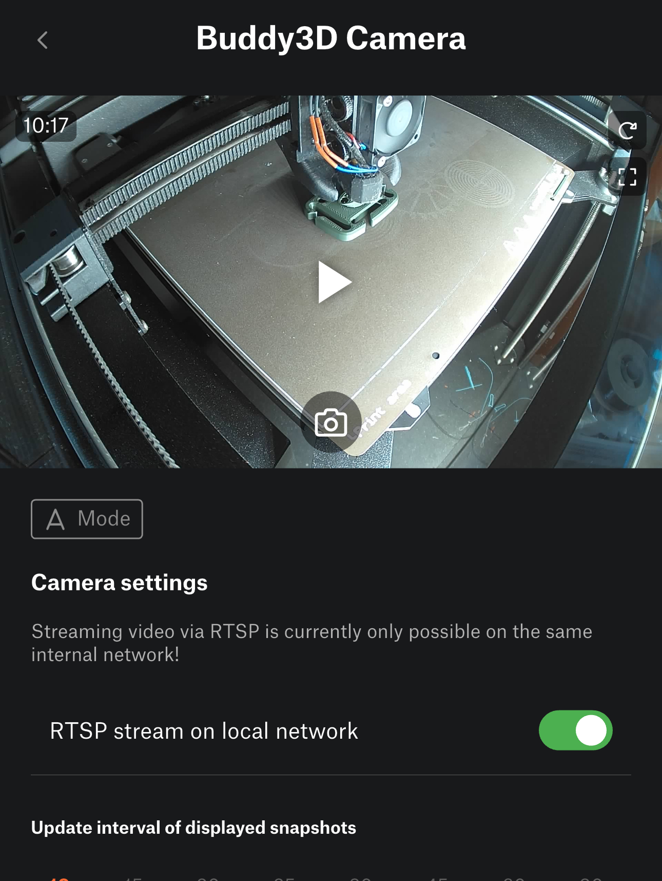

RE: Webcam App to instantly view Buddy camera livestream in Core One
How do you find the IP of the camera? Can you set it to be static?
Probably the simplest way is to:
  • if you haven't done so yet: Enable "RTSP stream on local network" from the Prusa app on your mobile device(!)
  • go to the "Prusa Connect" tab in Prusa Slicer
  • Click on the "Camera" tab within that (or the Prusa App)
  • scroll down the main view
  • Look at the bottom right below the camera picture
    • If you can't see the values on the right, click on the circled "i"
  • Press the copy button right next to the WiFi IPv4 address
There are many other ways, but they fall into "generic networking", like looking it up via your router webui etc., but this is the simplest.
Also, does it work only from local network or across the internet line Wyze and similar.
As I already pointed out: "Obviously, this will only work as long as you are on the same network/WiFi."
There are ways to achieve this, but they go way beyond the simple scope here, as they involve additional software or hardware. As is there is no such feature and the Prusa app tells you as much too: "Streaming video via RTSP is currently only possible on the same internal network!"
