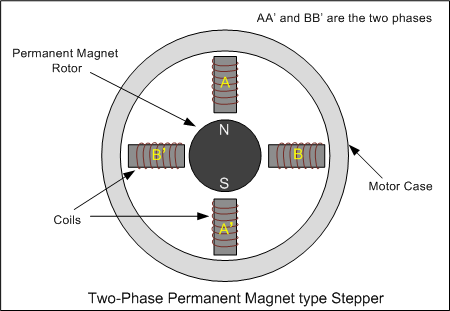

> But I'm certainly not an expert so maybe there's some good reason to use a sin wave instead of some other shape. Maybe someone can comment on that?
If you use the simplified model of one electrical turn is one mechanical turn, you would probably understand that sine and cosine are the ideal wave forms.
See here:
In the above, you can go full positive current through A, none in B. The magnet moves accordingly. Or full positive in B, none in A. The magnet moves accordingly. And you use trigonometry to get inbetween, just like in any coordinates system.
Posted : 21/11/2025 2:42 pm
