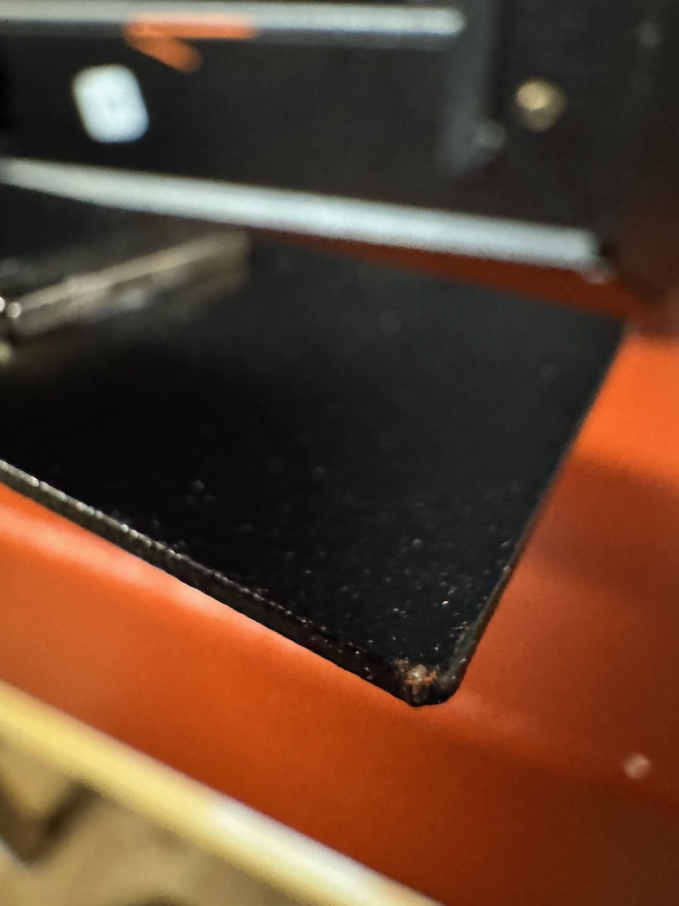

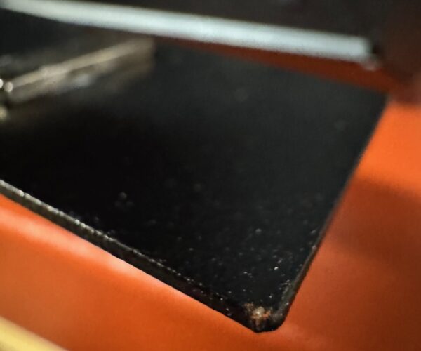

I also seem to have a rust/finish issue in the corner of the metal bracket to which the display is attached.

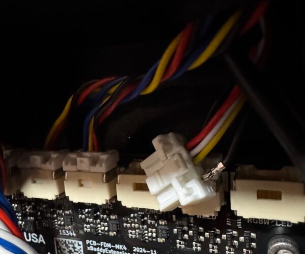

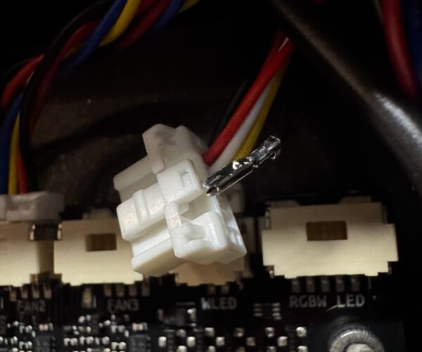

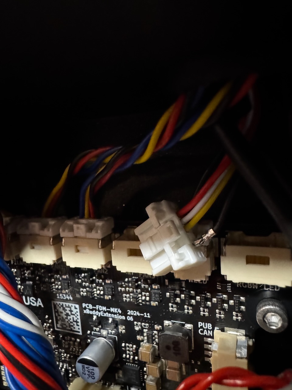

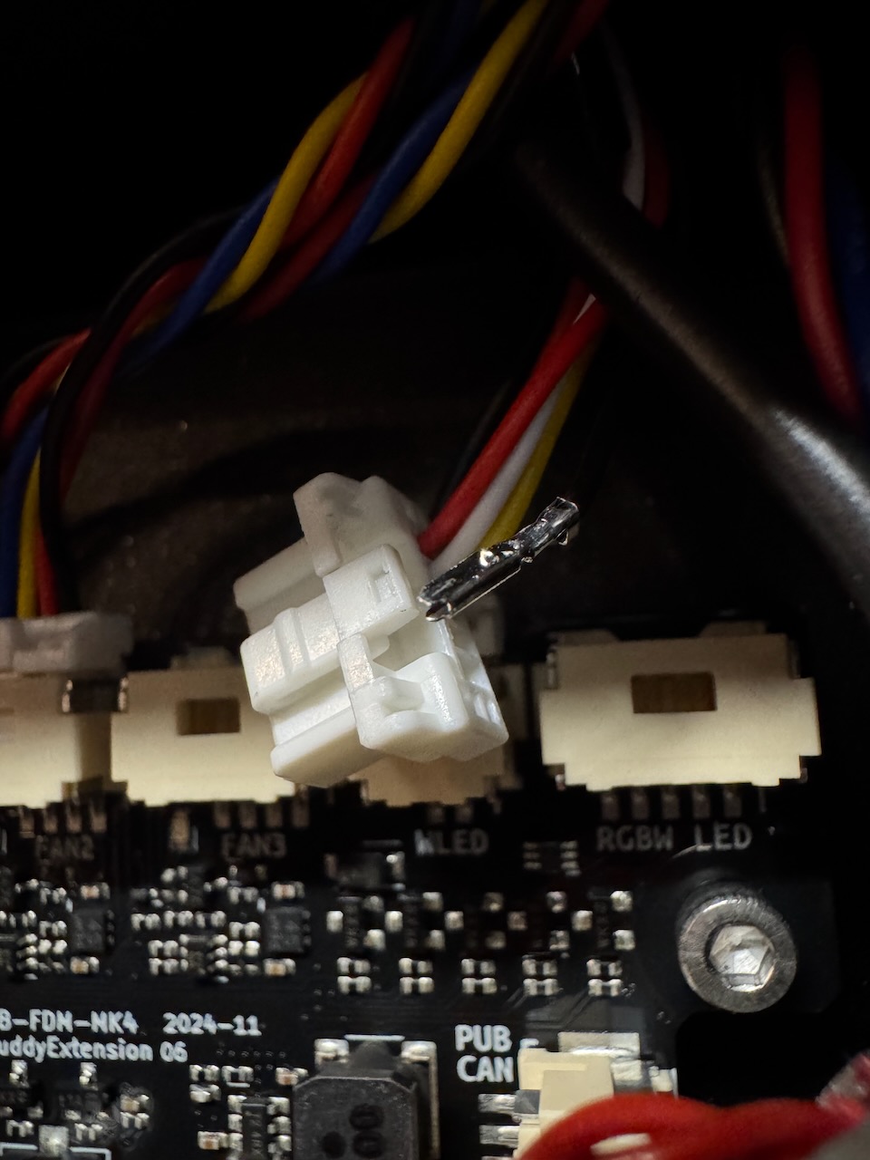

RE: found the problem
I found the problem. This is scary, and frankly, not acceptable at this price.
It's a 5-pin connector, so not sure which pin it needs to go into.
I am also not sure if the existing crimp is compromised - which is very likely.
Bonus pic of the rust spot:

RE: Prusa Core One RGB Strip Not Working
Try popping the he pin back in.  No real danger as all of those circuits are low voltage.
Either way contact support.

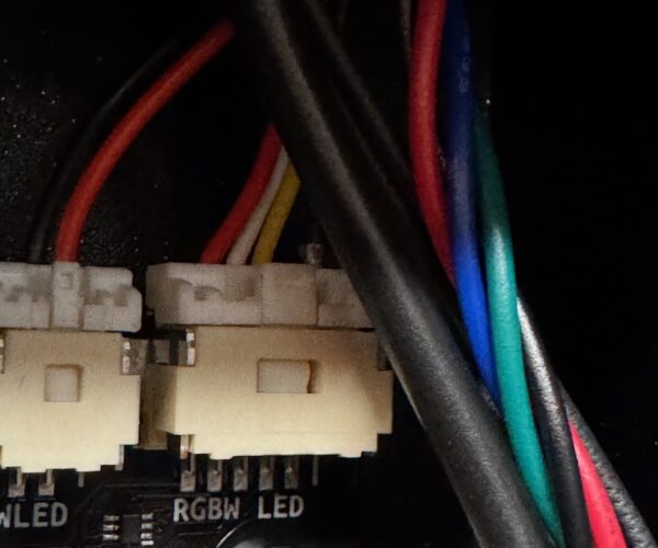

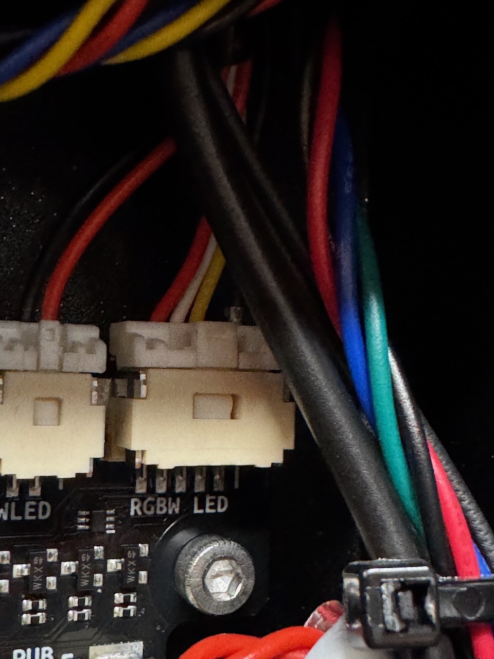

Posted by: @brian-12
I referenced the original photo, and figured not much harm "guessing" that the wire should go into the last pin slot. I put it back into the connector, which was tricky due to miniature size and short wire/cramped quarters, but it went in fine and it's secure in there--it passed the "pull test".
The LED bar lights up properly now.
I am more convinced now that the pin was never pushed in all the way during manufacturing. I could see the whole connector coming loose before those pins pop out.
I was never concerned about this particular connection, but rather some of the higher draw ones like the heaters etc. I checked what I could easily access and everything seemed secure. Another user on reddit reported having same exact issue with the same exact pin on this connector. Really weird.
