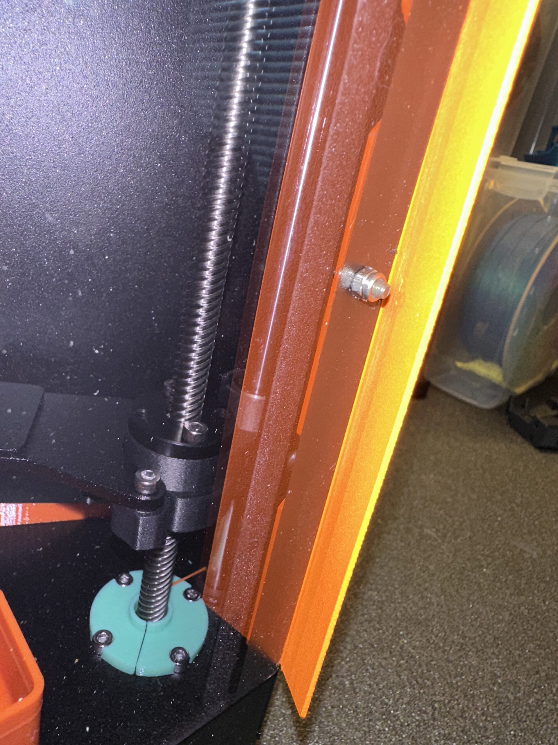

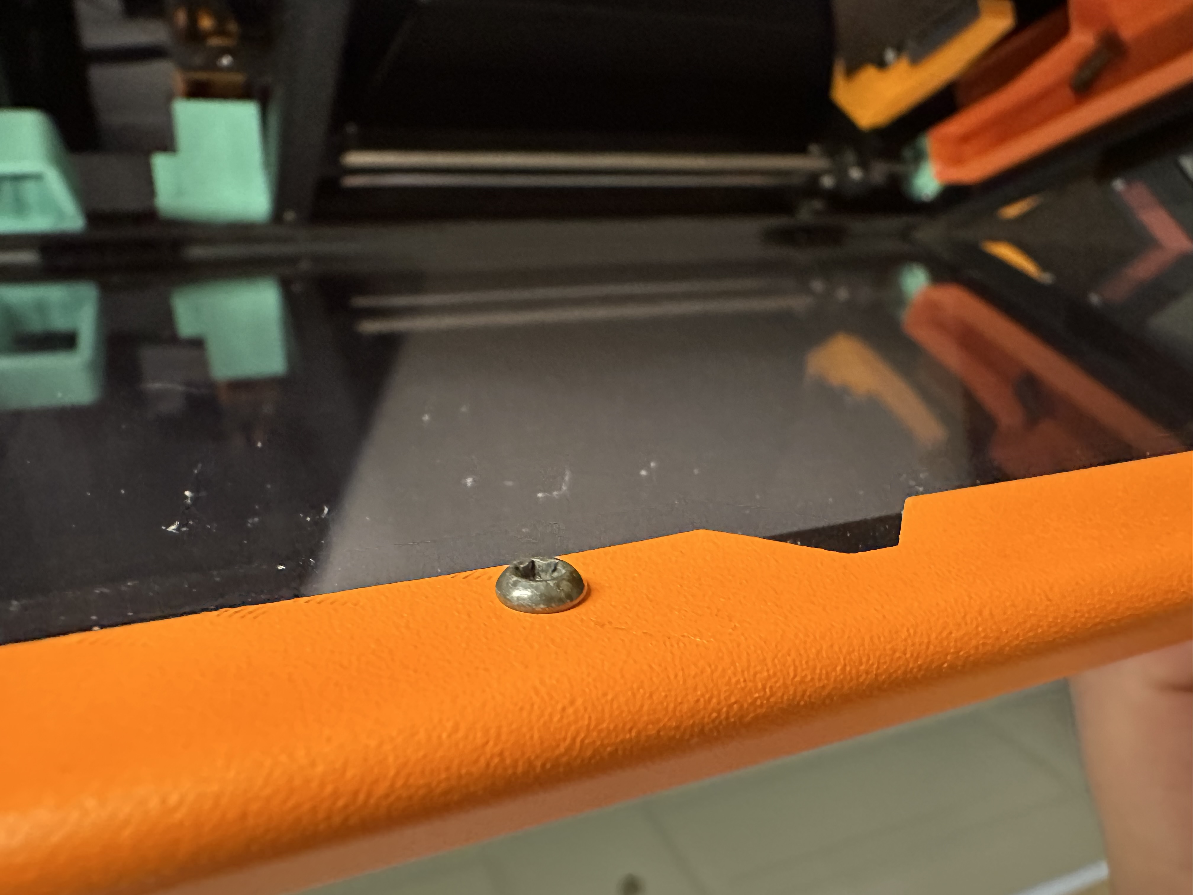

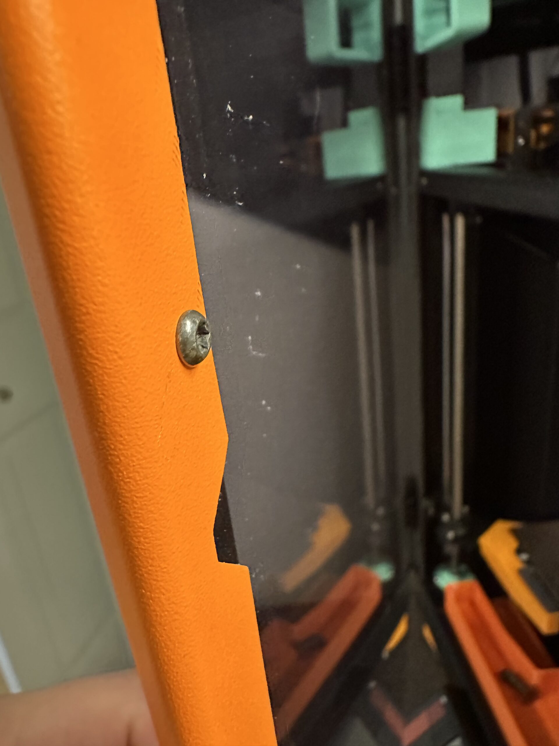

Regarding the door: I ended up removing the adhesive as much as possible then using M3x8 screws and those M3nN(?) nuts (the thicker ones that are rounded on one ended but hex in the other) to screw one the handle. the screws actually line up almost perfectly with the belt tensioning screw hole and some other one further down. The handle top and bottom are flush with the acrylic panel as well and align perfectly.
Based on the fact that the panel and handle screw holes line up perfectly, I wonder if that was the original intent of the design. The foam seemed like an afterthought, especially since it was too thick for me and actually interfered with the handle alignment
This post was modified 12 months ago by JingleMePringles

BTW regarding my door post, pics:
