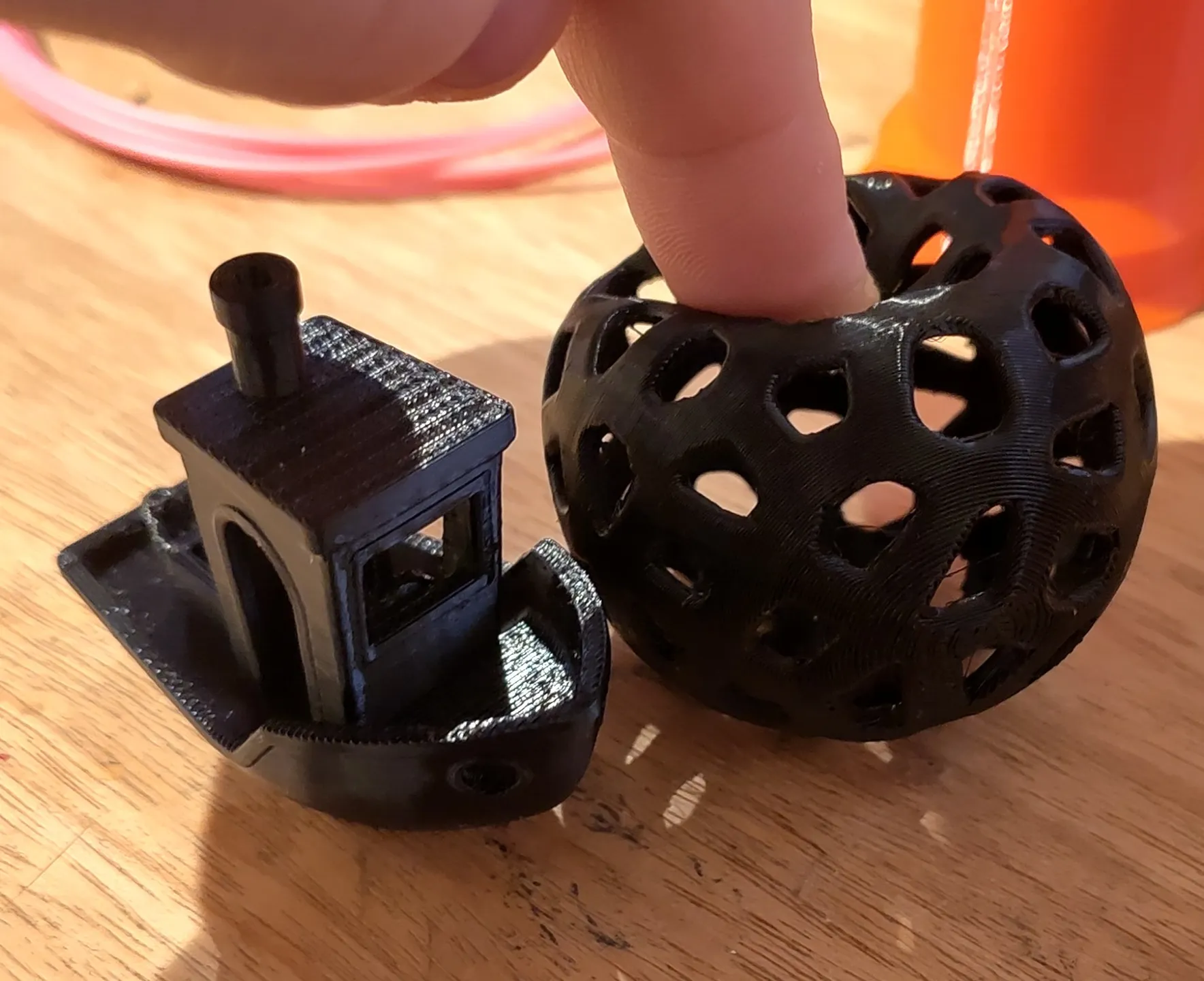

TPU printing part 1
Problem: No way to put my TPU (94A) through the side AND nextruder filament sensor.
Cause: filament sensors require high force to put filament through
Solution: Core one + Side filament sensor, for nextruder sensor I am currently removing the PTFE hose, push it directly at the extruder and reconnect PTFE tube. In the future, I hope this https://www.printables.com/model/1263406-nextruder-filament-sensor-magnet-mod will help so I do not have to remove the PTFE tube all the time..
TPU printing part 2
Problem: Occasionally, the Nextruder started clicking during TPU printing followed by a blockage.
Cause: Not really sure, tension of the idler was according to the instructions.
Solution: I had no problems anymore after using this idler mod https://www.printables.com/model/1072020-mk4s-bogie-idler-main-plate
TPU printing part 3
Problem: Bad TPU printing quality (especially overhangs and stringing), lots of oozing during initialization of the print.
Cause: Wrong Print Setting (I am using TPU V2 from Das Filament, no presets available)
Solution: Dial in retraction (1.5mm in my case), use the recommended temperature (220°C) and most importantly! very low Max volumetric speed (1.5 mm^3/s in my case). To prevent oozing, reduce the temperature during bed levling, nozzle cleaning,... by adding MBL160 (=160°C) in the filament settings under "Notes". I do not think that this is a printer specific problem, but rather a general problem with TPU Filaments to have the correct settings.
To conclude the "TPU" section, after tinkering around I am pretty satisfied with how the Core One prints TPU!

On the TPU side do you think the new Core One Plus switch would help?  I only printed the TPU with that installed and I had it turned off to allow for easier pushing to the nextruder.  I had no issues on the extruder side feeding the TPU in but I can see it being a problem on the side filament sensor.  That modification seemed directly related to creating a clear path to the extruder?
Posted : 03/12/2025 10:48 am
RE: My issues and solutions with the C1
Posted by: @pjs37
It depends on the type of TPU. TPU 95A and 64D are easy enough to print without modifications (i.e. get past both filament sensors). The softer TPU's are much harder to feed through Bowden tube and get them past the Nextruder filament sensor which is why the mods are needed. Also, for the softer TPUs there is a danger it can get wrapped around the Nextruder planetary gear which is a PITA to fix. The Bogie idler main plate mod linked above corrects this.
Posted : 03/12/2025 6:53 pm
samuel.l3
(@samuel-l3)
Posted by: @pjs37
Yes, the Core One Plus Side Filament Sensor definitly helped. However, I was not able (and I tried really hard, cut the filament in different angels,...) to push the filament through the Nextruder Sensor. Today I have installed the mentioned mod, now I do not have any problems with loading TPU! My filament is rated 94A, not sure why I was not able to push it thorugh
