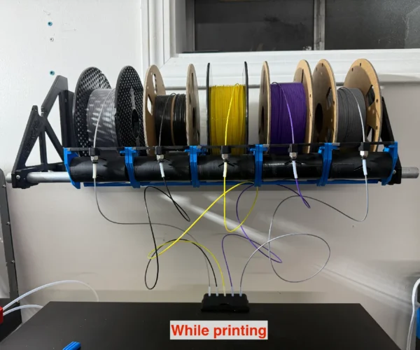

Yes, I can see how it could be an issue for left-handed users. What you can do though is replace that short PTFE tube on the side filament sensor with longer one and move the spool. I feed from above because there's little space between the CORE One and the printer next to it on the right. A lot of the CORE One design is great if you have only one of them. Having many side by side, and the left and right pockets become unusable. When you move it you need to look for a new spool holder solution, of course. I feed my C1 and the Mk4S that has an MMU3 from a RepRack using these rollers: https://www.printables.com/model/1134716 but based on your circumstances YMMV.

Can you post some pictures of your setup if your willing share?
Would be delighted but I just left home this week for a few weeks in the south, to escape the New England winter. Let me check my photo library to see if I happen to have anything that might be useful
Postato : 06/03/2025 12:20 pm
RE: Left-handed user experiences.
I didn't find a photo of the C1 setup but here's one of the RepRack feeding the MK4S/MMU3:
With the C1 added to my collection, I moved this Mk4S/MMU3 enclosure a bit over and put the C1 next to it on the left, added another spool holder to the rack, and run a teflon tube down from the spool holder to the C1's right side. I could have just removed the short PTFE tube and plugged in the long one coming from the RepRack but instead I use one of those wonderful twist lock connectors: https://www.printables.com/model/873440  One end goes into the short tube from the filament sensor, the other one in the long tube from the rack, so I can easily disconnect the tube. Okay, now that I think about it, it isn't really that useful and makes much more sense on the Mk4S, where I use the connector to rapidly switch between a tube coming from the MMU3 and one bypassing it. I guess it's still useful in that it prevents the inevitable wear and tear on the tube from repeated removal and re-insertion. I have pretty much the same setup on my XL.
Postato : 06/03/2025 12:37 pm

Ok, so if I understand correctly your still entering the printer thru the side, just mounting the spool above and extending the ptfe tube to it.
Postato : 06/03/2025 1:42 pm
That's right. Seemed simplest. No need to futz with the side sensor location.
