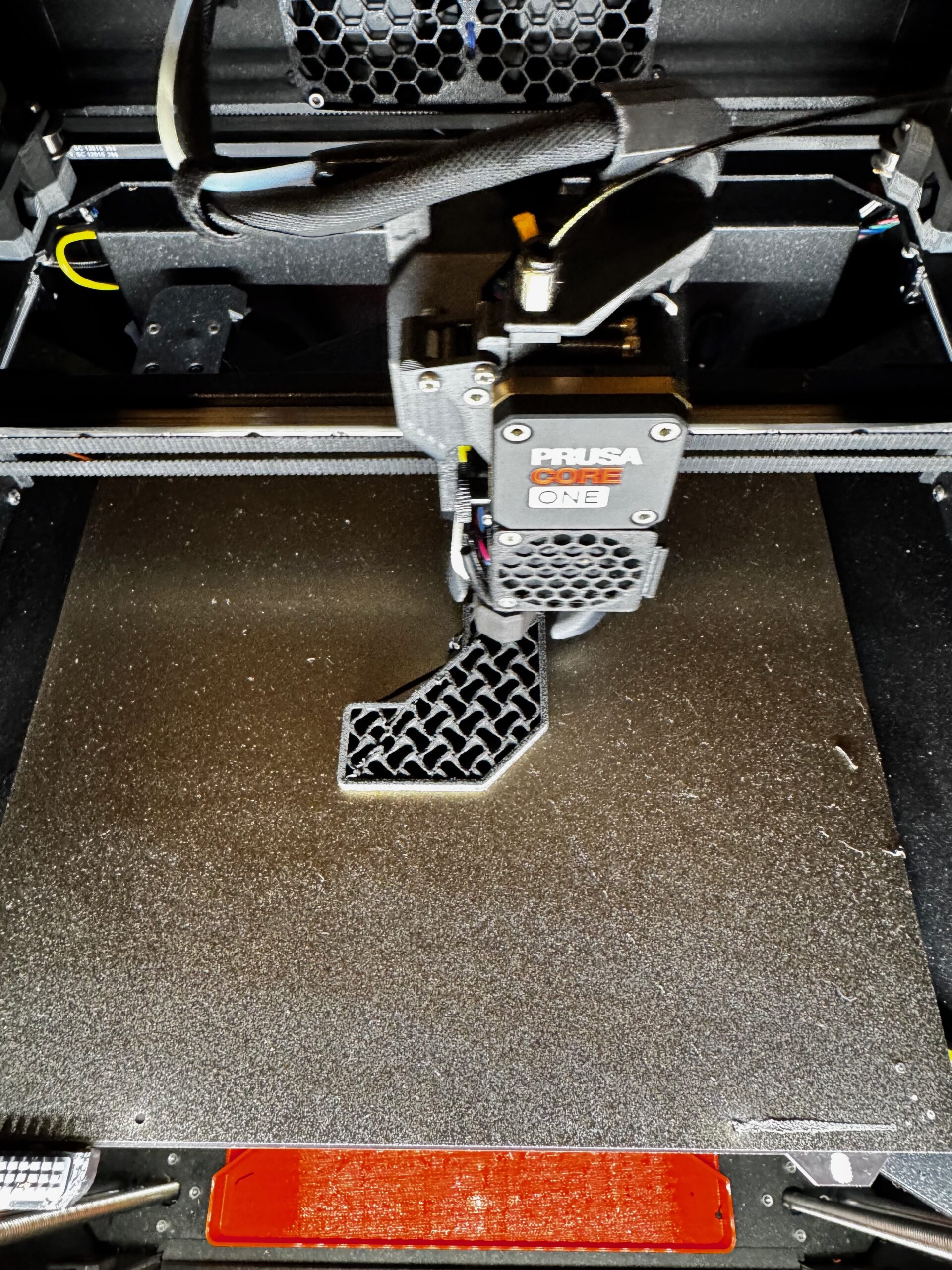

Posted by: @ssill2
how does that look from the front when it's in operation and loaded?
As in the photo I just hang the Bowden off to the side. I was thinking about a spool roller that fits on top similar to the one on the MK4 but this is actually easier (in my opinion). This is with both the bogie and filament sensor mods.
