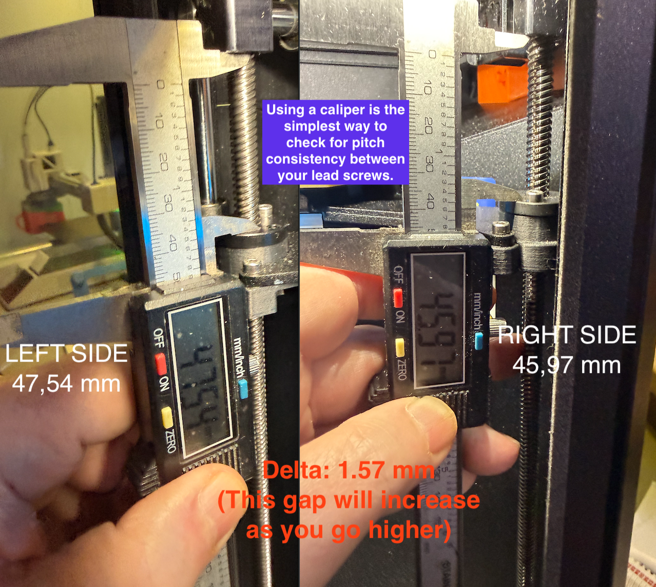

Instructions:
Calibrate Z.
Use the display to raise Z to around 50-60 mm and take your measurements.
(See image)
This post was modified 4 months ago by Albert Lozano

Instructions:
Calibrate Z.
The comment in the image, "gap will increase as you go higher", is important. There may also be a fixed left vs. right difference due to tolerances in the frame and chassis. To separate it from the effect of unmatched thread pitch, I would do this measurement twice, at two different heights of the bed, say 10 mm and 110 mm below the nozzle. Then the change in the left vs. right discrepancy over 100 mm travel can be determined.

Albert Lozano
(@albert-lozano)
RE: Different Z lead screw travel between MK4S upgrade screws and Core One kit — 2 mm mismatch
Posted by: @gb160
That approach is good for the front 2, but not any good for the rear leadscrew.
In that case the best is a digital clinometer
Posted : 26/02/2026 11:44 pm

mnentwig
(@mnentwig)
Frankly, I don't see why anybody would want to use an inclinometer. It needs to be absurdly precise to show small errors, e.g. better than o.o5 degrees for 200 µm offset over the spindle spacing (that is, pi/180*atan2(0.02, 300)). Having two digits after the decimal point is still a long way from being accurate ... The only advantage I can think of, it doesn't distract the user with needless worry about "small" errors that may be "totally negligible - really", still clash inconveniently with marketing language. Do your own math 🙂
To confirm the relative alignment between the three screws,
- home and move the print bed up to Z=0
- move the print head near each of the spindles and turn it manually (against the resistance of the Z motors) until the print bed is perfectly parallel, relative to the head plane. A playing- or business card serves as ad-hoc feeler gauge between print bed and nozzle to set consistent distance at all three spindles, within +/- 0.5 motor step if working accurately.
- run the print bed down near (but not touching) the bottom and use a suitable object e.g. a capped bottle to confirm that the distance is still consistent near all three spindles.
Posted : 27/02/2026 9:41 am

mnentwig
(@mnentwig)
You're overthinking it mate.
I respectfully disagree:
My hardware-store (0.05 degree display resolution) instrument horizontally on the print bed gives the following readings,  when I turn one of the spindles:
StepCount / angle reading
0 / 0
1 / 0.05
2 / 0.1
3/ 0.1
4 / 0.1
5 / 0.15
6 / 0.2
7 / 0.2
8 / 0.2
9 / 0.25
10 / 0.25
So it's a fairly crude measurement: One step is about 140 µm, which doesn't seem insignificant for an error that shouldn't be there in the first place (baseline print bed calibration is much more accurate than this, otherwise the first layer would never stick). But maybe I'm overthinking this 🙂

Yasar
(@yasar)
I did it by homing and moving the X-carriage (from menu) (nozzle on the left and back center) and rotating the spindle so that the nozzle touches, and then everything is level... there's nothing you can do, one driver is causing problems, we need 3 drivers, then move all 3 spindles and hom... then you'll have everything level.
