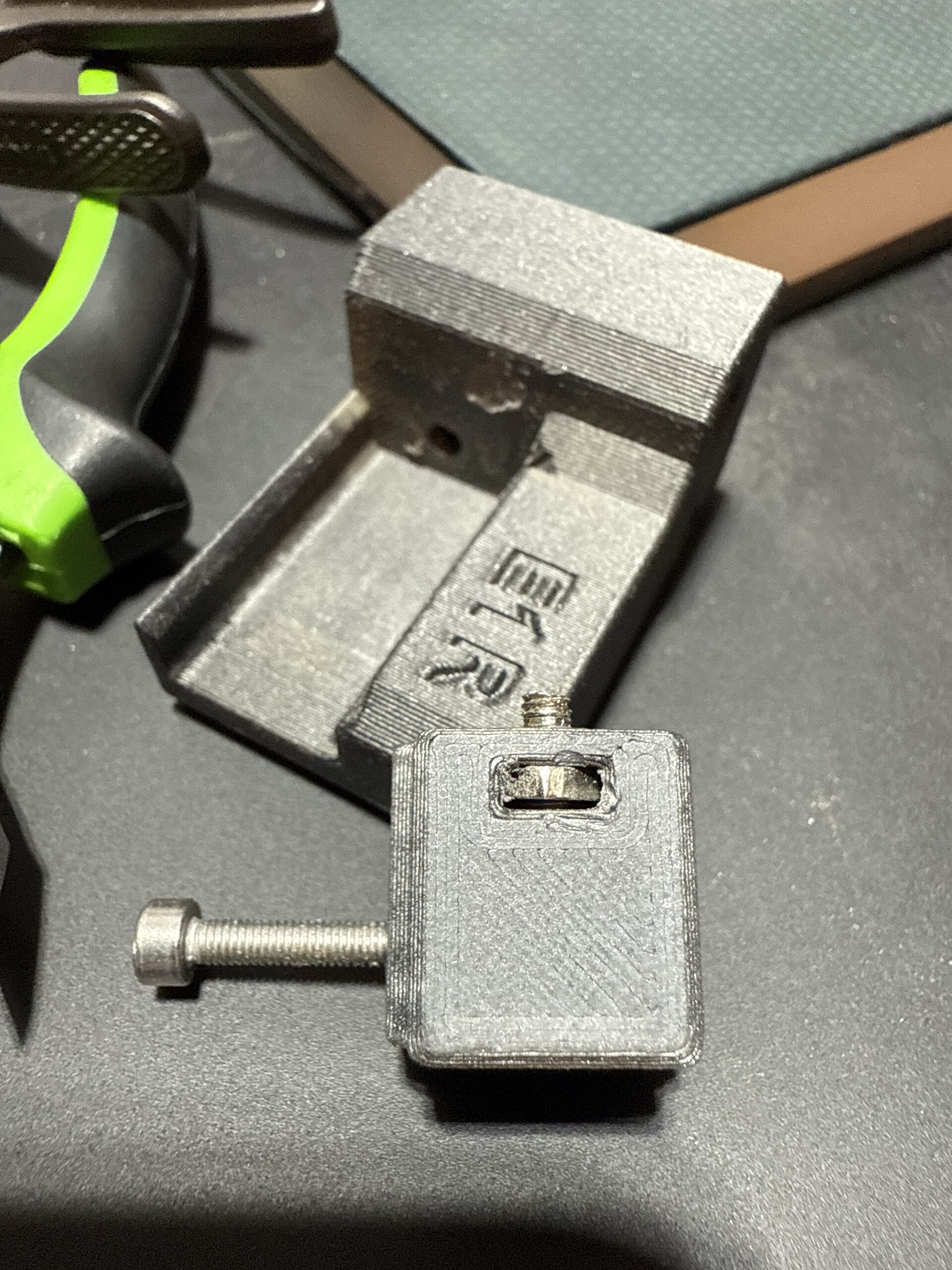

Hi guys,
I am still trying to get past the Y calibration phase of my printer. Trying to discuss this with support as well. Last week one of the belt tensioning screws ( or the nut, who knows) stripped after some time adjusting the belts. I thought to myself: Yeah whatever my fault. I thought there wasn't too much tension on the belt to strip out a nut but whatever. Ordered replacement parts, waited for them to come. Today I've installed them and what do you know? Both left and right tension block stripped out their respective thread, both while loosening! And don't get me wrong guys, this happened with a relatively loose belt (under 80 Hz) The screw strips right in the middle of the thread, so its impossible to remove the pulley block from it.
My theory is, that the end of the screw starts to grind of a little bit of the PC-CF. If you mess around with the screw, tightening and loosening it, you end up getting some of the carbon fibre in the thread which leads to it stripping out. In my case that happened during inital build, but I guess thats also to be expected after some usage time.
Really disappointed with this. Anybody else have that problem?
My personal broken Pulley-Block-Count is now up to 3.

https://forum.prusa3d.com/forum/prusa-core-one-assembly-and-first-prints-troubleshooting/tension-pulley-broken/ suggests that it is not the thread but the nut turning in the part (which would fit as well, CF blocks the thread and both parts move together). There is quite some play in that Pulley part, so that might be.
I didn't add any pictures, because from the outside it looks just fine. Imagine your tensioning block - but when turning the tensioning screw the block doesnt advance in either direction, it just stays in place.

The nut on the turns inside the tighter the end result was I had to cut the screw to remove the part to get this picture.
I rebuiltthe part using new screw and nut secured with JB Weld. It works untili order a replacement and will modify nw part to keep from repeating.
What a mess

I've noticed, that the reprinted parts on my own machine had a much tighter fit for the nut than the ones I've received. @Prusa did you maybe just send out a bad batch? I've contacted support about it, they suggested they hadnt heard of the issue yet. But the parts I've received were physically way more loose than the new ones. Loose as in: I could drop the nut in and it fell into the slot without me pushing. I've bought 3 replacement parts with that problem until I fixed the problem once and for all printing my own.

About the nuts stripping/turning
For anyone running into the same problem: Either: Order some PCCF and print your own tensioners, which have a tighter tolerance than (i guess just some) Prusa Parts. Who knows why, but i had them side by side.
OR: Add a drop of glue in there together with the nut. Be careful not to get any glue in the threads.
This part was the source and solution of the issue for me. Unfortunately I had to carry all the costs by myself, support was really not good and quite condescending. In the end I was promised replacement parts which i never received. Also: What would i do with replacement tensioners now? At least refund me my spool of PCCF. Definitely put a bumper on my prusa experience.
Hope this issue does never come up again for anyone else!
